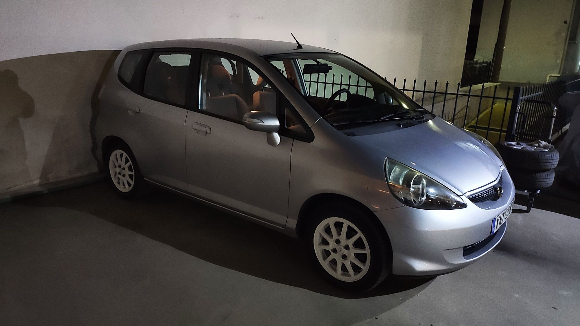

Finished product
It is done...
Also the new wheel with tyre is 12,9 kg. I saved 700 grams per wheel compared with the 14" i had before.
