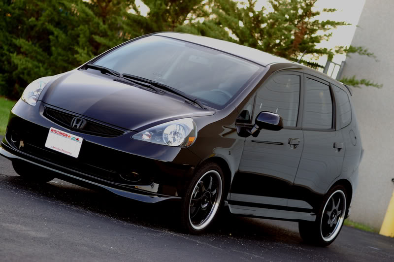

I think if your looking to fill the wheel wheel more you should do it with more wheel than tire so I would go with some 17x7 with no less than a 40 offset. If you don't plan on dropping you shouldn't have any issues rubbing with that. I had 17x7 with a 42 offset and would only rub with probably about 900lb+ in the car and that is only if I hit a bump or divot too fast.
Here is my motegi ff7's that are a 17x7 with a 42mm offset had a 205/40/17 tire on there and like i said would only rub when had lots of weight in the car and hit a divot or bump to hard. As of right now i plan on selling them because I want to drop the car now and it isn't going to be possible on these because of the offset.
