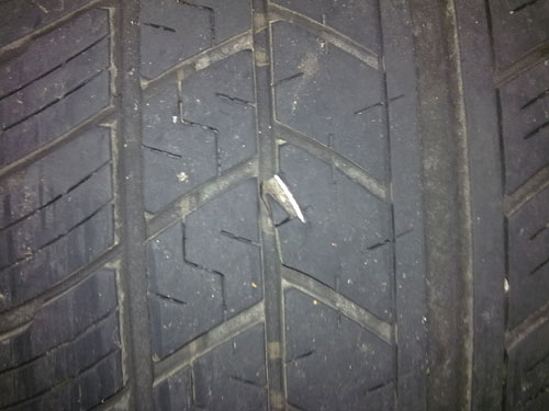

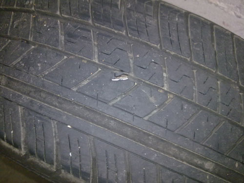

It's some kind of blade.
It's not a slow leak after all. I checked the tire after having it parked for 2 hours, and it was flat. Good thing I happen to have a full size spare with me (for my road trip), so I just changed it out and went on my way, best money I ever spent.
I can't even figure out how it got in there, but it appears to be some kind of blade, not a nail. I'm running the full size spare so I'm good for now, but the TPMS warning light is on, and I would like to put the old one back so TPMS would work properly. Pictures below, anyone know if this is repairable? Dealer or tire repair shop? I'm gonna call the dealer tomorrow and see what they say.

assuming you didn't damage the side wall from driving with it low, I don't see it being a problem to repair.

DO NOT, I repeat DO NOT put fix-a-flat or any slime in this tire. You have air sensors and you will make a costly mistake. Looking at the object it is hard to say, have them take it off the rim and if the puncture is less than 1/4" dia then it is repairable to RMA (rubber manufacturer association) standards. I do not know any facilities in New York or I would recommend one for you......

Just replace it. Safer

I just dropped the wheel off at my friend's place, he's going to take it to a tire repair shop on Wed and have it looked at (I don't have time). The dealer is a no go since they said they don't patch, just plug (and the guy was like "yea, I guess" when I asked) so I figure they would just look at it and tell me I need a new tire without really inspecting it.
I'm still wondering if I should get it replaced. I have an extra set of stock rims with tires, and I already have one on now (the full size spare), so technically I don't really need to get it fixed. I still have three un-used good ones (more full size spares) in the garage.

If you have three more then just scrap the tire.....
