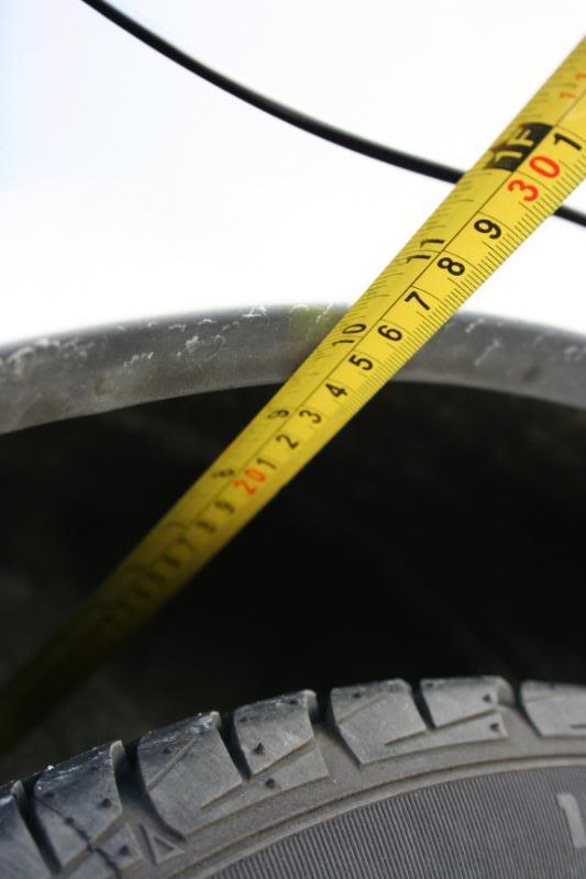

Only the back.

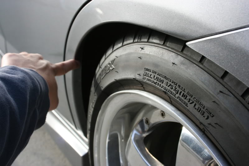

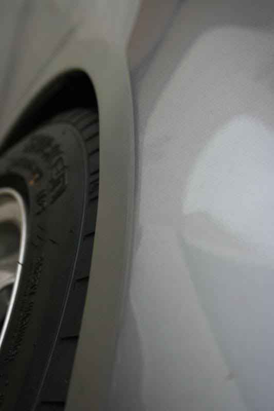

You can see from just rolling the fender lip how much extra space is created.

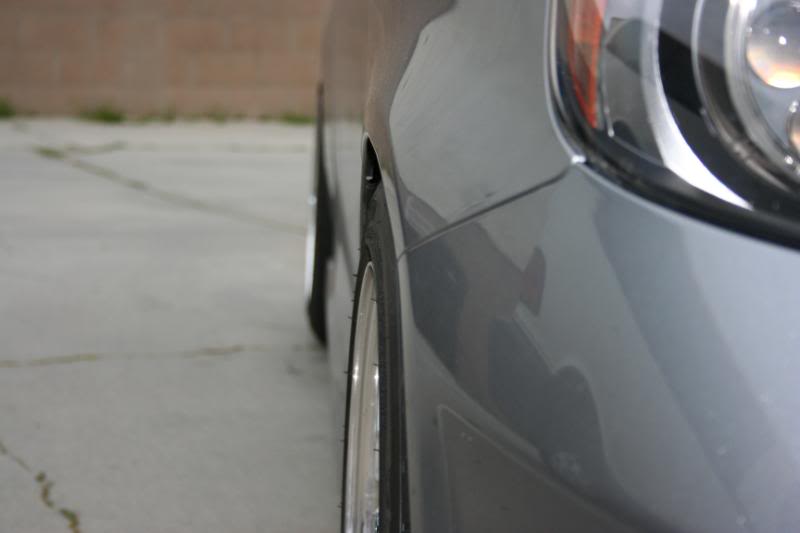

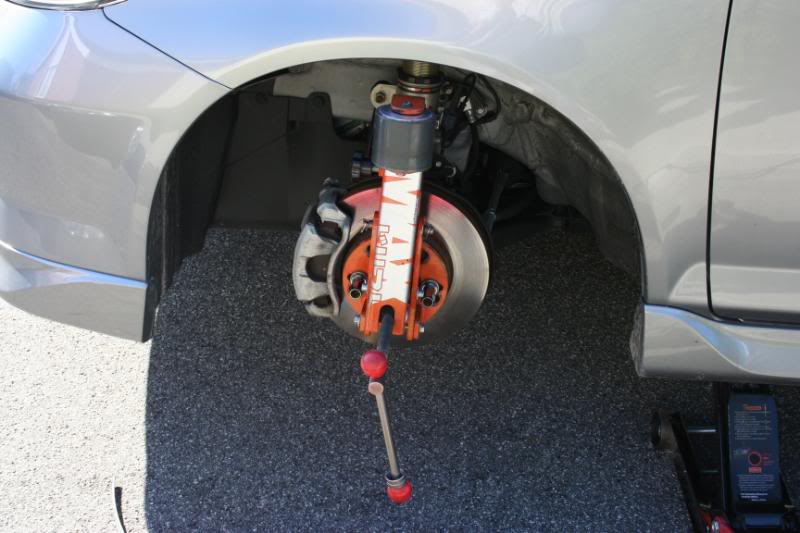

Front fender rolled.

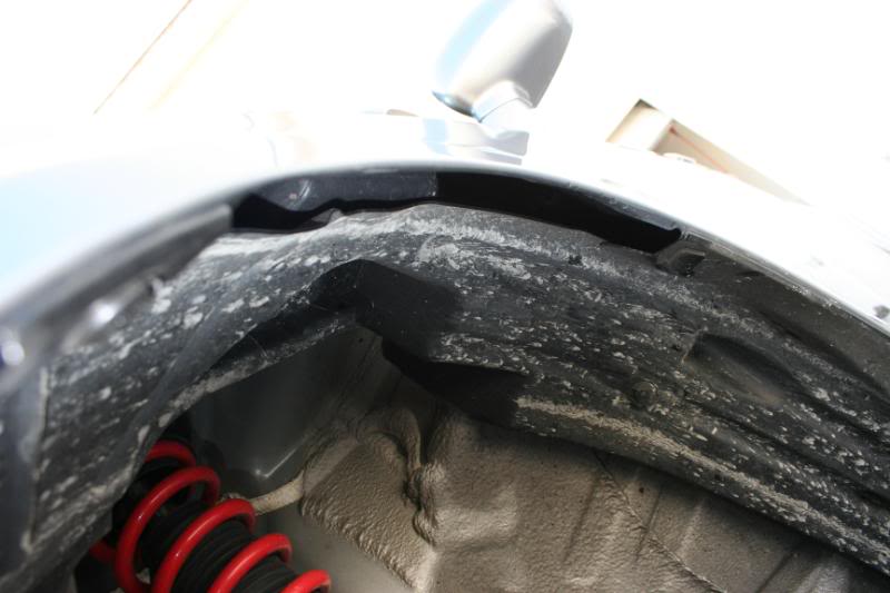

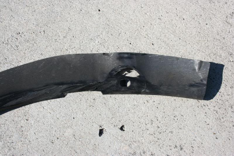

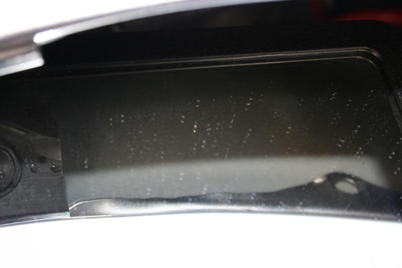

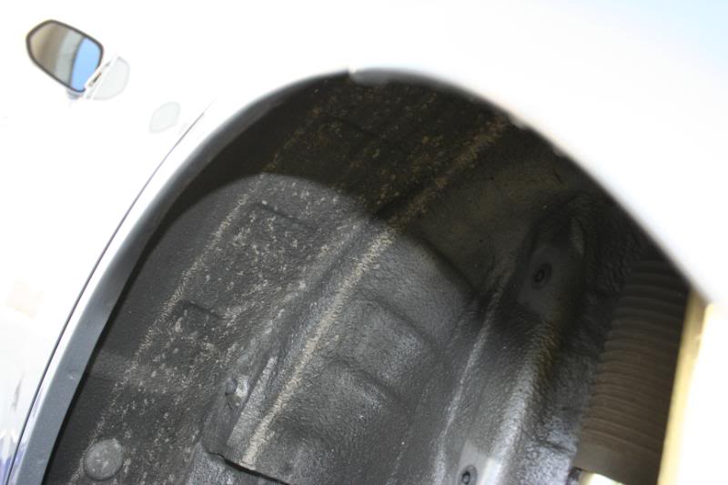

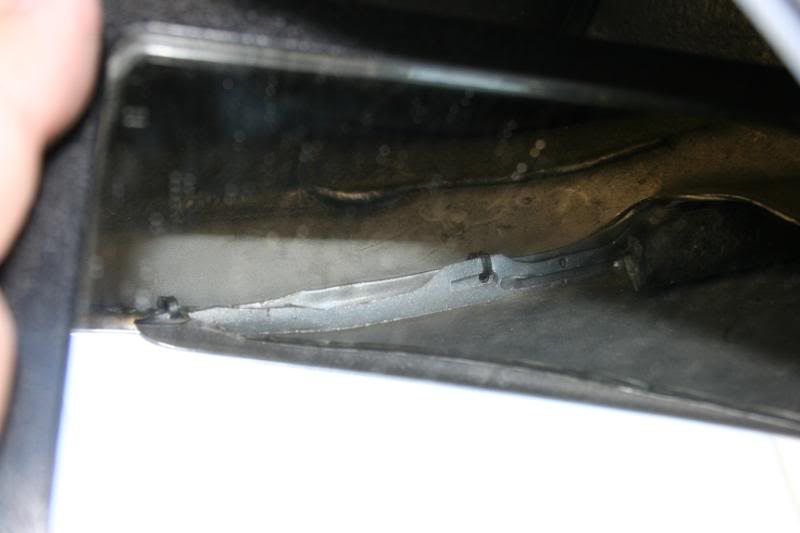

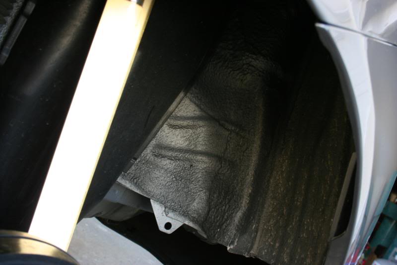

Top of the fender lining cut out.

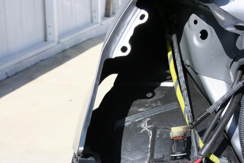

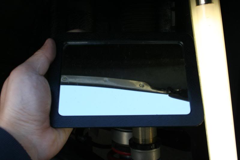

Shot of the fender lining w. headlight removed.
As you can see I had been rubbing from the piece of the fender lining that was removed.

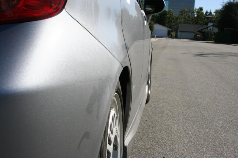

Rear rolled.

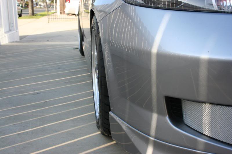

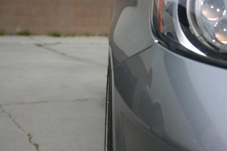

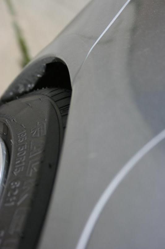

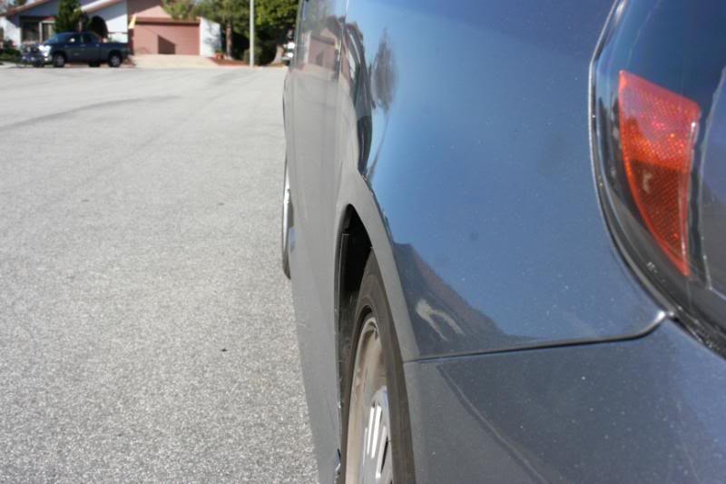

Front fender after rolling and pulling.
Rear fender after rolling and pulling.

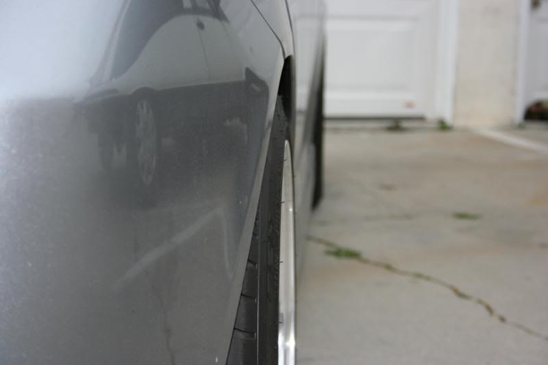

Shots of how the 26 offset wheels sit.
