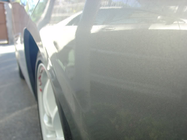

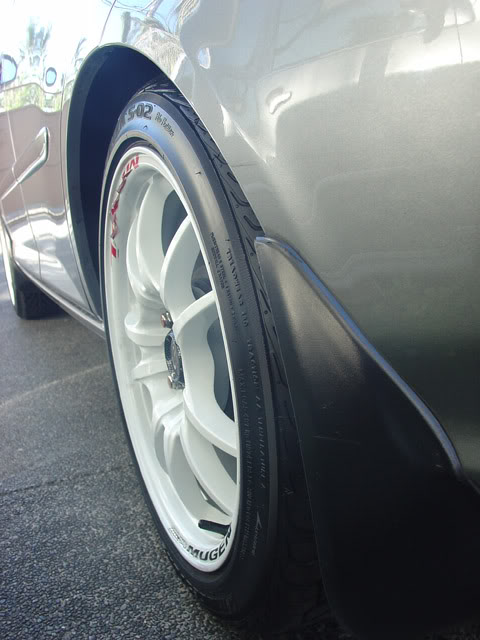

Old Mar 18, 2010 | 08:55 AM
Type 100's Avatar
Posts: 1,888
Most of the rubbing happens at the rear fender area.
I'm on stock springs and ride height, but where I live, I tend to park on a ramp with the nose facing downward. This way, I can show you the fitment of the wheel under a compressed spring - think of it as fitment with a lowered car such as your GD Fit on TEIN S.Techs.
Here's how a 16x7 +45 offset wheel will fit, shod with 205/45 Bridgestone Potenza S-02 Pole Positions.
From a slightly different angle:
You'll see the wheel + tire is nicely tucked in. There's still a lot of clearance from the fender. Even if you lower the car further, there won't be any interference (rubbing).
