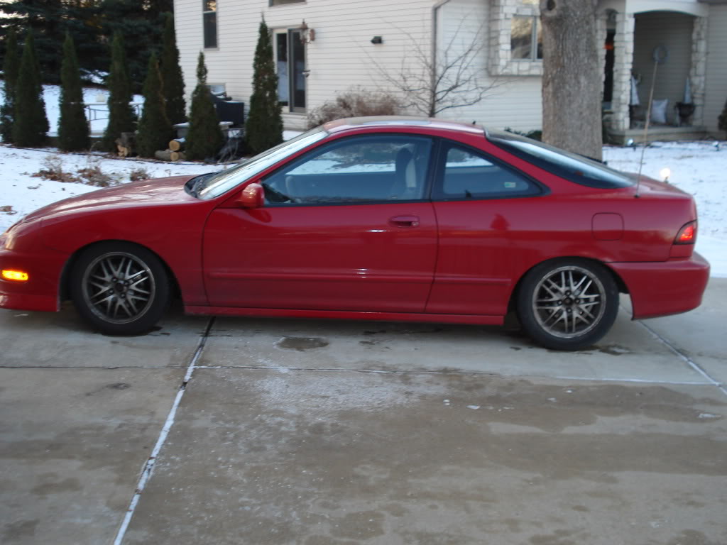

15x8 will be too wide and you'll be stretching a 195/205 on to it
You'll be fine in chicago.
My Integra and I'm from WI which has equally bad roads:
