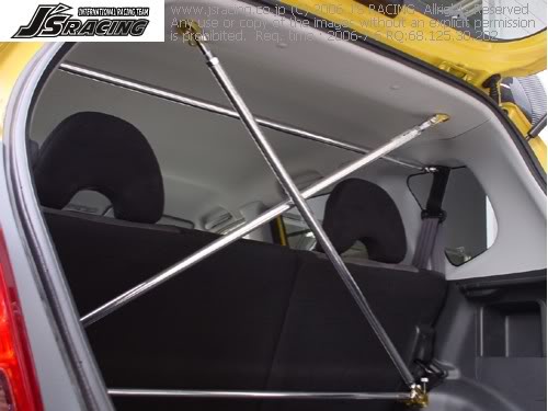

Thanks for the heads-up, would sure hate to waste $120+ on a bar that wouldnt fit. But i was curious to know. I stumbled upon the J's cross bar and do you happen to know if this will fit our Fit? I cant remember seeing anywhere they would mount to the roof on our model. Here it is

Old Jan 11, 2009 | 03:41 AM
kylerwho's Avatar
spoon fed
Posts: 5,233
From: Seabattle, Washington
i have wondered that myself. it looks like you need to tap custom holes into the ceiling of the fit it doesnt utilize those bolts with the plugs over them in the center of the bars.
Old Jan 11, 2009 | 03:47 AM
Nighthawk_GD3's Avatar
Posts: 213
From: Fairfield, CA
These damn cross bars just look like they add horsepower nevermind if they help anything they are sexy . I emailed Bulletproofauto but like a lot of dealers, thats all they are. Eh, maybe someday we will be enlightened on how these bolt up or if they really are for only the non USDM fit

try contact ben or jay at aj racing. they do the actual research to see if these parts work with our fits. those cross bars would work if you drove hard enough.

Oh i can for sure see the cross bars working a lot better than the trunk cage. I was looking in my trunk and saw where the "trunk cage" would bolt to and i really dont see how it would help, if any gains in handeling, it would be minimal and not worth the $350.

the trunk cage wont brace anything. its purely for looks. ultra brace c-pillar bar, j's rear strut bar, and progress sway bar are what i have and i think the rear of the fit is braced enough for everyday use.
