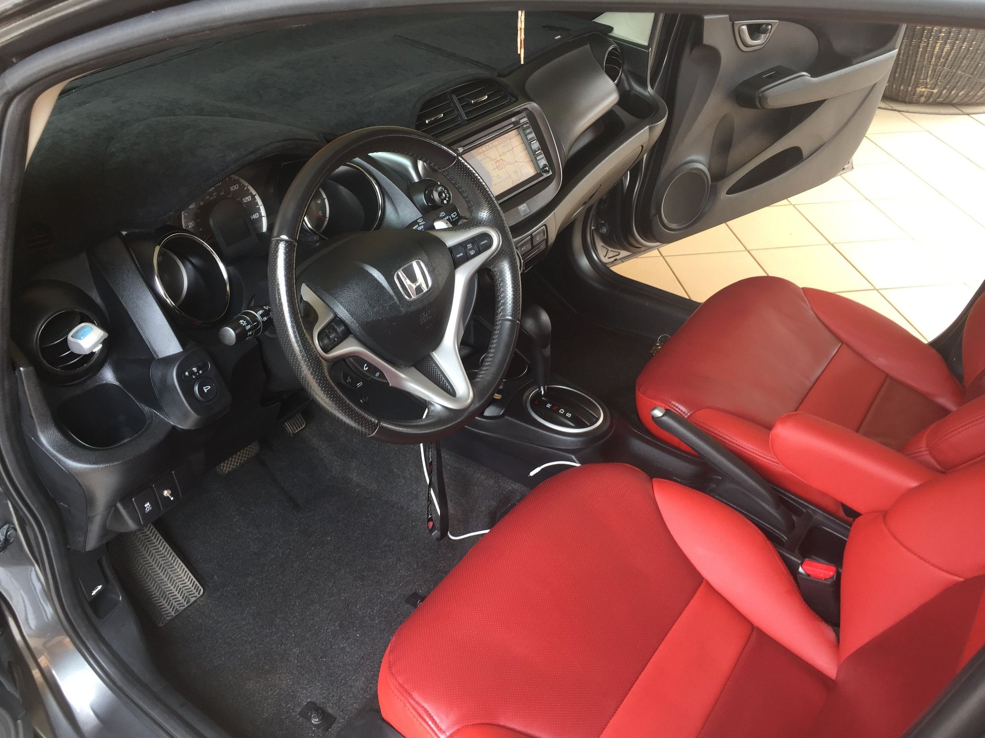

*Btw, your red seats look great! Are they original?

Thanks for the compliments. No seats aren't factory. Had them done. Also installing a Pico projector so I can watch my movies on the go.
