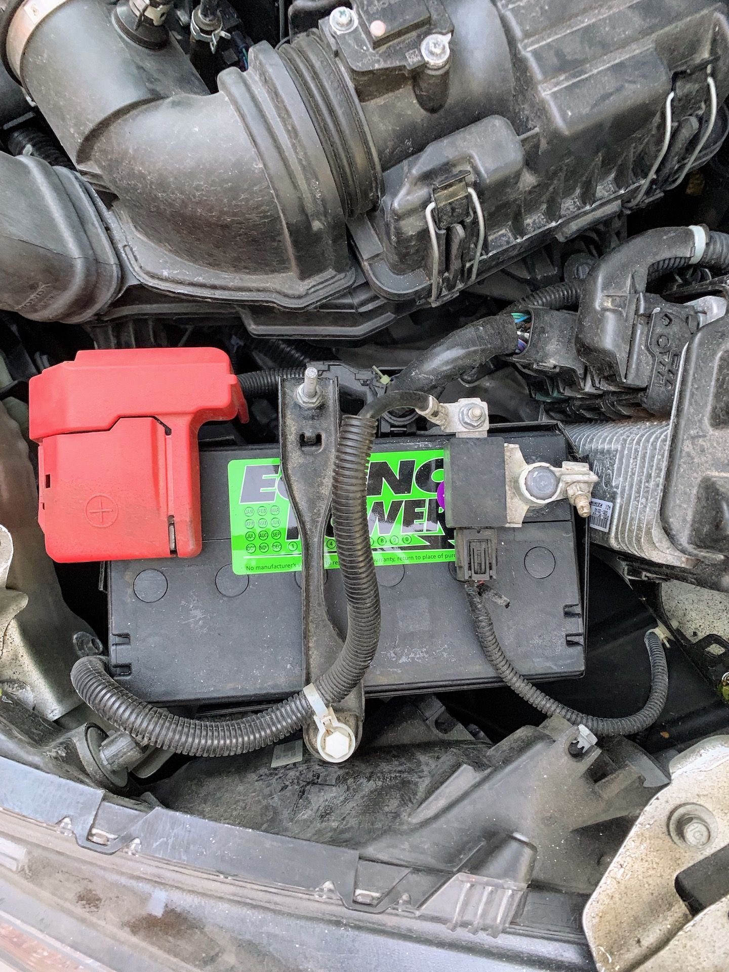

I needed to replace my 2015 EX's original battery and went with a 51R based on what I found in this thread.
Using a Honda VIN decoder, it told me my Fit was produced by Mexico Honda Passenger Cars. It had the short tray, as seen below.
Hoping these pics and info can help someone out. Thanks everyone!
151R (Left) 51R (Right)
151R (Top) 51R (Bottom)
Snippety-Snip
Made it easy and just cut off the right side.
Trimmed
51R sitting in the newly-cut tray
No battery tray
Battery tray re-installed
Done!

I wouldn't have cut the tray like that. I think it would have been better just to cut the raised edge (only!) around the circumference of the tray as necessary and leave the bottom of the tray completely intact to provide maximum support for the larger battery.
Old Aug 2, 2019 | 12:24 AM
  #55
Ivonesh's Avatar
Joined: Sep 2017
Posts: 14
From: Aurora, IL
I could have, but I'm comfortable with the amount of tray that remains and the fitment is still solid.
