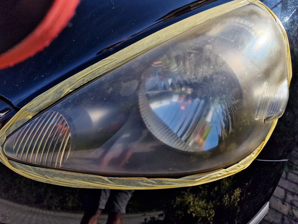

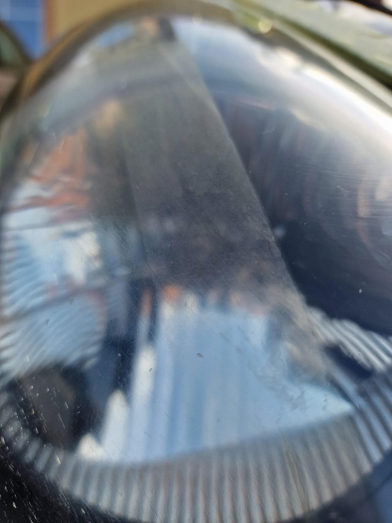

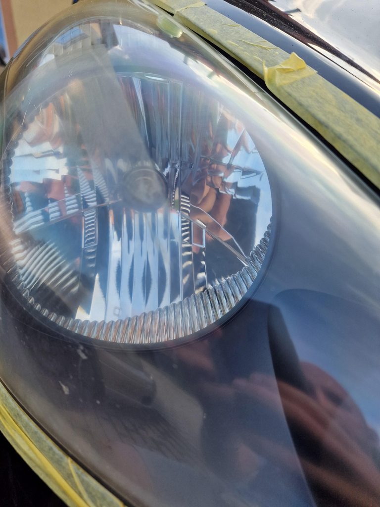

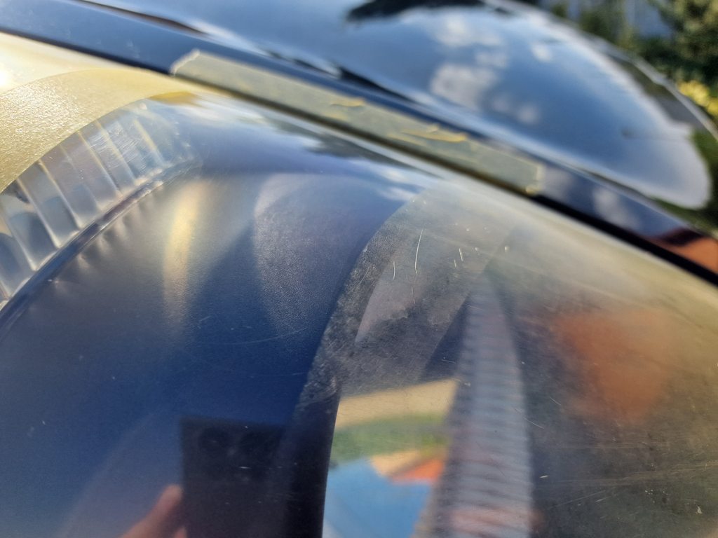

Well since this 3 year old thread got bumped I got a notification, might as well update it, because I did the headlights eventually:
Originally Posted by mobby_6kl
Also did the headlights. People generally suggest like 5 grades of sandpaper, then compounding and polishing with fancy stuff, but... some polishing paste on a kitchen sponge works perfectly fine for a 20 year old beater.
I did a test on an area that wouldn't impact the light output if I messed up
But it turned out pretty well. There's still some weird cracks and crap that seems to be on the inside but
Step 1: Compound with a literal dish sponge on a drill.
Step 2: There is no step 2.
Well it should probably be to apply some protective coating but I had none on hand. But since it takes literally just 5 minutes, I'll gladly do this again as needed.
