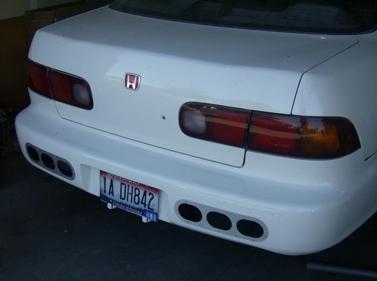

Many people do cut out their rear bumpers to reduce aero drag
Can you post just one picture of that?
Here's a pic of an Integra where the rear bumper has been cut out and then most people put meshed plates over top to make the car look less ghetto and more race.
