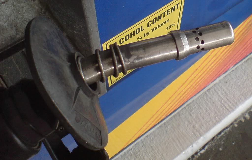

if you could see the holes are to recover "vapor" (not a liquid or solid) so we are not wasting gas by putting them in other places except into our cars. it just doesn't make any sense. as the tank sits there, there has to be a funnel that connects the tank and the gas door. i find it hard to believe there are gaps or holes in the funnel that would allow the gas coming out. its common sense in my eyes.
Like I say in the message, some states already mandated gas station vapor recovery systems before the Feds acted. In South Florida, stations within the EPA "bad" air zone were required to fit these systems if they sold more than a specificed amount of gas. The FL law occurred in the early-mid 1990's. The new mandate for onboard vapor recovery systems occurred since 2000. You can still find stations without the nozzle vapor holes or accordian rubber sleeve, especially in rural areas. If gas stations have a vapor recovery system in place, they will not disable it since it saves them money in the long run by recovering fuel. I am a senior design engineer who has worked in the auto industry and I know what I am talking about.
Mister senior engineer, you appear to be confusing two different fuel vapor recovery systems and two different sets of legislation. Cars have had fuel vapor recovery systems for a long, long time, since (I believe) sometime in the 70's. Gas station vapor recovery systems are more recent.
You are correct in 50 States since 1969, however the capacity of the old vapor recovery systems was only a liter or two and only meant to capture vapors from thermal expansion after the tank was filled. My 1987 CRX had 1.5 L canister. The new systems are much larger (over 5 gallons in large vehilcles - size is proportional to fuel tank capacity) and therfore can swallow several gallons of liquid gasoline. The new systems are designed to absorb all the vapors while the fuel tank is being filled (nearly 11 gal of vapors possible with a Fit). Cars with the new systems also have seal inside the filler neck that seals against the nozzle. Older cars (back to 1975) just had a nozzle size restrictor to prevent accidental leaded gas filling and no seal.
