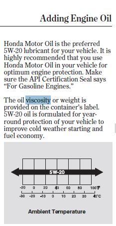

Originally Posted by pcs0snq
If that was all true (for our Fit's), why is it that it's not advised by Honda?
Its advertised to use 5w-20 (a general number meant for the entire USA to use safely).. people who wake up to -10 degree winters can probably benefit from a 0w (during the winter).. Such as January - February in maine

Dont forget owners manuals are also designed to compete with the amount of percieved maintenance vs other cars. Some car manuals also say to change at 10k mile intervals, those are just there to make the car appear easier to maintain (and are probably fine in general but long term effects are never completely documented.. ex: real world engine wear rates). Stick to 3-6k depending on driving style.. closer to 3k for dense city dwellers, 5-6k for those who put on mostly highway.
Chart clearly show -20F and below. Just wanted to know your basis for 2nd guessing the Honda recommendations...
Carry on.

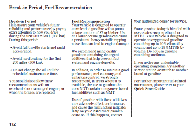

Anyways, back to the thread topic, break in, if anyone hasnt read the manual yet, honda also says to take it easy at first
There is ZERO data to suggest any Fit is better in anyway after the so called "break-in" some say exists.
Just wondering what your basis is for going against honda recomendations?
