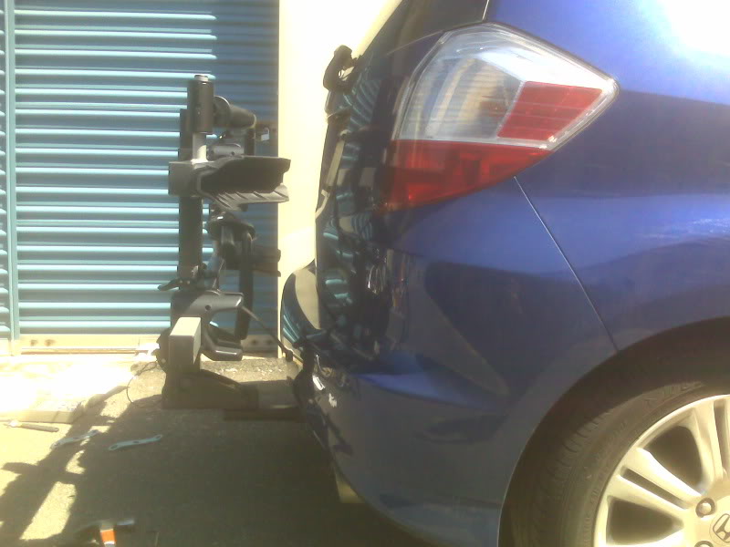

I just installed the T2 on 2009 Fit. Wanted to confirm for those that wanted to know that it fits perfectly. You can fold it up and there was also enough clearance to open the hatch with a 26" wheel bike on it when tilted down. This is with the drawtie hitch.
Thanks for posting back: I'm sure it will help people out. In the end I decided to go with the Saris Thelma (half the weight of the T2) because there have been several cases of frame damage from the T2 and the Holdup mounted on Civics, Fits and other light unibody cars: my local rack shop showed me pictures of damage that made me queasy.

First, it's 60 lbs. plus bikes, so that can be 130 lbs. according to spec. Second, the equivalent tongue weight is at least twice the weight of the rack+bikes. The cartoon version goes like this:
The factor that limits the tongue weight is the ability of the rear mounting point of the hitch to resist having the plate pull out from the hole. The ball has more than a factor of two leverage on that mounting point, so 200 lbs. of tongue weight (Class I limit) pulls with about 500 lbs. on those rear mounting points. Now, the rack puts a torque on the tongue... something that a trailer sitting on the ball cannot do (because it is a ball joint). As a result, the rack extends the tongue and magnifies whatever load is placed on it by a factor of roughly two (more if there are bikes moving the CG back, less if it is the rack only.) So... if you have 50 lbs of bikes on a T2, it can easily be equivalent to more than 200 lbs dead weight on the ball. Add to that shock loads from bouncing up and down over bumps, and you can have some pretty big impact loads on those rear mounting points: 500 lb. transients or more per side are definitely possible. If you installed the hitch, you know how thin the steel of those frame rails is, and the damage I saw pictures of was backing plates that had almost pulled out of those holes, which then damages the rails around the front mounting points, as well.
If you have light bikes and drive only smooth roads, I'd guess you will be OK, but one big bump could do serious damage, so I'd say be careful. BTW, the Yakima says Class II and above only, and it weighs the same as the Thule (but is slightly longer so leverage factor is even worse.)
