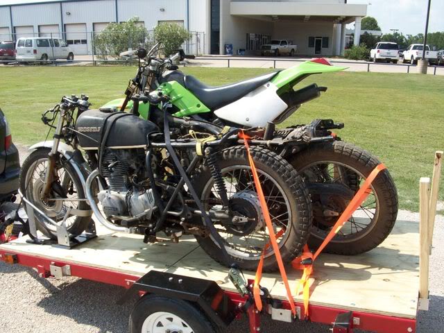

I purchased a Reese hitch for my 2009 Fit AT and have towed a few motorcycles and my dirtbikes all over the place. I'm using a small harbor freight trailer, and the bikes don't weigh more then 250lbs. So my total towing weight is around 400-500LBS. This is no different than a carload of people, or a really fat passenger. My highway mileage drops from 35-36 to around 30-32mpg while towing, but the Fit has no power issues while doing so.
I have towed up to probably about 1200lbs ONCE. It was a large refrigerator and a 6x10 heavy duty trailer. It was just in the city so I didn't go over 50mph. It towed fine, but I sure wouldn't do this on a regular basis, especially with an automatic.

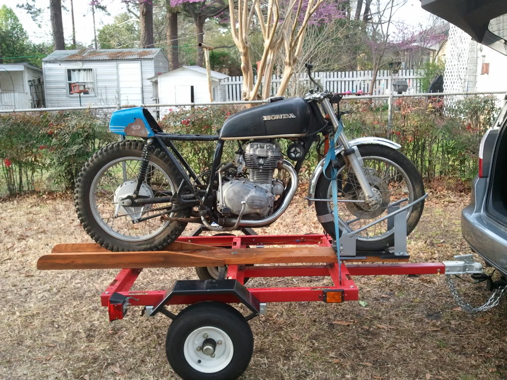

I don't have any pictures of the full setup, but here's the trailer, my project, and the back of my Fit.

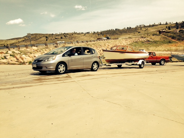

My 2008 Fit (standard manual) tows my homemade sailboat just fine. The boat and trailer weigh about 1000 lbs and I do not have trailer brakes. That is about the maximum the Honda Jazz is rated for without trailer brakes and seems pretty reasonable to me. Personally, I'd feel comfortable towing up 2000 lbs, IF the trailer had brakes.
The trick is to properly balance your trailer rig: keep the tongue weight down to around 5% like they do in Europe, not the 10 to 20%+ sometimes recommended in the US. Also, be safe. Drive slow and don't tailgate. Maintain your trailer bearings and tires. (All typical towing advice, regardless of size of towing vehicle).
The fit powers up and down a standard boat ramp just fine.
I imagine you MIGHT go through a clutch a little faster when towing, so try not to ride the clutch too much when accelerating from stop.

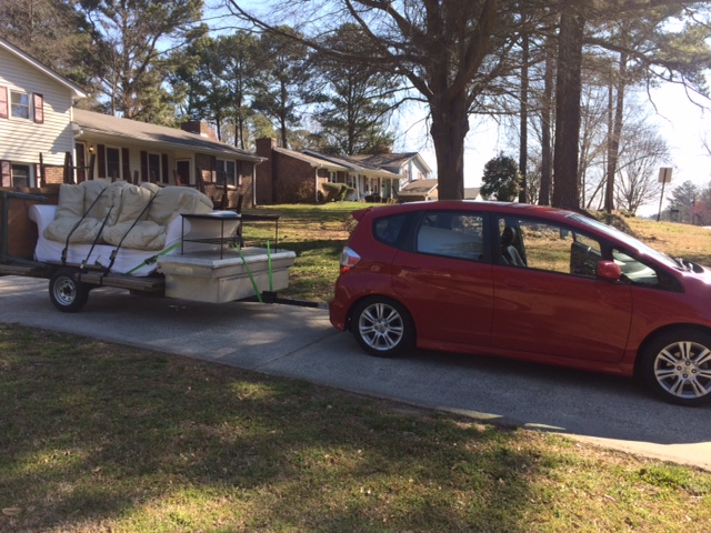

People grossly underestimate the Fit's towing capacity... I tow all the time, '09 MT w/ 68k miles. Stock clutch still going strong.

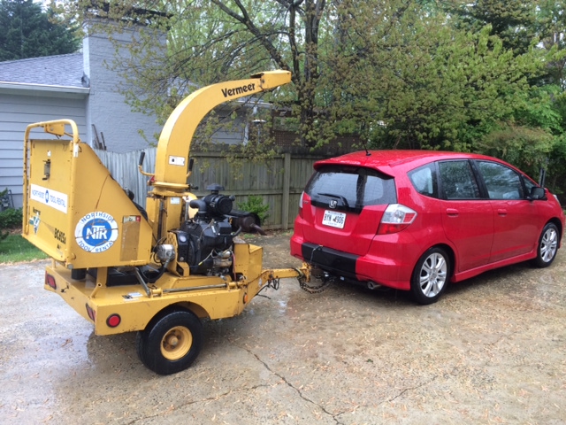

Here's a 1-ton wood chipper:
And a load of furniture:
I've also towed a 16' camper trailer (roughly 1500lbs, but the aerodynamics of a 8'x7'x16' brick), dirt bikes, motorcycles, or trash on the same trailer the furniture load is on, and a pop-up.
Keep the tongue weight low. You need to balance the trailer so that you can lift the tongue on and off manually. The only tow I did where it was heavier than that was the woodchipper, and braking was a bit squirrelly -- I had to keep it under 55mph.
Use common sense too, I left epic amounts of room to brake, and gear braked down hills. I monitor all temps and RPM with an ultragauge, they all stay within normal parameters.
