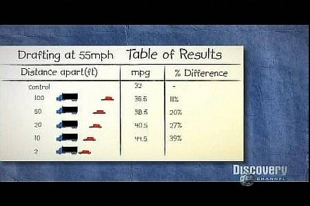

Bam!
Dangerous as hell, not worth it for a few extra MPG's especially since drafting a big truck or bus can result in them kicking a rock and cracking your windshield

Oh yeah, wasn't it a dodge magnum too? I was impressed with the mileage and kinda grumpy that my CRV at the time was maxing pout at 27/8

So if at 100 ft at 55mph saved 11% then if I'm going 80 and I'm 120 or so feet away that should save around 10% and it's a safe distance. Of course I extrapolated their data but it does seem like you can do both....be safe and save mph.

If you think you can react at 80mph and get stopped in 120 ft go right ahead. One less idiot on the road.

120 feet at 80 MPH is a one second following distance. That's not safe. (Some people may drive like that, but some people do all sorts of unsafe things.)

"Safe" following distance at 80mph is over 300ft for reference OP, just keep that in mind. I know 100 feet sounds like a lot but it's not at 80mph. I am mostly playing DA here.

Don't draft. Is your body or life, or your Fit, worth the few extra dollars you might save during a road trip?
Our Fits already achieve 35-40MPG highway so there's no need to tailgate a larger vehicle. Any gains are negligible compared to the probable detriment.
Read Waizzz' post about the MythBusters test:
Originally Posted by Waizzz
Bam!
If you're trying to save MPG on a road trip then just drive a little slower, be smooth on the throttle, and always use the correct gear. And remember the "2-second rule" about following distance.
