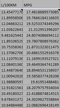

Here is my calculated mileage for my last 18 fillups:
These were calculated by doing the odometer difference and the fillup amount, so they should be pretty accurate, I think.
Even though this is almost entirely city driving, I still think something's up. I think most estimates of the city MPG for the 2007 Honda fit are around 27-33 MPG, while the absolute highest I've gotten is 24 MPG, with an average of about 20.

Wow, that's harsh. If there's something that far wrong with the car you'd probably know it without looking at the pump numbers. Do you have a lot of lights, construction or something like that in your area to leave your car idling a lot?

Not more than any other city, I think. I also should mention I pretty rarely use the AC.
What do you think I would notice if there was something wrong? Sometimes I feel like it doesn't have enough power, but then again, it's a Fit, so..
