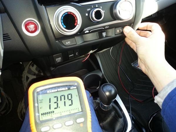

I manually added heated mirrors and led winkers from an EX-L CVT to my EX 6MT USDM. Mirrors activate with the rear defroster switch.
Each mirror is ~7.8 ohms resistance. In cold weather they ohm out around 5.9 ohms. In a parallel circuit both mirrors will draw about ~4 amps. As the grids heat up the resistance rises and thus the current goes down. That's why its imperative to connect the mirror circuit to the rear defroster relay that time limits the grids. While low current, too much heat can shorten the life of the grids.
driver side mirror
Heating grid connectors
You must peel back the wire loom and splice the wire into the thick GREEN wire. The purple wire is hot and runs back to the 30A fuse underneath the driver side kick panel.
With defrost switch on, the rear defroster relay energizes and completes the circuit to the rear grid, thus sending 12 volts to the red wire I tapped in with.
