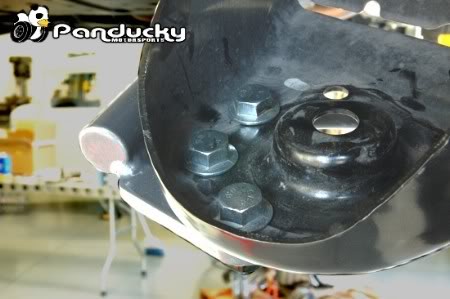

sway install
Could the knocking that I hear be caused by this? Is this the solution?
Taller bolts....

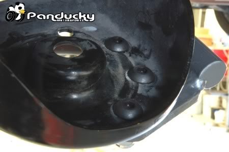

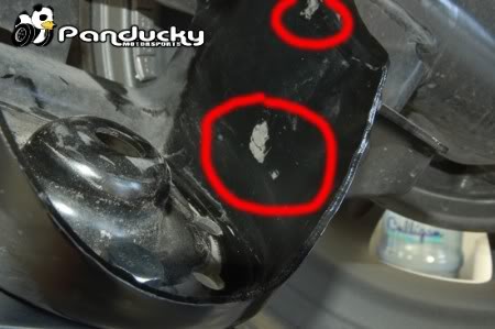

Result in spring scrape.

Solution with shorter tops of bolt? For more even spring setting.

If you have after-market springs, you may need the shallow head Panducky bolts. If your springs are stock, the bolts supplied with your bar are fine. Progress designed their RSB for stock Fits. There have been fitment issues with after-market springs, and different issues with different springs. The Progress RSB has no fitment problems with Progress lowering springs.
This is true. I have heard of some people having problems with Fitment with the RSB, and dropped on Skunks.
I personally have the Progress springs, and RSB and it fit up well together.
