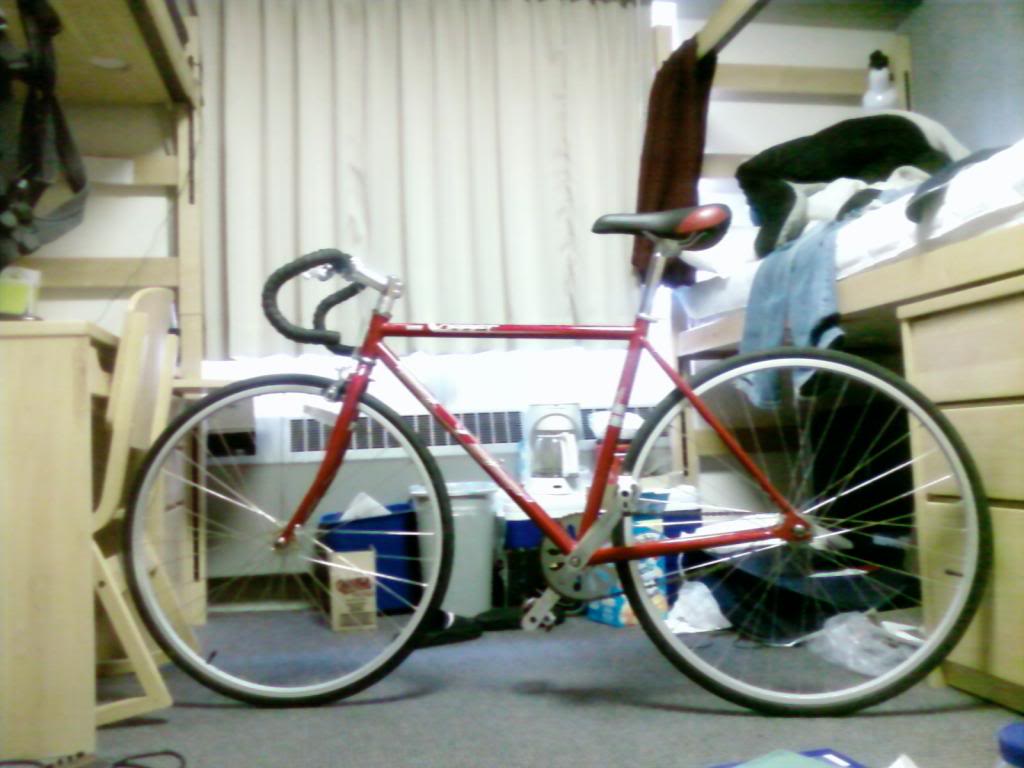

After about 2 weeks, I was unhappy with the pedestrian gear ratio of 42-16 that the bike came with, so I swapped out the rear cog with a 13-tooth cog and changed the chainring to a 52-tooth ring. I also flipped the stem upside down to give a more aggressive riding position. It's not visible here but you can see it in later photos.

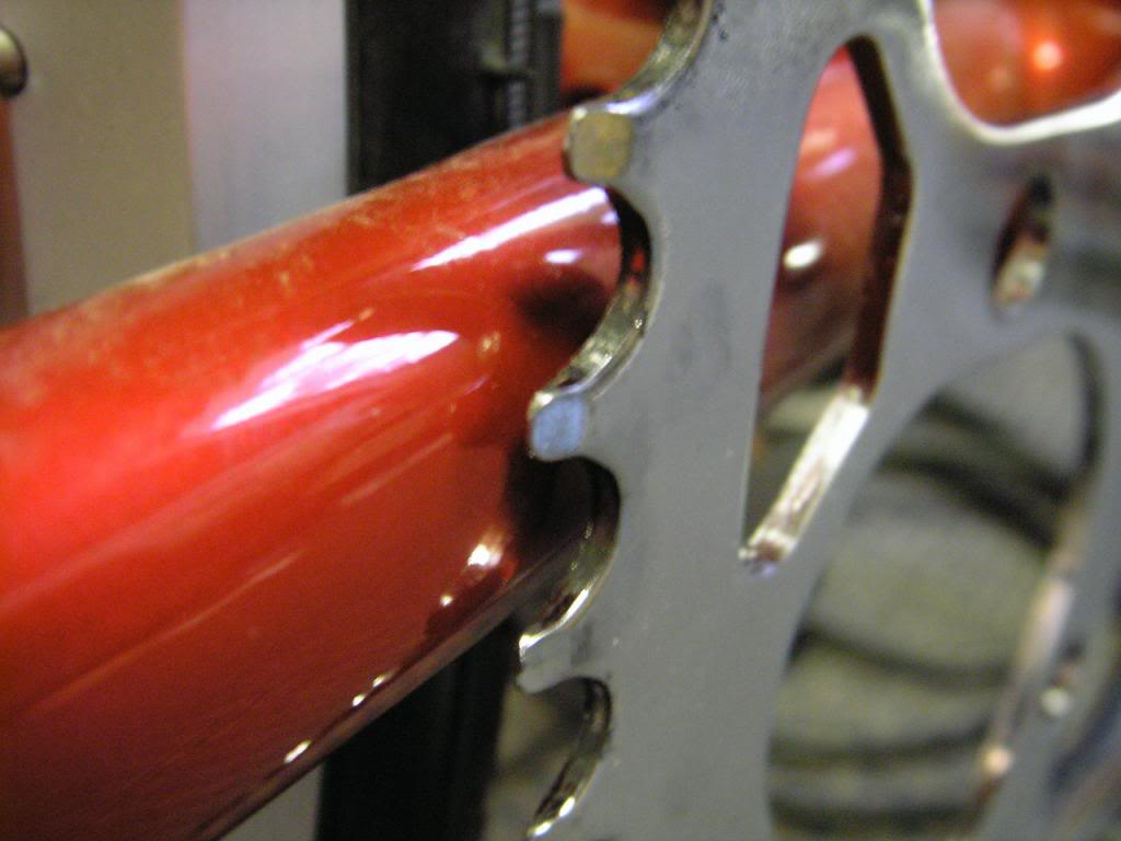

The 52-tooth chainring barely fit on the frame...

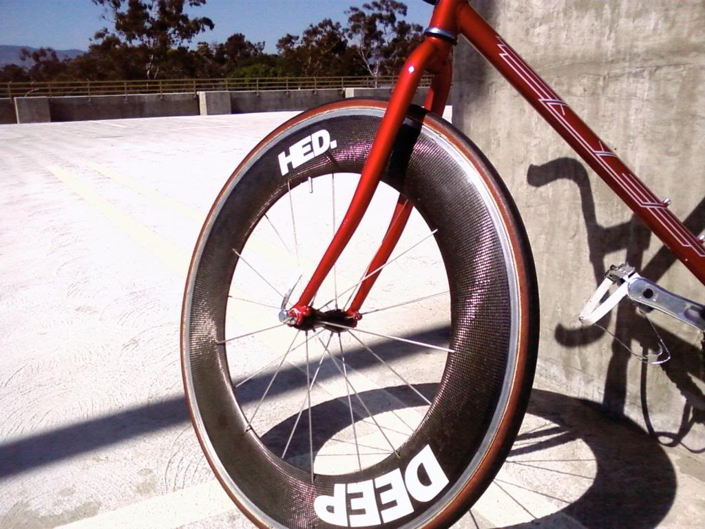

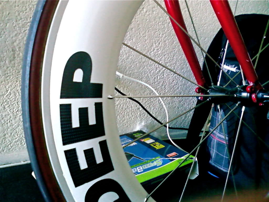

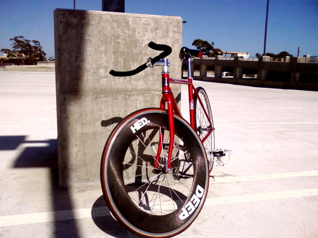

A few days ago I upgraded to an HED Deep carbon wheel in the front. It was slightly smaller than the wheels that came with it (it's 650c rather than 700c), so I had to remove the front brake. I installed some toe clips so I could skid stop. As you can see, I also did the ol' "Flop 'n Chop" on the handlebars, where I flipped them upside down and sawed off the curved part. You can also see the flipped handlebar stem.

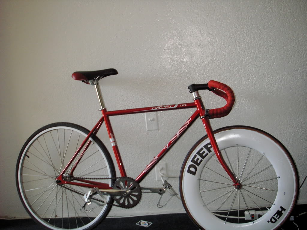

Updates in this picture:
- New drop handlebars
- New stem
- Painted HED wheel
The wheel painted really well, but it messed up a little when I put down the clear coat. The best way I can describe it is the paint wrinkled. I'm gonna go thru and sand out the wrinkles eventually, but I haven't yet.
