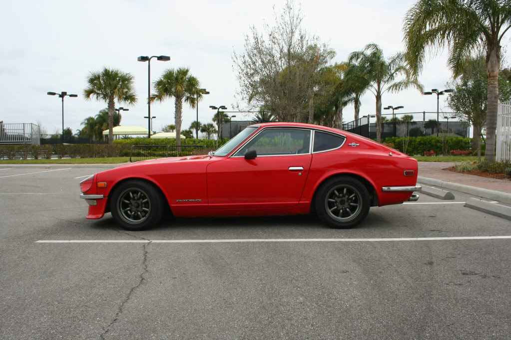

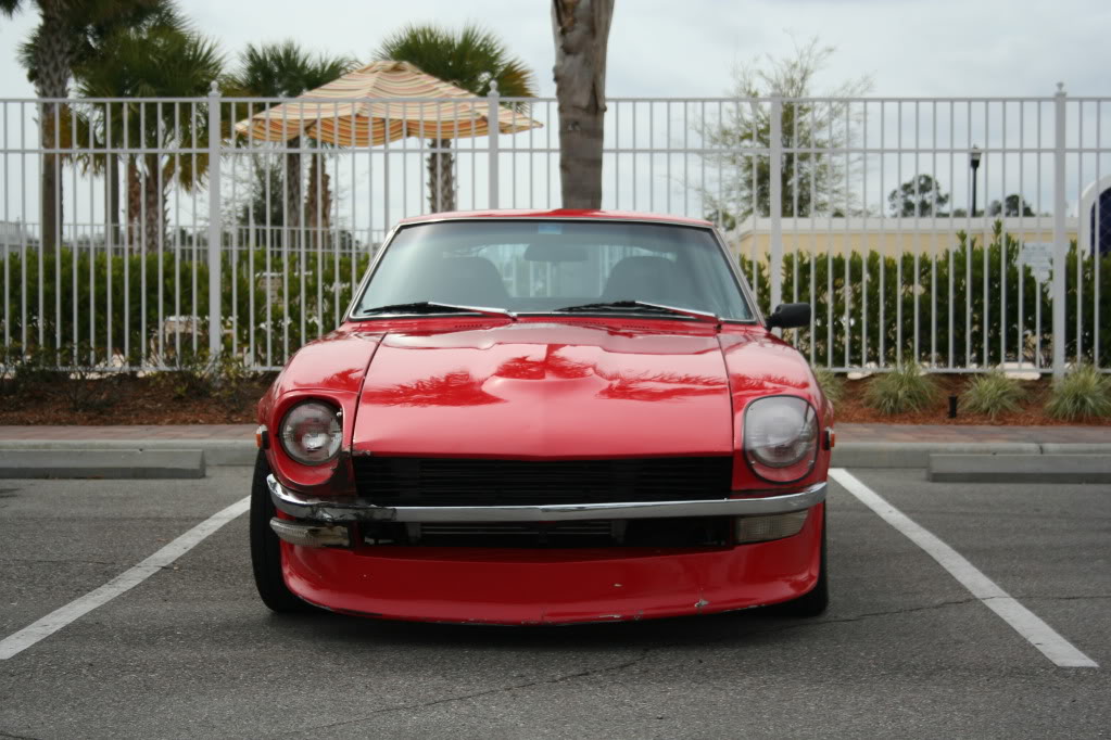

Sick car, unfortunately its up for sale and not in the best condition. Owner just wanted to pretty it up to make the sale go faster. Car looks great considering its almost 40 years old. Turbo motor included.

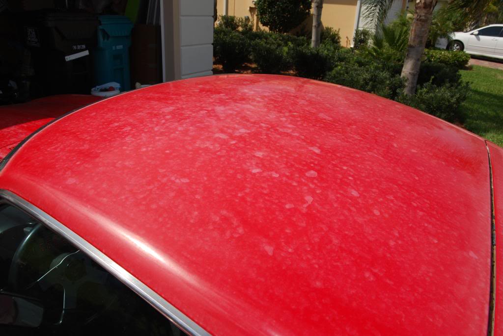

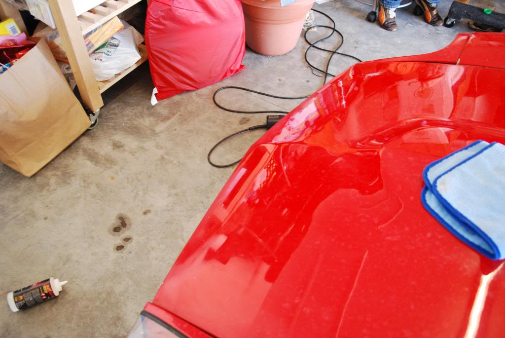

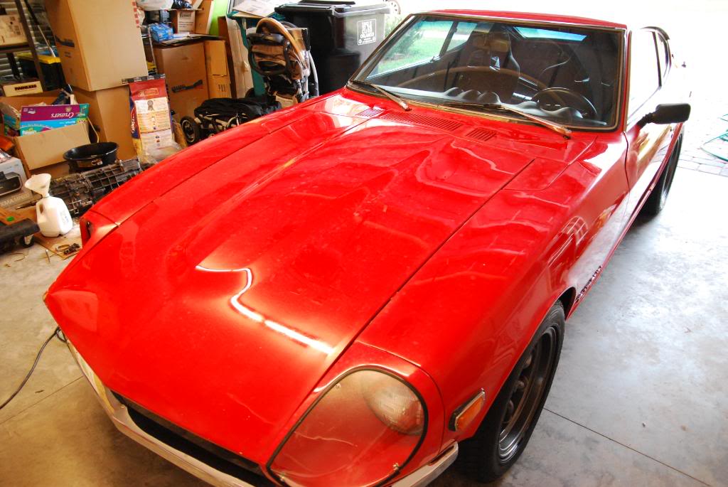

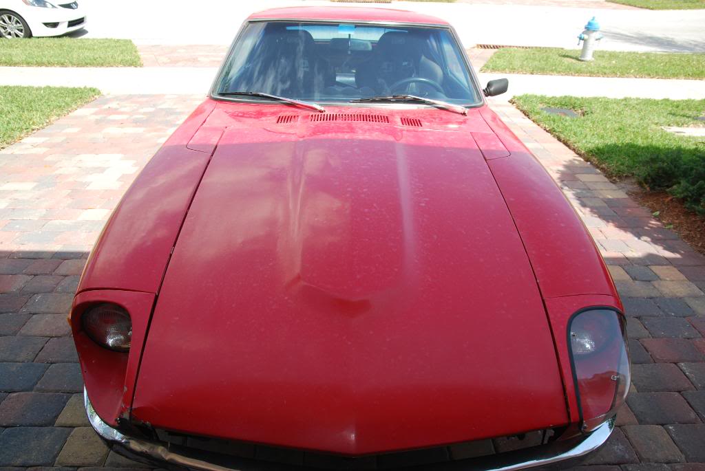

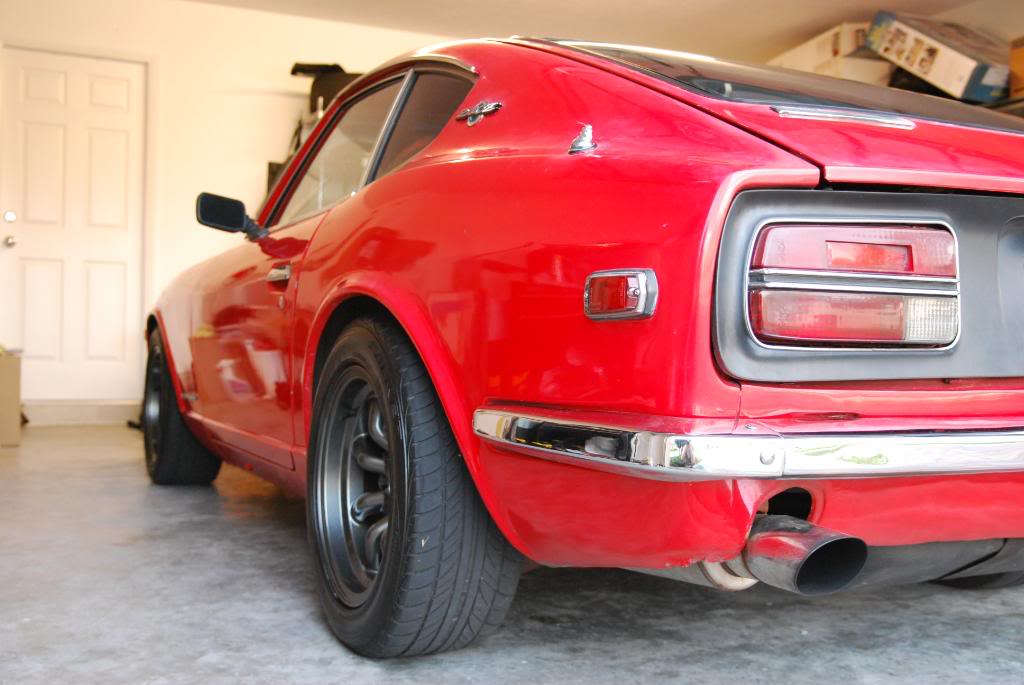

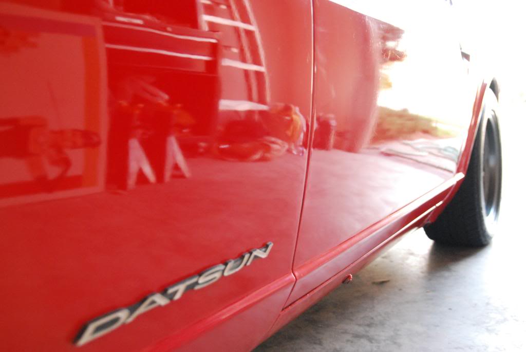

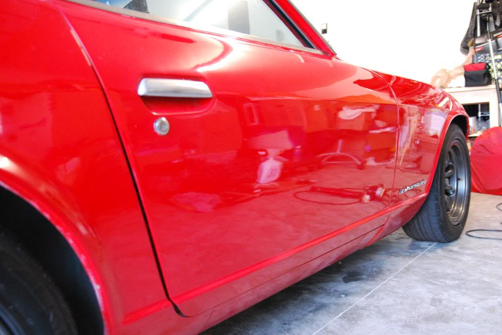

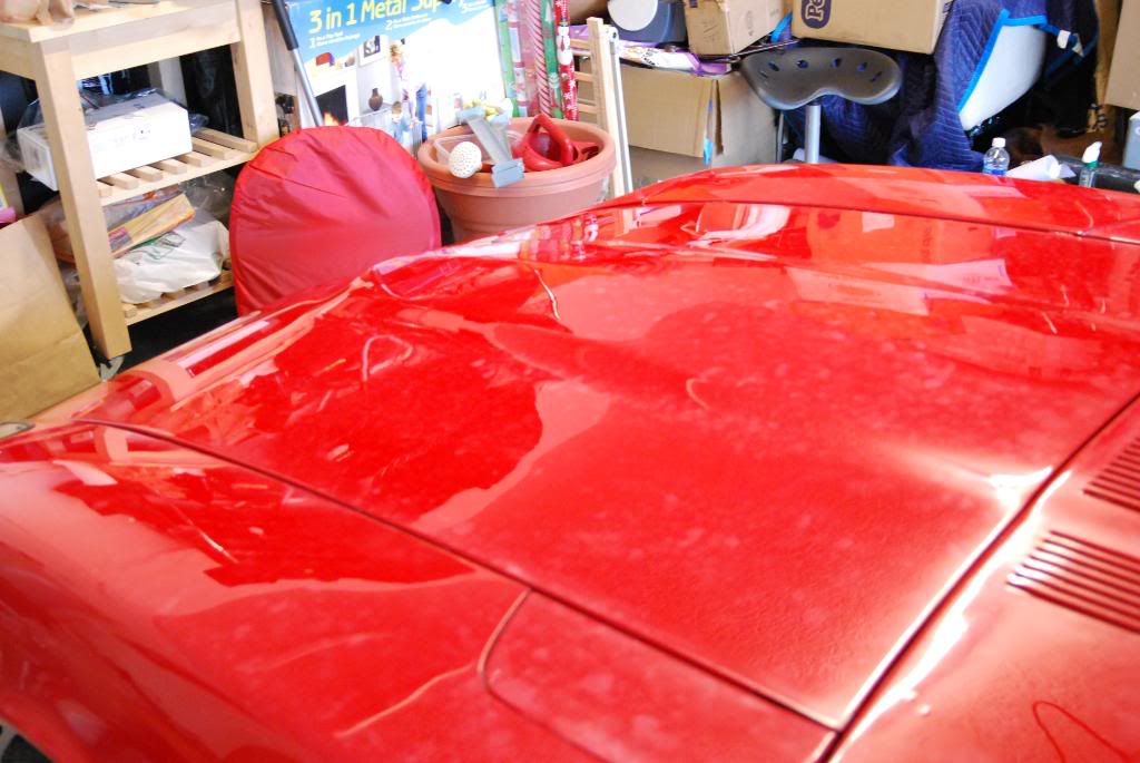

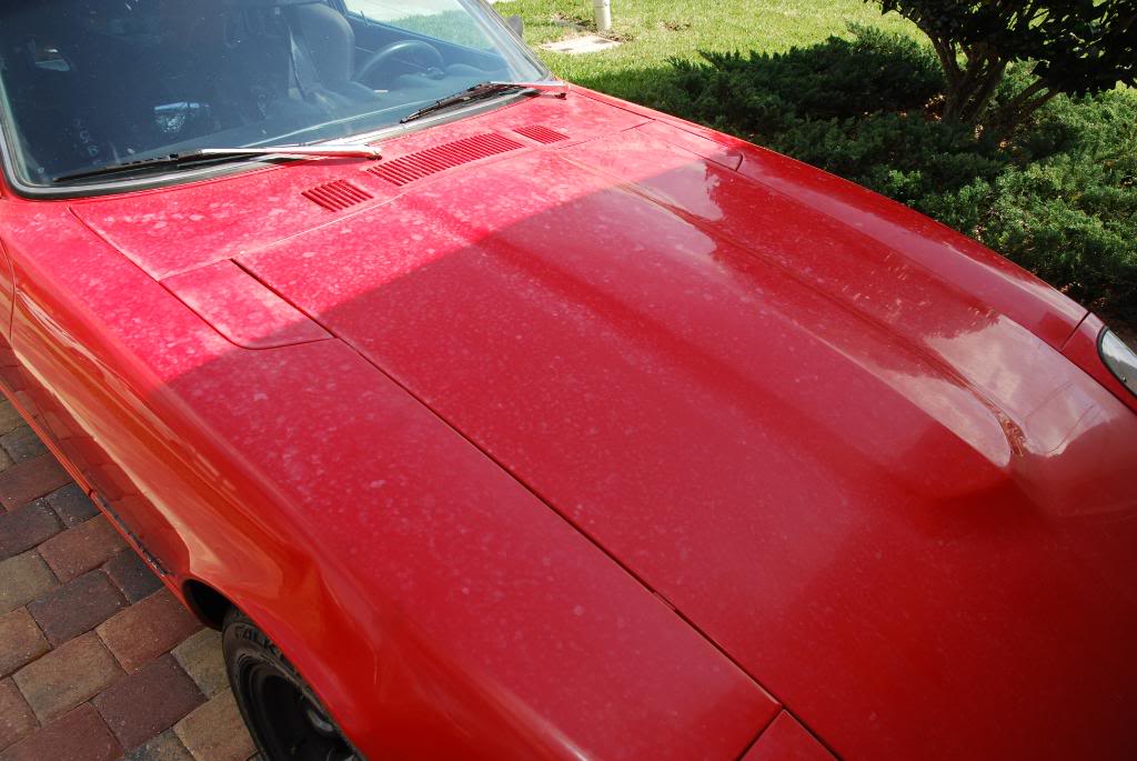

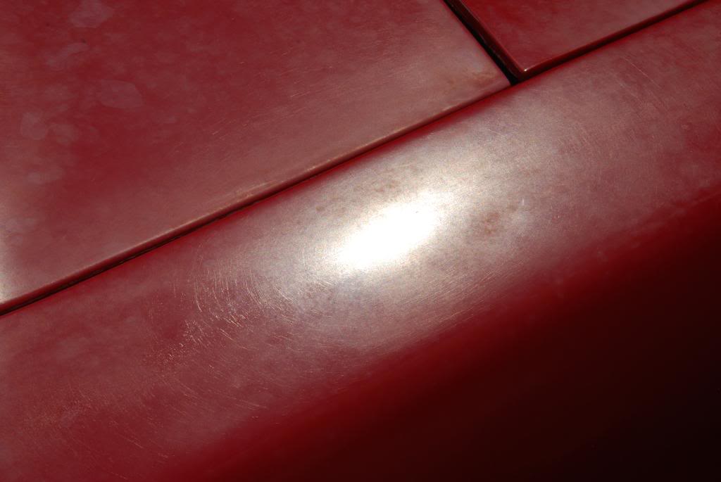

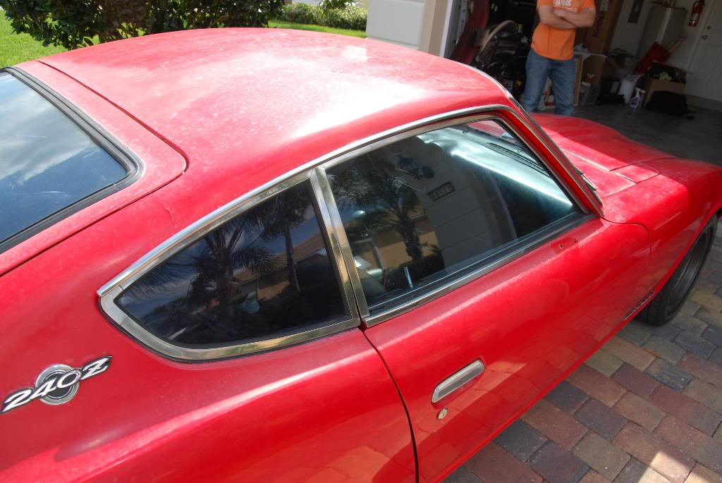

Had some trouble focusing my camera today... Overall the detail went well. This was a single stage paint job, fairly old. And it has been previously wet sanded and polishes. We agreed that doing another wet sand would be a bad idea, as the paint is already running thin in several places. The owner didnt want perfection, but just needed the car to be more presentable.

M105/4" Orange Flat pad using the Kevin Brown method. Then some M205 on Orange also. Used Clearkotes red moose glaze, and duragloss aquawax. All topped with FK 425.

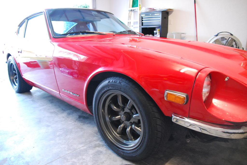

Thanks for the great work qb! Here's a couple pictures I took the next day. It was overcast so the lighting wasn't ideal.

I think the damaged front end gives the car character =P

Dang QB13, your skills and knowledge in detailing blows me away. This one tops them all IMO, the car looks like it has a sheet load of hard water spots and 40 years of scratches and you fixed her up and made her looking hot again. +rep for a hell of a job.
One question tho, what made you decide to use Clearkotes red moose glaze, and duragloss aquawax and FK 425 instead of all the other products that are out there?
Old Mar 29, 2010 | 06:31 PM
qbmurderer13's Avatar
Posts: 2,373
Well I used the Clearkote because it works amazing on red cars, and it has a very good filling property, which this car needed. It still had some rain etching but the glaze really helped fill in and hide any of the imperfections left behind.
