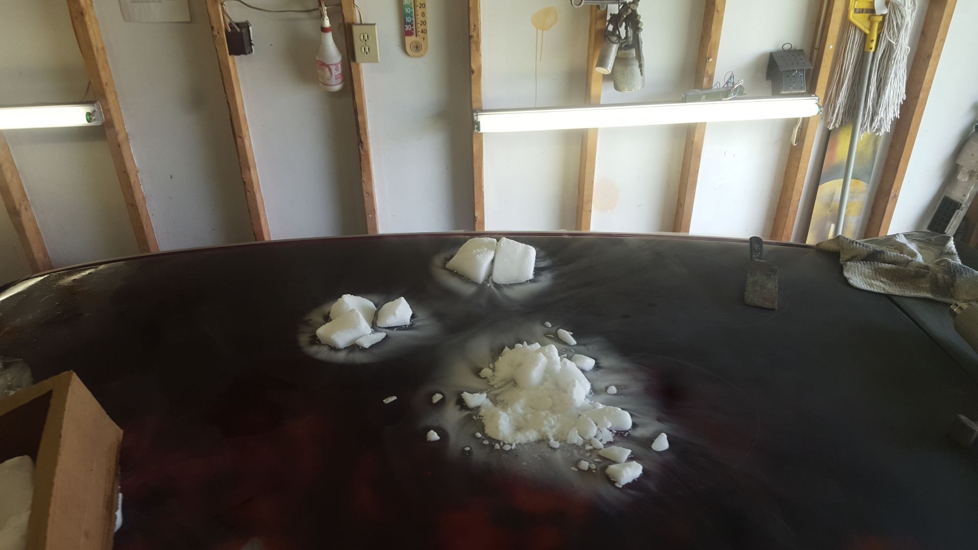

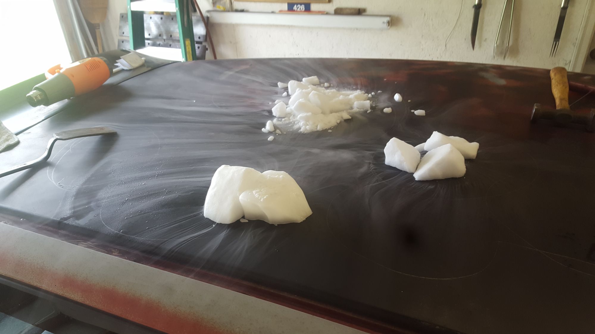

Well started back on eggy yesterday. Bought 10# of dry ice and shrunk the dents in the roof. OMH the roof looks like the Grand Canyon. Place dry ice on the low spots and slapped from the inside with the palm of my hand.
Best 13.78 I've spent in many a day!
Dry ice on a dented up roof.
This dry ice method pulled about 60% of the dent up..
Attached Thumbnails Daddy's Winter Project :)-80-20160806_124857_dbdee67a9953a8871b416fcbba9b994cfa18e54f.jpg   Daddy's Winter Project :)-80-20160806_124213_b8cb1006d7a9d82789ab46c3e53627864fd0166f.jpg   Daddy's Winter Project :)-80-20160806_124459_84236574c624ecc7c51732b5543928a4bb932496.jpg

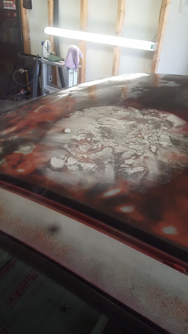

Biggest panel I've ever straightened
I don't know the story behind the roof but its been a lot of work to straighten it.
Attached Thumbnails Daddy's Winter Project :)-80-20160807_215639_3de074c7918b27ea93ad931232e81a3d2ca8197b.jpg

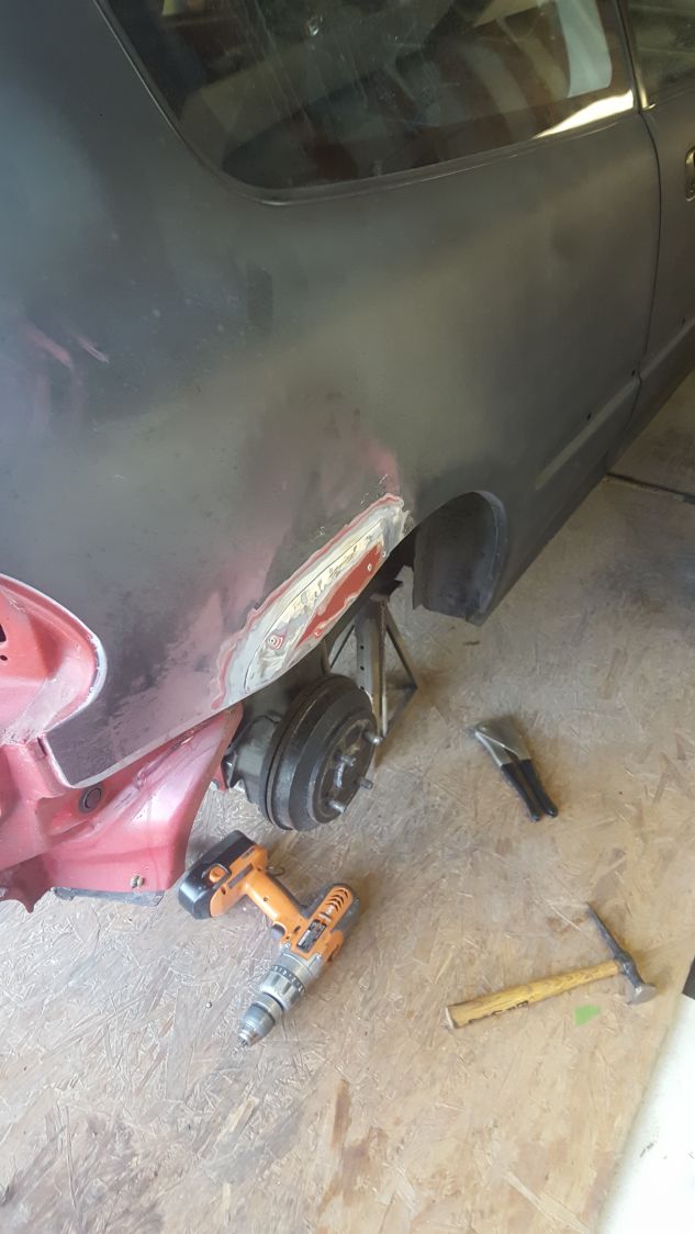

Winter project 2 years later
So today was
a good day for the eg. Finished the roof, yeah!

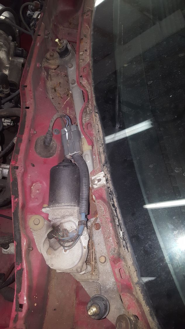

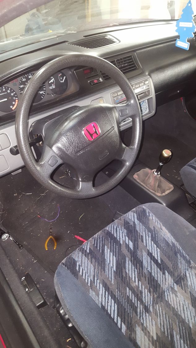

Hoods off, cowls off, wipers, ect.
J's steering wheel logo installed.

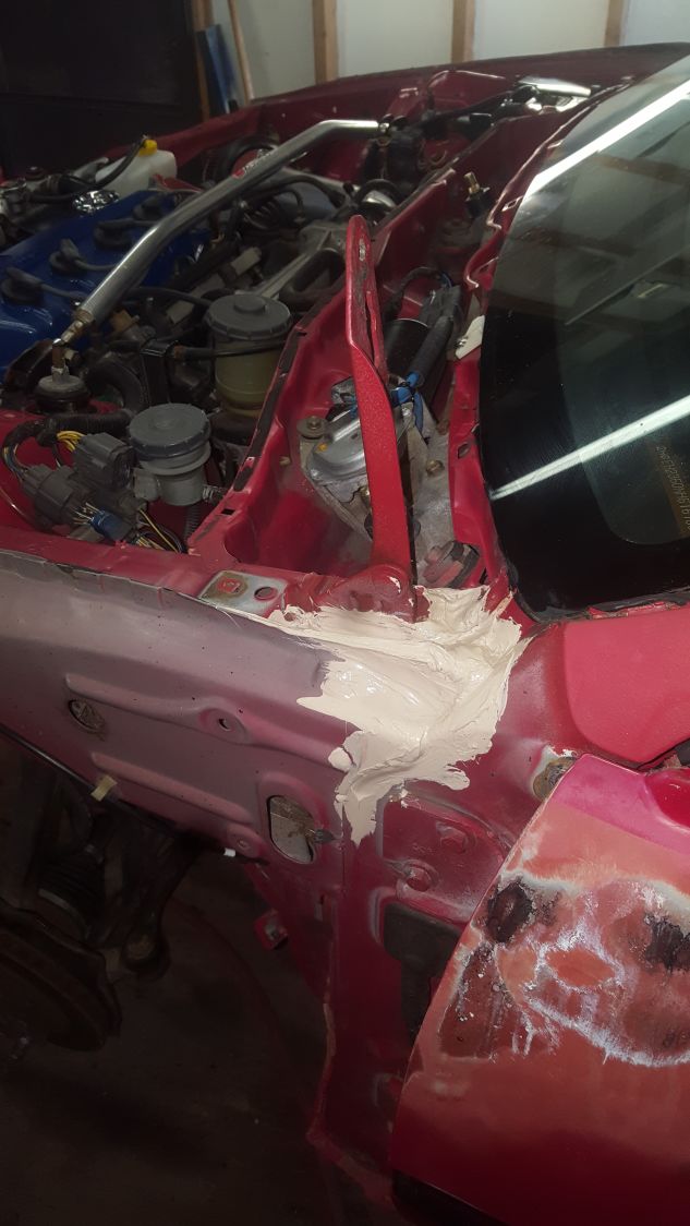

1/4s have the rear rust, ospho'd that inside and out.
Cutting and welding and coating area to prevent it from coming back.
The base a ball bat dents are gone, but not forgotten lol.
J's H logo.
Cowl area 1992 hatch
Attached Thumbnails Daddy's Winter Project :)-80-20160808_225553_19d55ea231fe2c55ba8d094b4ab938cad2beafdc.jpg   Daddy's Winter Project :)-80-20160808_225447_c90b1805f1be3de42ad1271cace8688d05abcb93.jpg   Daddy's Winter Project :)-80-20160808_200421_1c561796f00c54f04651d2a8c6ba73f9da1f839a.jpg

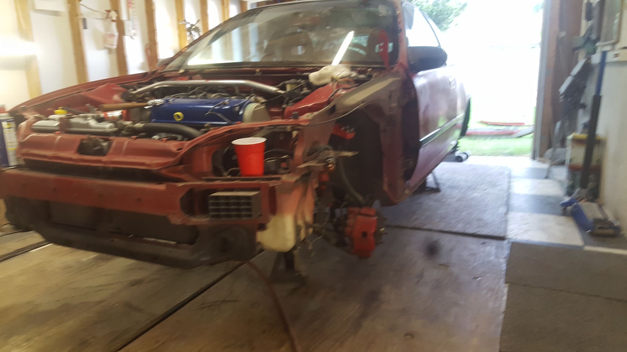

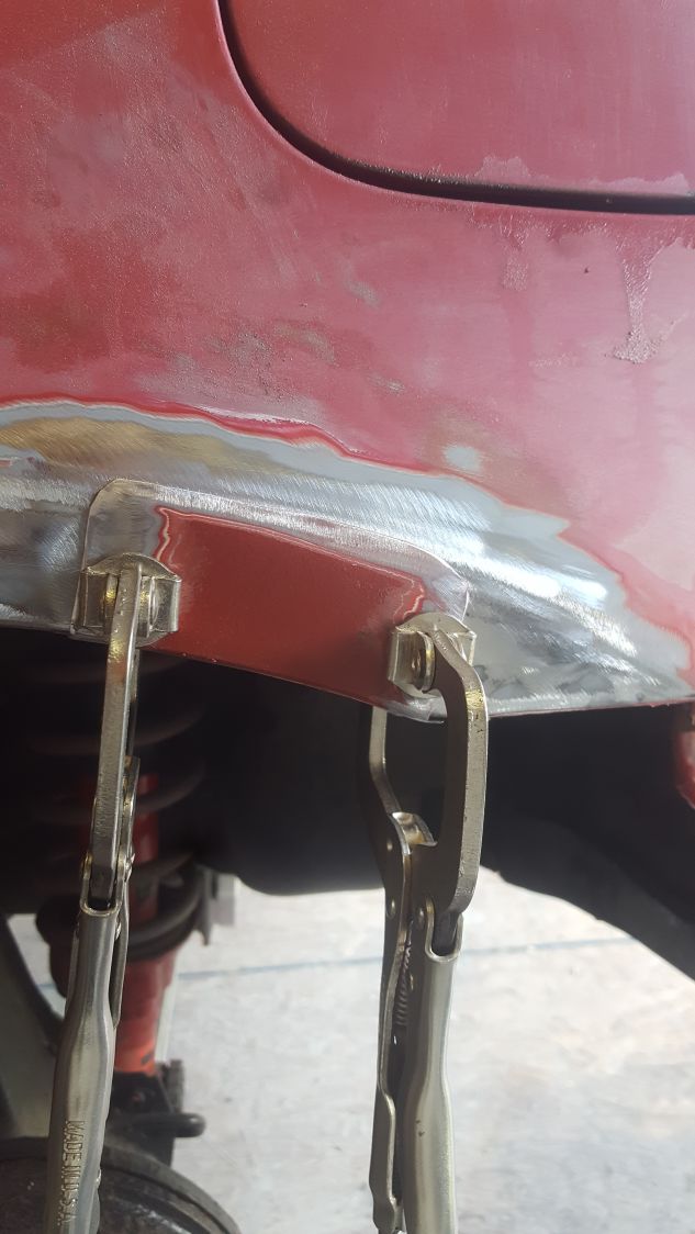

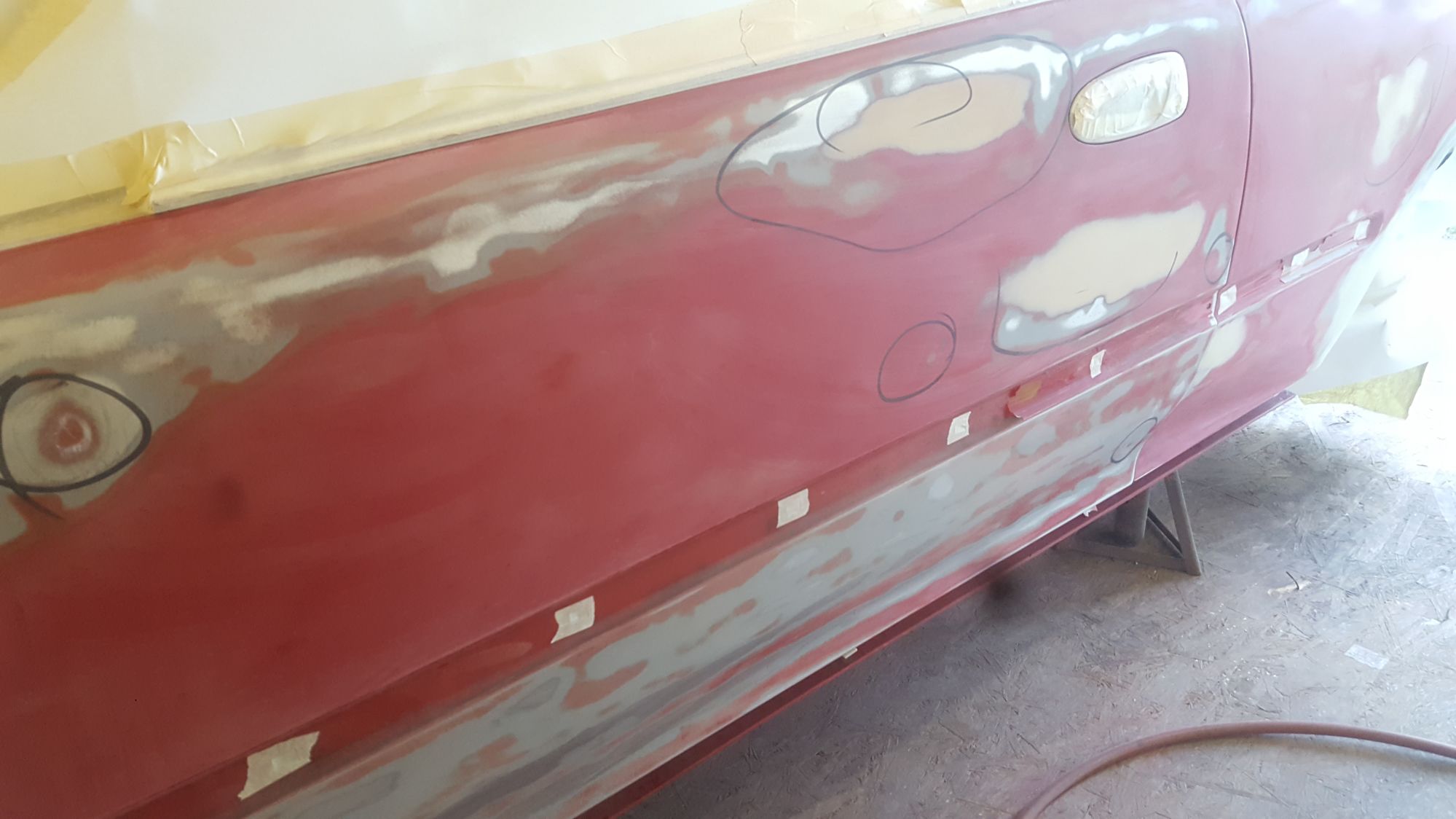

Getting ready for painting.
Fitting patch d.s.
Fitted patch on p.s.
Attached Thumbnails Daddy's Winter Project :)-80-20160809_140420_aa7295972769d8b60a9c4d8a2f5b6b130de4712f.jpg   Daddy's Winter Project :)-80-20160809_165131_4736e877e9df7ec1ac7b57a8da4f6e2d93dad382.jpg   Daddy's Winter Project :)-80-20160809_165508_04e47d387dd7ffdd36ce8b7b82179e9b683dabdd.jpg

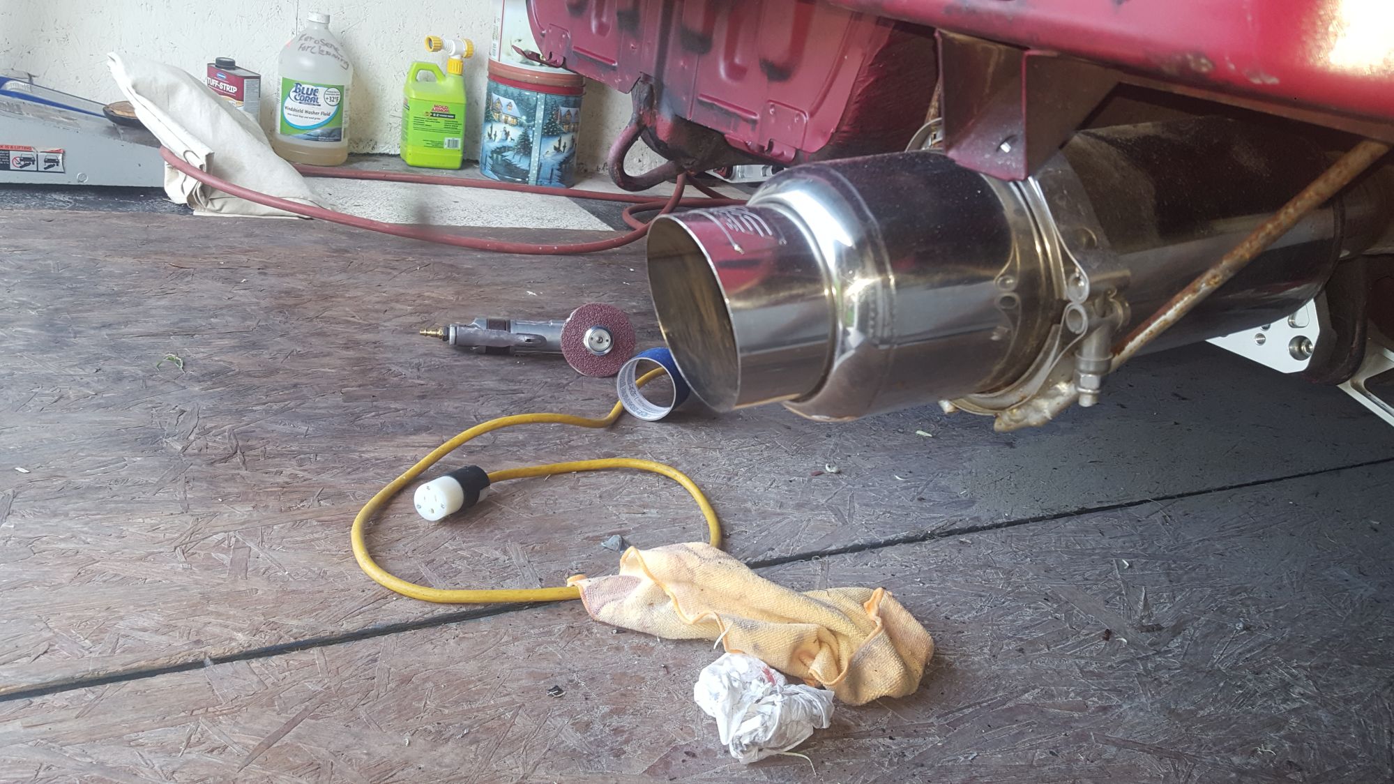

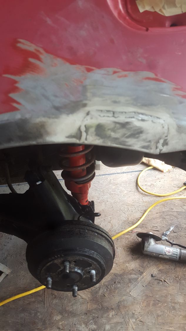

Patch work
The patches where welded in at lunch by Jimmy. Thsnks to him coming down at 12 the project is staying on track. He doesn't know it yet but I'm taking it to his shop so he can straighten out what another muffler shop did for me.
Then came the cleaning... wheel wells, engine bay, cowl area, hatch & door jambs, everywhere thst is getting taped up is clean.. this makes it so much easier when I put the car back together.
Lil mafia shop's work
Pulled out old cracked seam sealer and replaced w/ new.

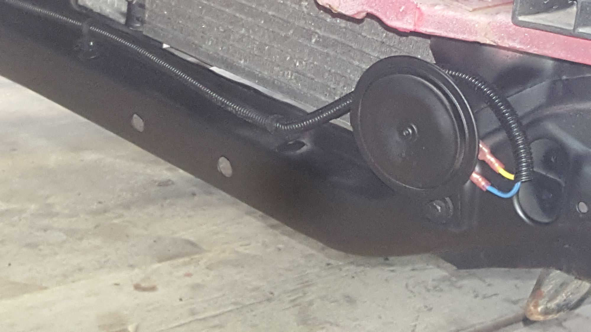

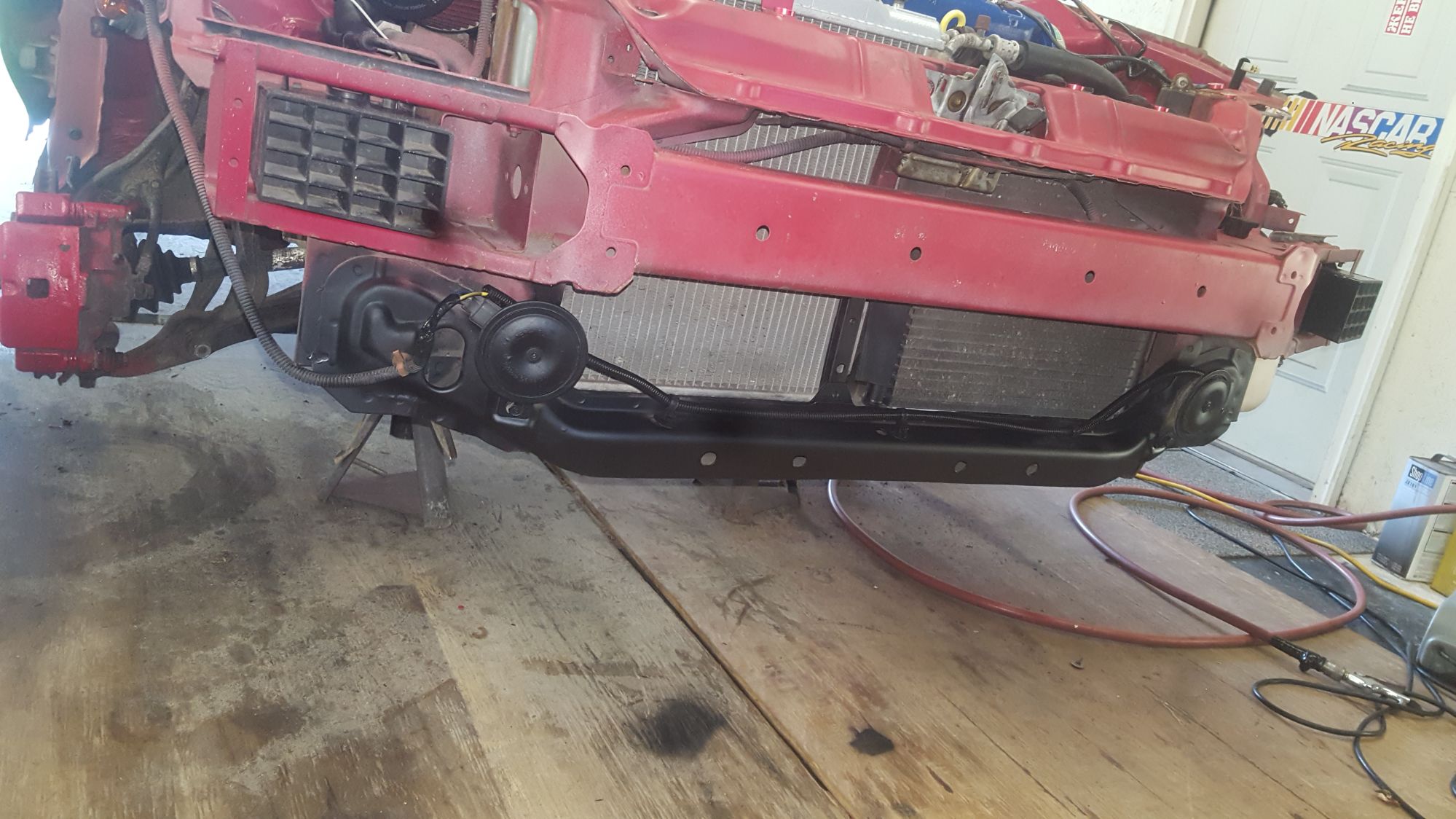

My shop runith over with parts!
Added a second horn i pulled off a Isuzu pup. <br/>They are not on the same pitch, very annoying...<br/>PERFECT!
Civic and pup horns now together

Thought I was finished on the driver's side, but o'contra.
