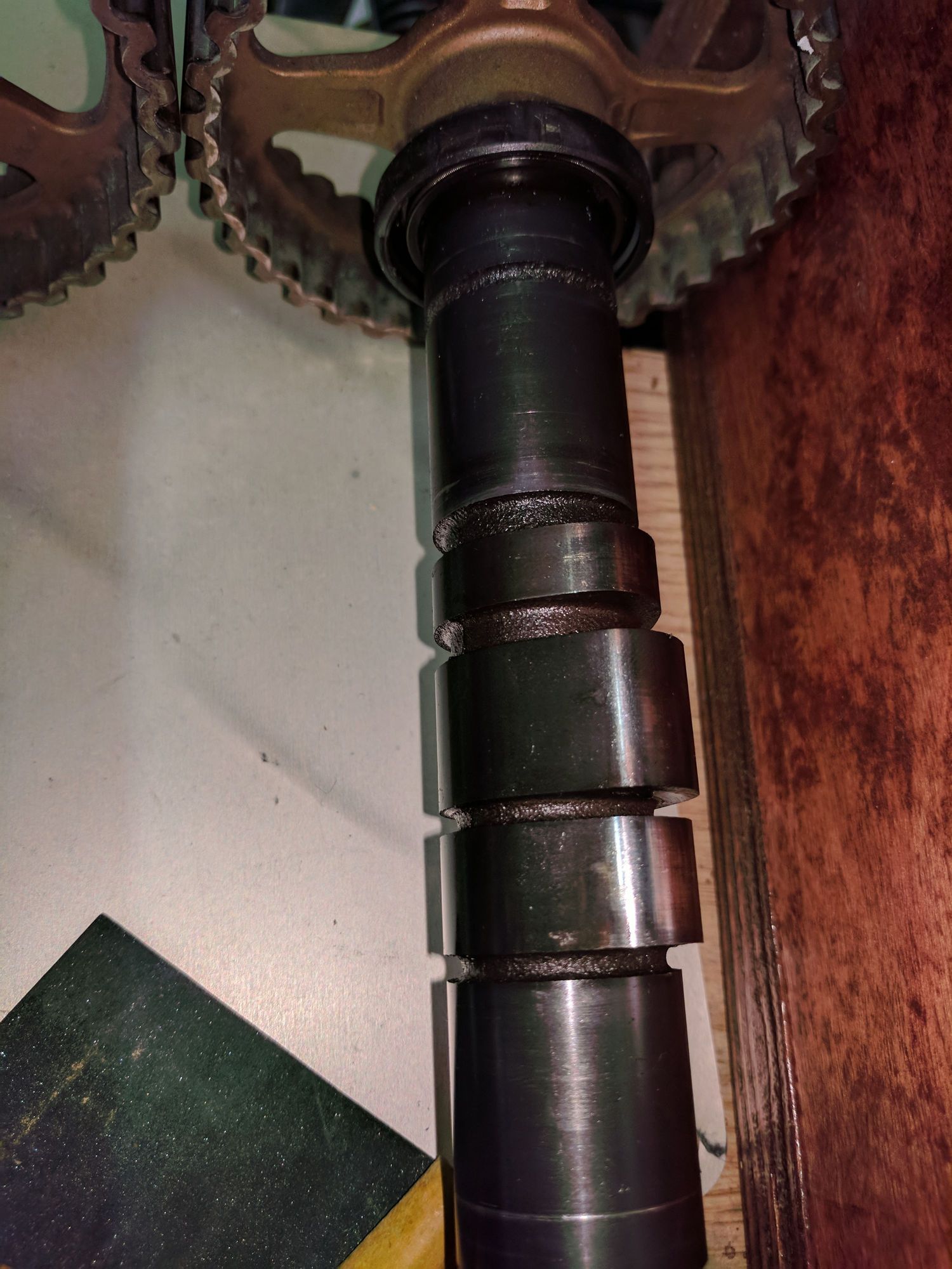

Here are a few pix of Frank's head, I don't know the history but I took it apart and am happy to see very little wear on the cams and valve train and overall Clean!
Thankx Logan.

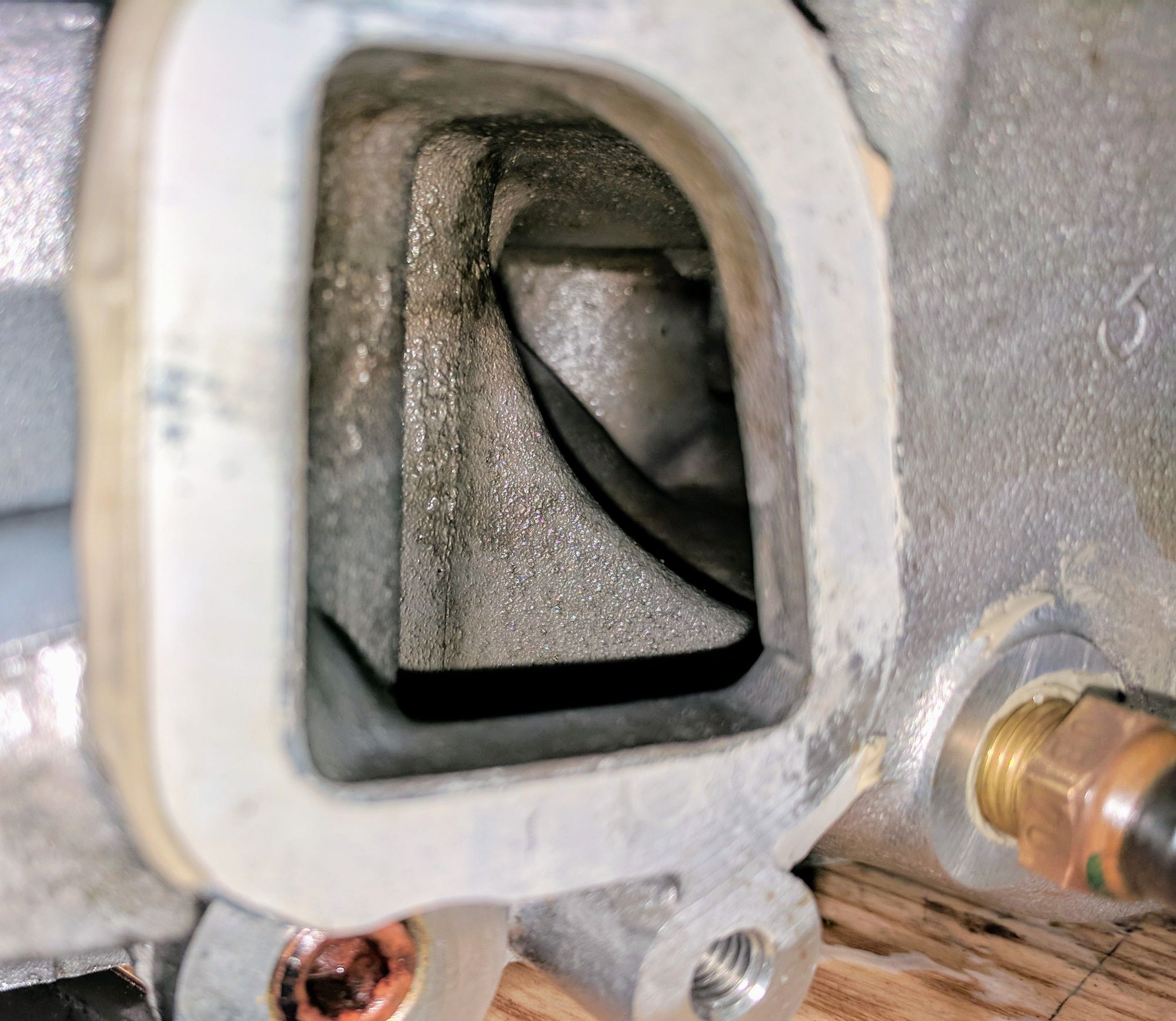

Combustion chamber tonight and that's about it for Frank today.

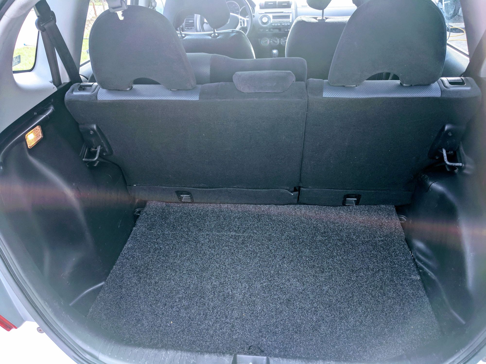

I've been maintaining this poor little FiT for 5-6 years now, and the owner is buying a Civic seadan. She asked if I'd cleaner her up (Roxy) and sell her this weekend. She dropped Roxy off with the signed title.
Cleaned the whole car and recovered the cargo area with new carpet, repaired a few things. And it took seven minutes till it was sold! :D

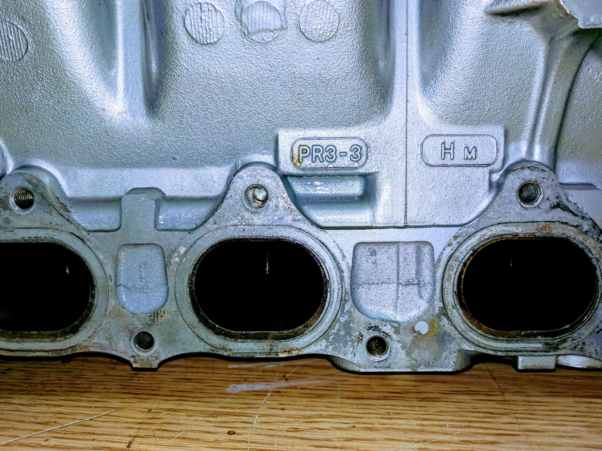

P R 3 Intake with T B and sensors
This was from CL out of Blacksburg area. Fresh out of the box.
After detailing

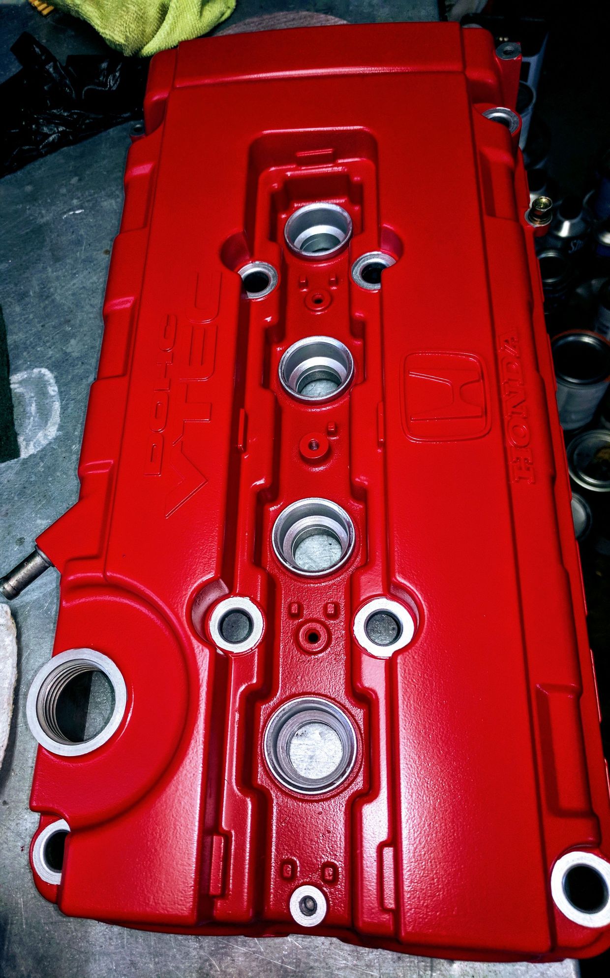

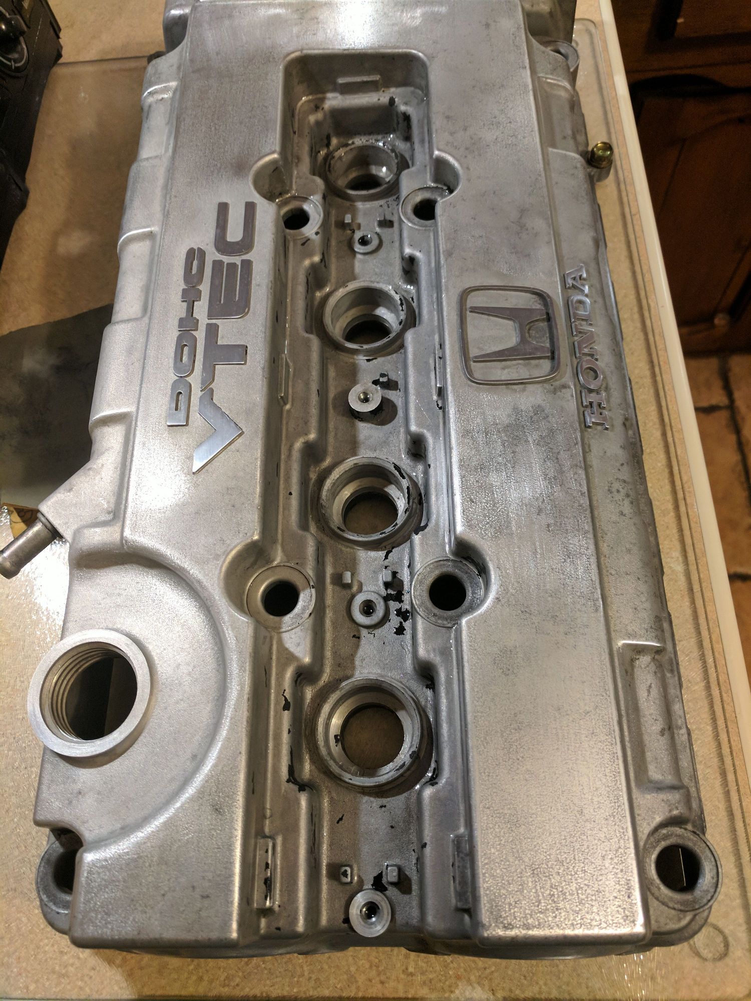

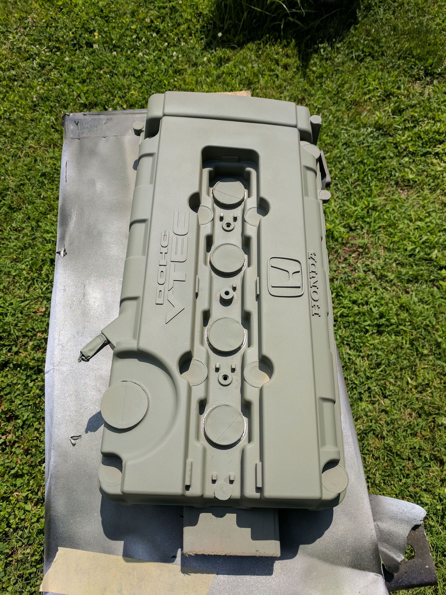

satin red valve cover, gotta be a twist :-D
Step one, stripped
Step two wet sanded
Step three polished lettering.
Step four tape & etching primer, light coats
Step five color coat, wetsand letters, with 600, 800, 1200
Step six satin clear
Polishing the lettering before you paint will make it a lot less work when you go to clean up the letters after painting.
The satin and polished letters should contrast each other well, hoping it'll looks good?
