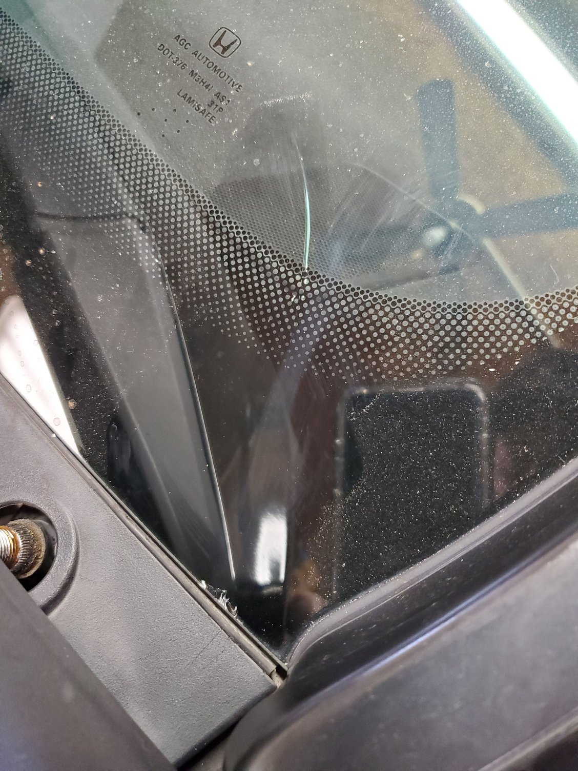

I removed the wipers, they took a little coaxing. *NOT NECESSARY*
Here you can see how I used a screw driver to crack my winshield. This piece that covers the wipers DOES NOT NEED TO BE REMOVED. Ask me how I know...

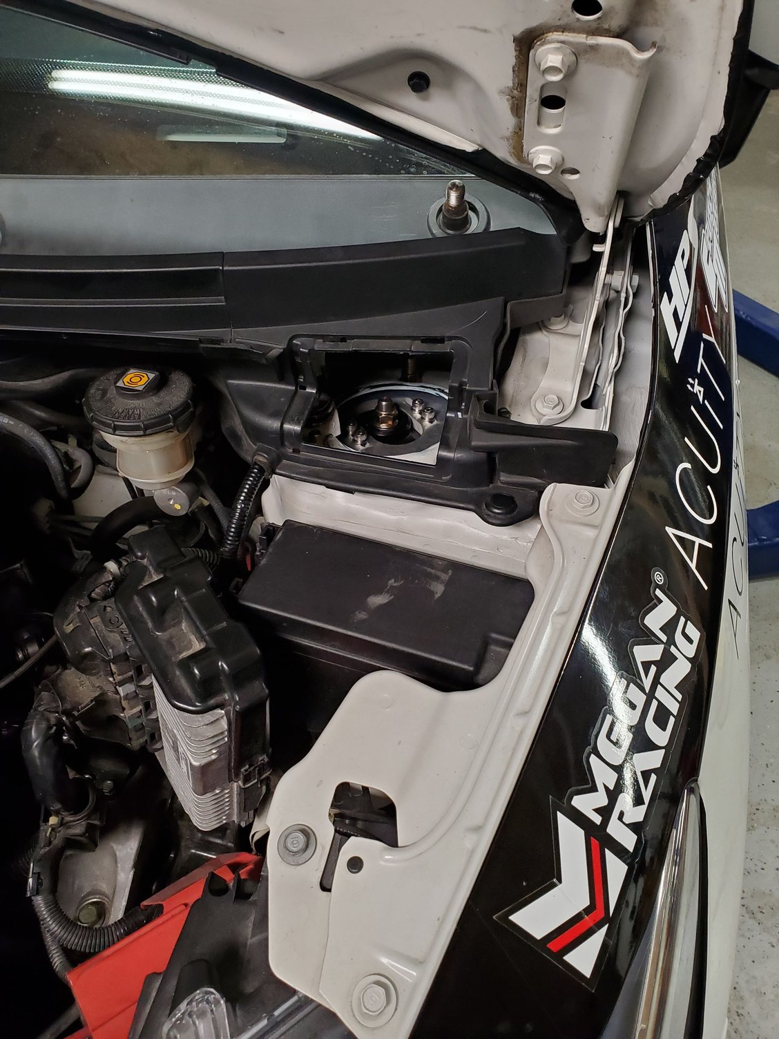

I just used some wire ties and yanked the hell out of this side. It cracked a little bit, be careful.
I also cracked this side. You take off the lid to the brake fluid reservoir, then you can pull the plastic divider over and replace your cap to rest it on top. Makes for plenty of room...

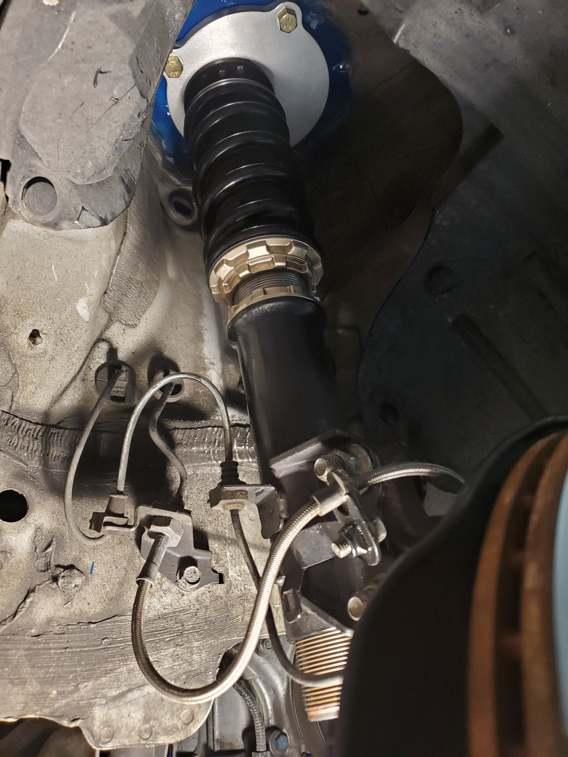

I spent 3 hours looking for these. Disassemble your coilovers. I left the brakes assembled, did not need to touch them.
All that yellow is about to get cut off...

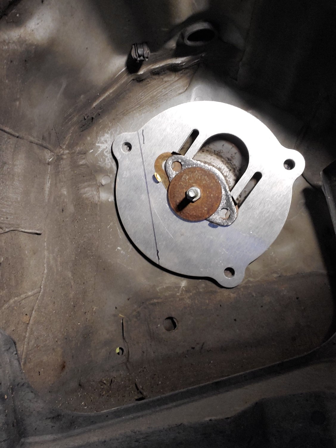

Front of the car is to the left where you see the line. I used the above setup to hold the template while I marked the holes.
Holes are marked. I drilled, advancing from 1/8", 1/4", 5/16", 3/8", 1/2". The half inchers got stuck and it was a pain in the ass. I think I needed special drill bits for sheet metal, but I miracled it to the finish regardless...
I used a cutoff wheel on my air compressor tool. It was weak and took forever. Shoulders killed... On the driver's side I used the Harbor Freight super torquey grinder I use for porting. That thing is scary... I'd say there's no going back on this car at this point.

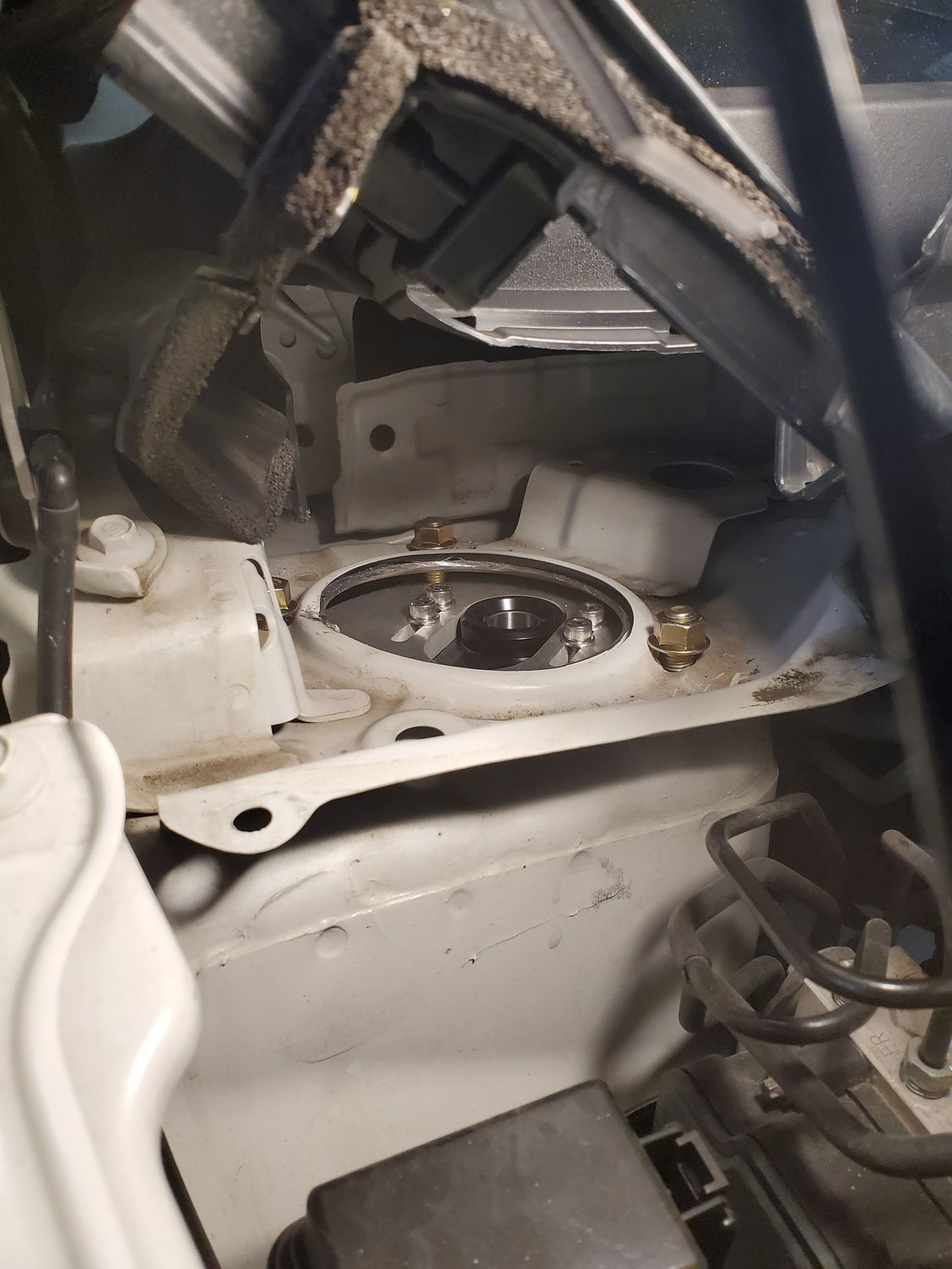

Here's a first fitment. This side was pretty easy. Driver's not so much...

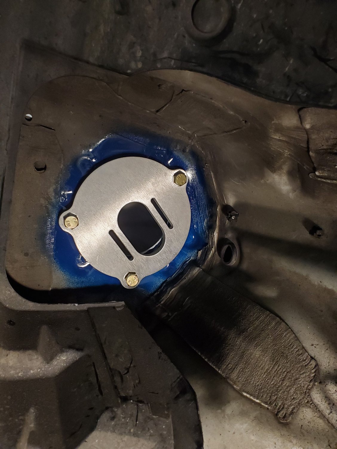

I had some paint around, so hit the bottom where I was sloppy with the cutoff wheel...

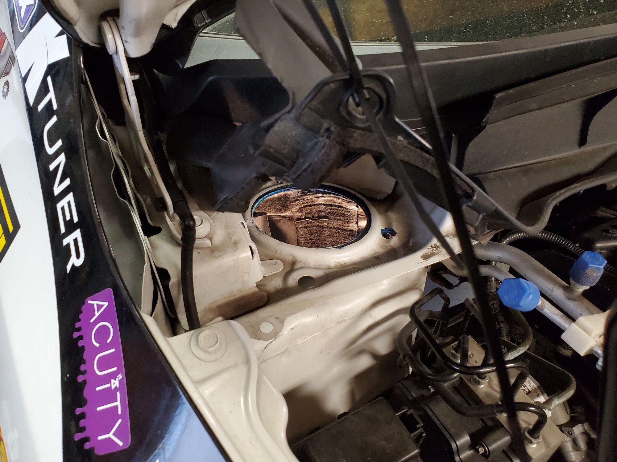

This side was not cool... You can see where I am making room, this was one of quite a few tools, hammers, punches, and chisels. Not a mod for the faint of heart.
What's down there???
Thank God for this lift!!!

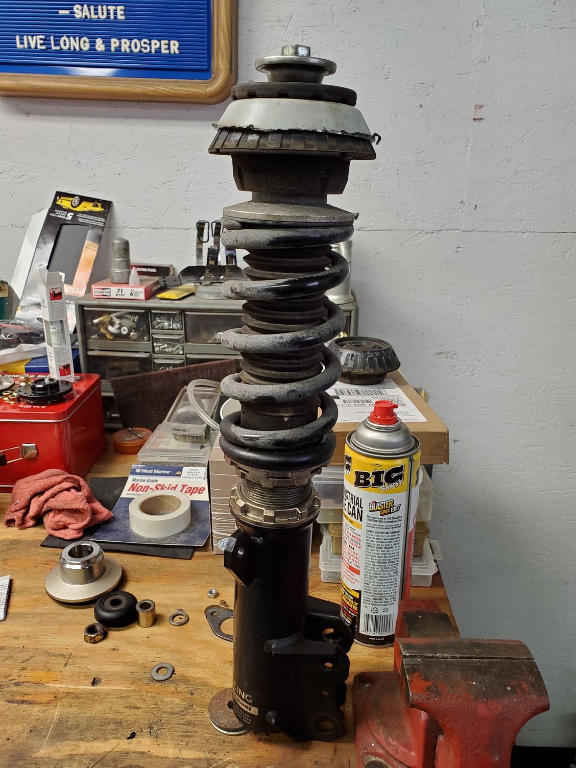

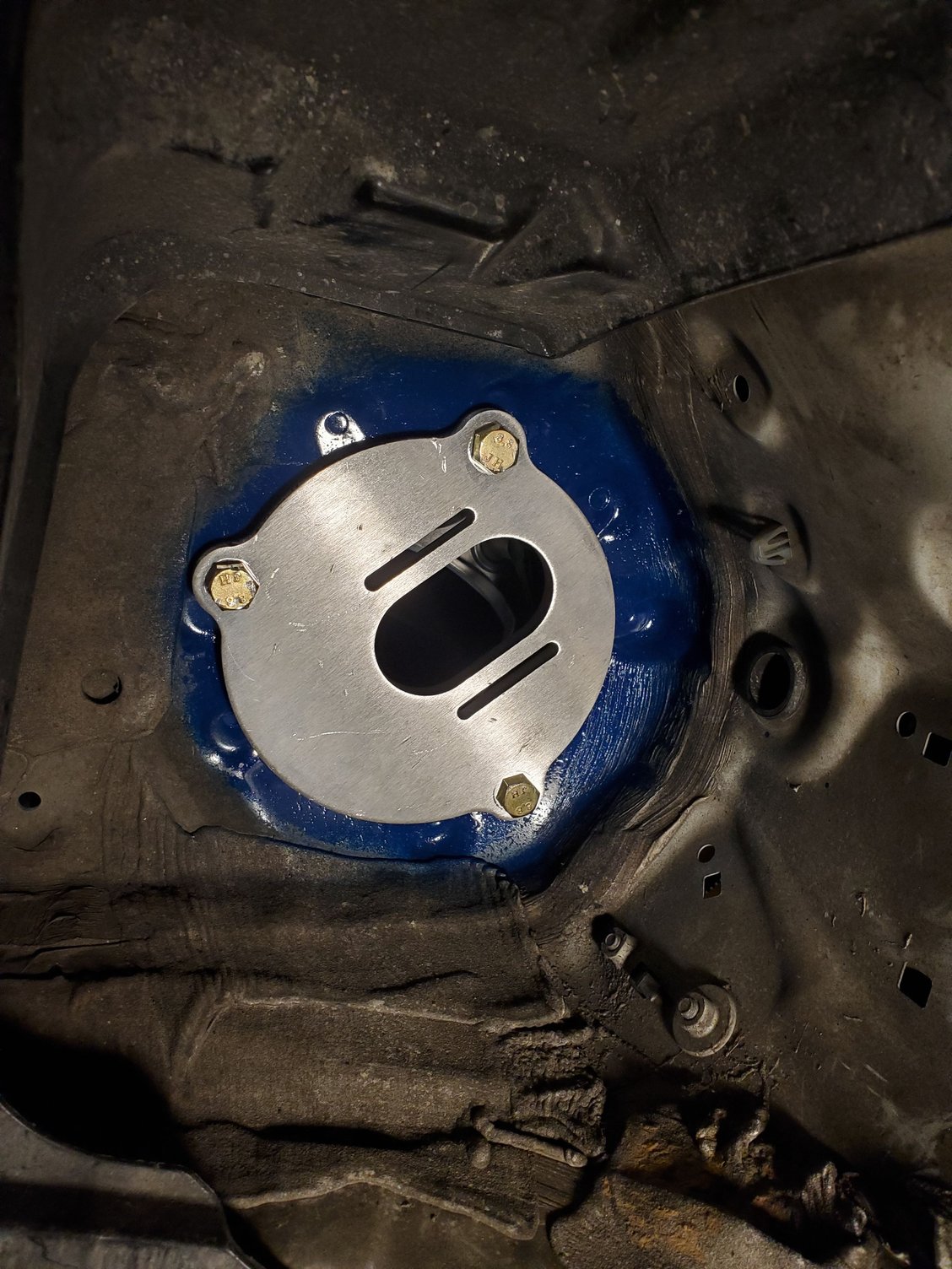

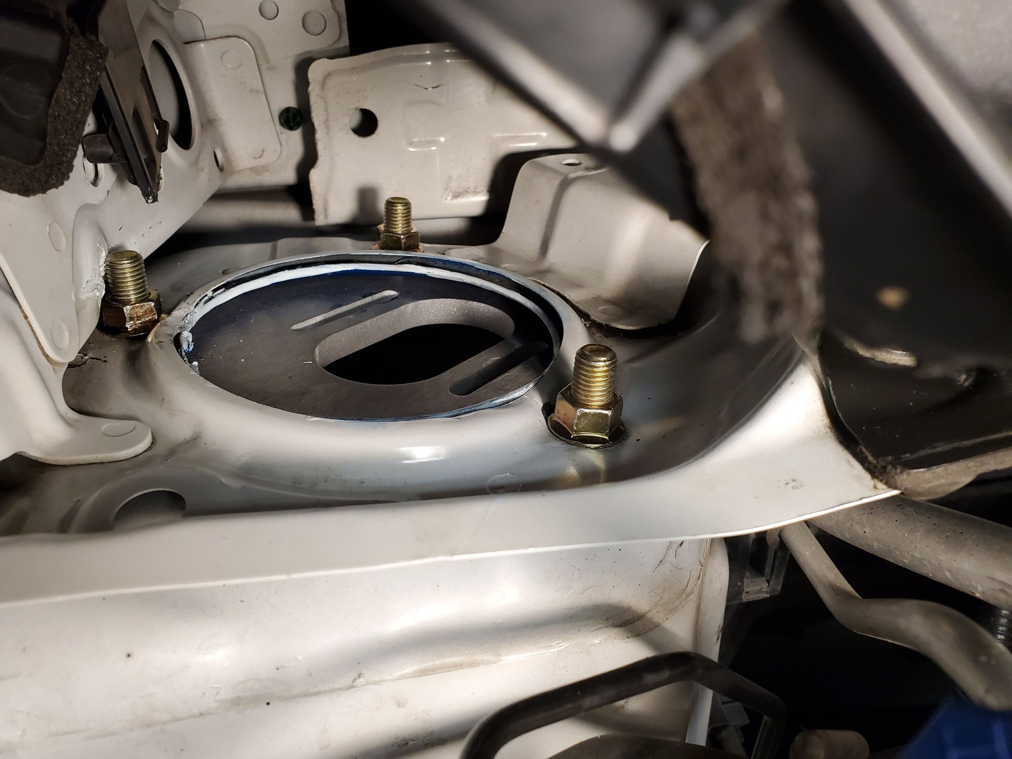

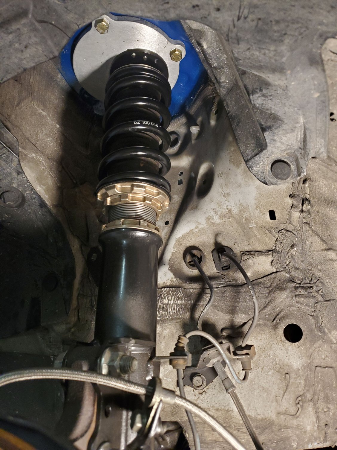

Here is my coilover as it was in the car, complete with factory cutout in the stack above...

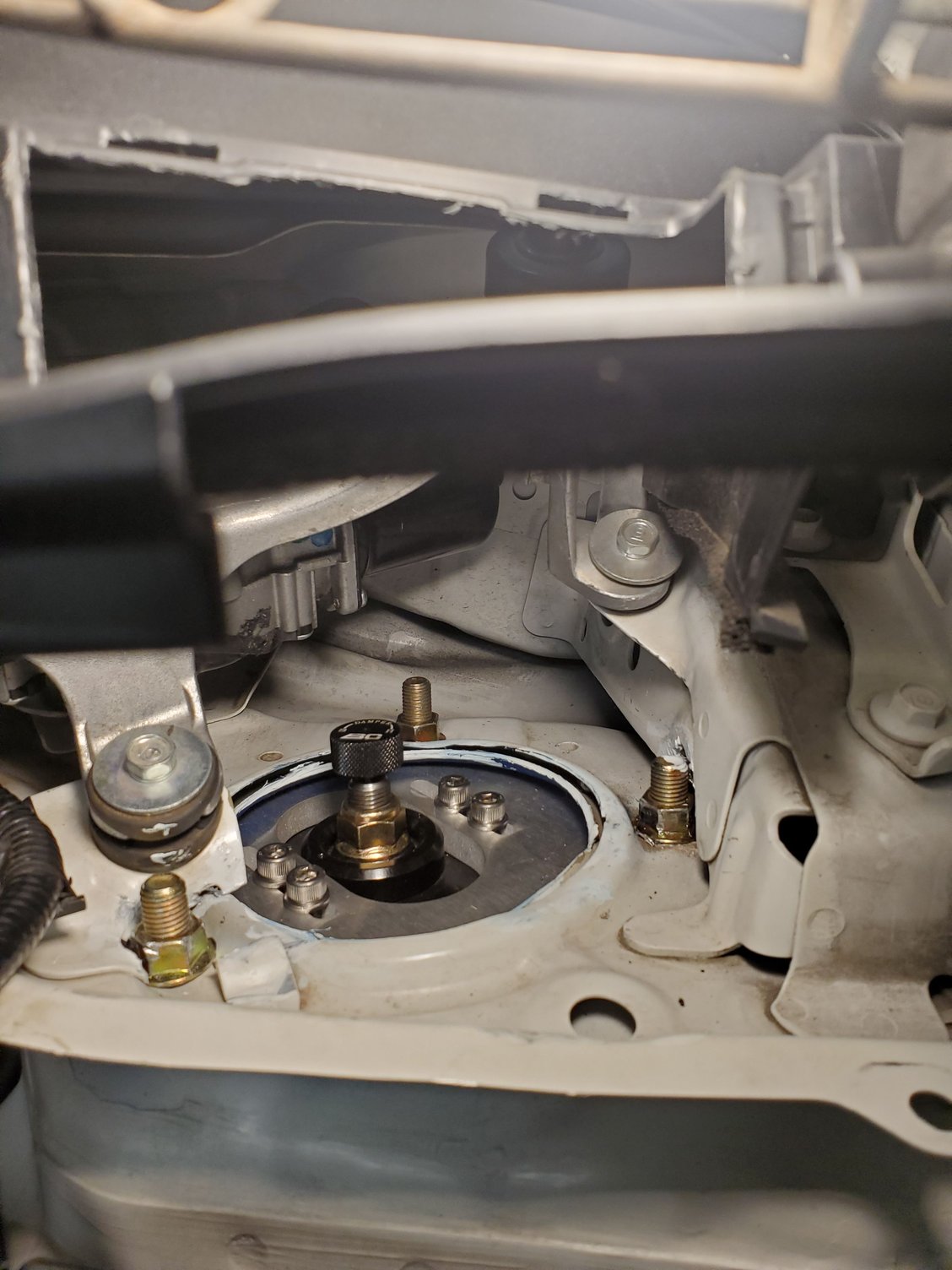

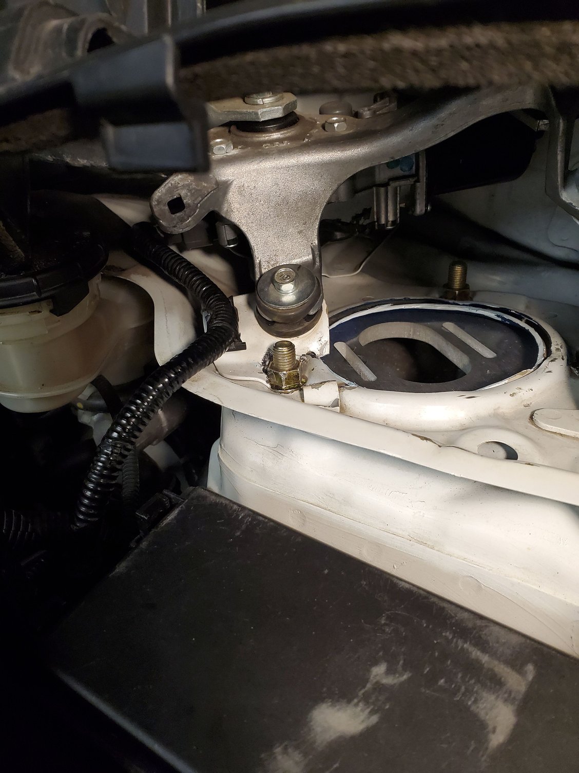

OK. Basically, I had to cut off some of the bracket for the wiper motor and bend the rest of it back. Caster Camber Plates > Wipers because #racecar, but I think they'll be fine too. I got some Honda touch up paint. for the edges and where I was pounding, cutting, smashing... Mixed in with some of the blue (from below) accidentally on the driver's side...

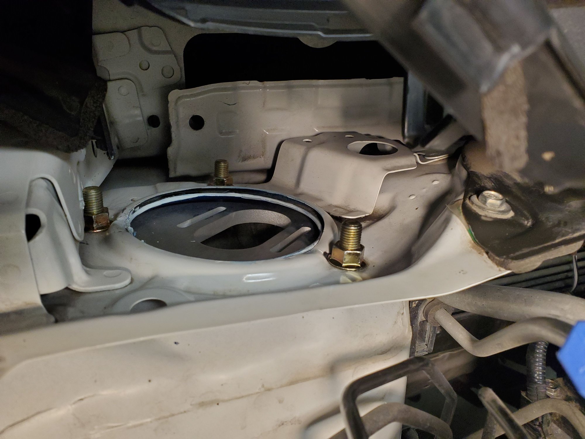

Passenger side looks dreamy easy lol. I had to pound out that bracket to the left of the left-most bolt...
Another angle
Another angle

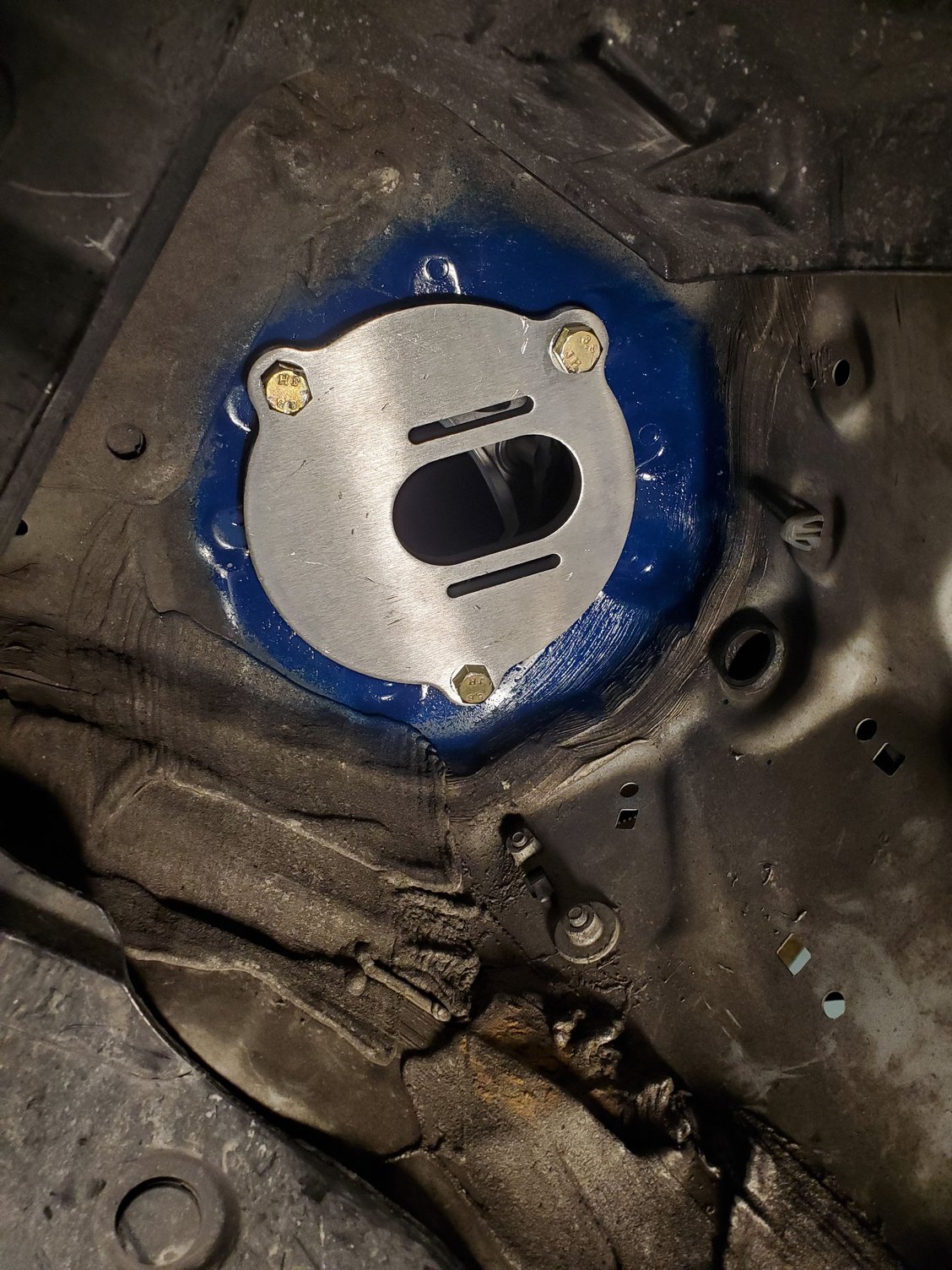

Tower from below...
Another
Another
Another

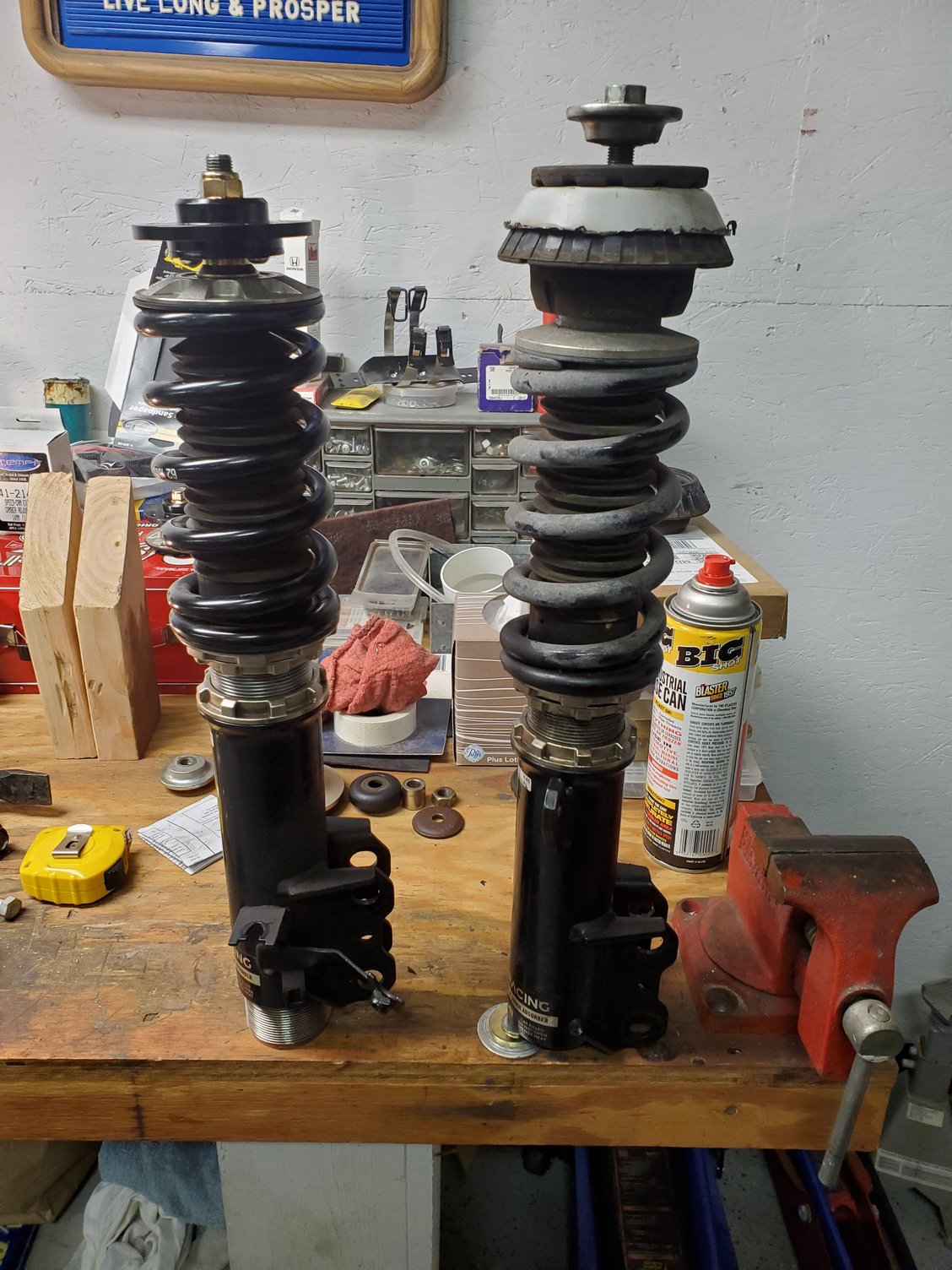

Here is the difference. The coilover stack on the left is the new bits as they will be attached to the plate with 4 allen bolts per side. There are six bolt holes to provide even more adjustability for the four allen bolts...
First one in there
Another
Another

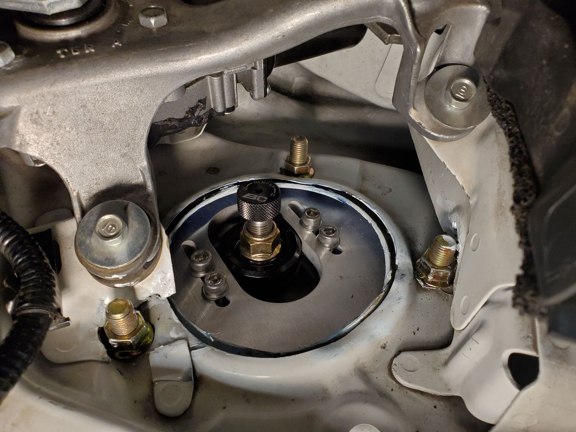

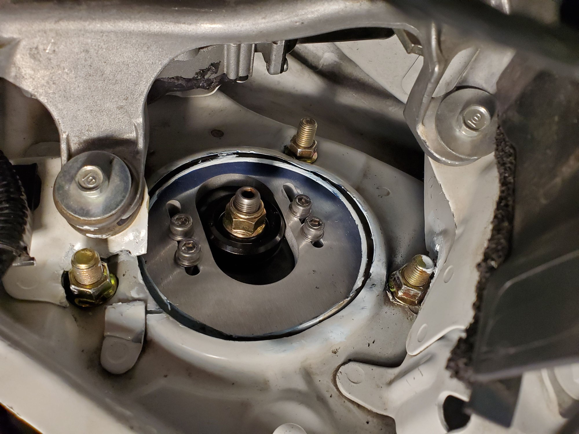

And up top, with the BC Racing 30-way adjuster knob installed.
Again
Again
Driver's side after I repainted the mess...
With adjuster...
Another view
Driver's side from below
Another.

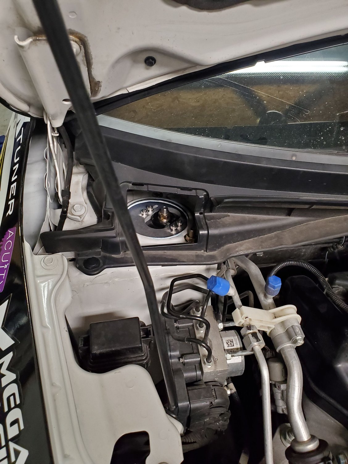

View of both plates and shock towers.

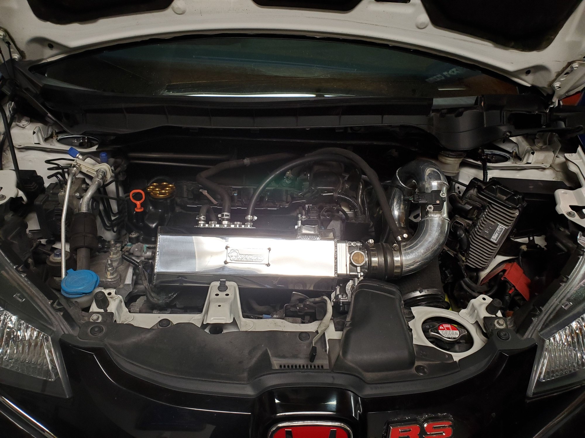

Button her back up.
Peek-a-boo!
Like nothing ever happened...

question.... why are the adjusters oriented like diagonally instead of with fully left to right movement?
super nice mod BTW....
Old Jan 18, 2021 | 10:21 PM
galaxy convoy's Avatar
Joined: Jan 2017
Posts: 63
From: WA
To adjust caster and camber at the same time
