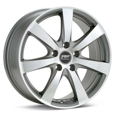

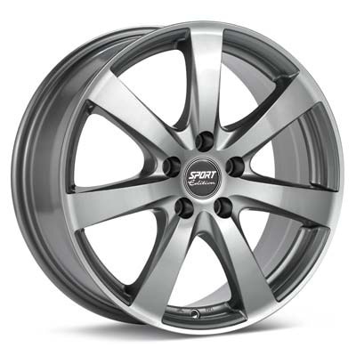

In 15x6 4x100
Sport Edition D4 Silver painted (closeout pricing)
$84 with +47mm offset 14.8 lbs
$59 with +50mm offset 14 lbs
Sport Edition E3 Bright Satin Silver Paint $84
+45 mm offset 15.6 lbs
Sport Edition E3 Machined with Anthracite accents $84
+45 mm offset 15.2 lbs
By comparison stock 15x6 rims are about 17.5 lbs each

Sport Edition D4 Silver painted no longer available at tirerack.com
It's possible you could find it from another source-
Sport Edition - D4 15 x 6 4x100 50mm (Silver)
Canadian $ 119.95 for each wheel= $121.59 US ! Yikes
C$ 26.00 for each wheel shipping to US
C$ 583.80 for set of four rims shipped to US
Sport Edition D4 Wheels | TireTrends : Save on Sport Edition D4 wheels!

I tried out the Sport Edition D4 in 15x6 with +50 offset.
Seems like it's more than 14 lbs each. More like 16 or very close to stock weight. Kumho V710 205/50-15 tire and rim was 34.4 lbs and tire is supposed to be about 18 lbs.
