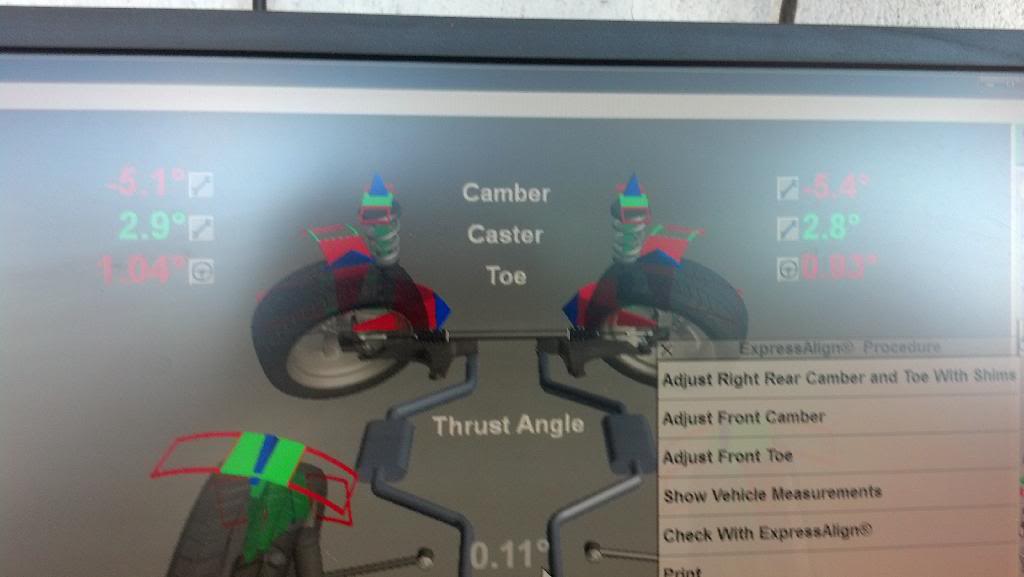

How are you getting that much camber in the front? I installed some SPC bolts in the front and at best I'm getting is -2.0-2.2. I have the front dropped about 2 inches. I just did that tonight actually. The steering wheel is crooked as hell. After I race tomorrow I have to go back to Firestone and have them get the wheel straightened out.

I put mine at full negative and I get -5.5 ish

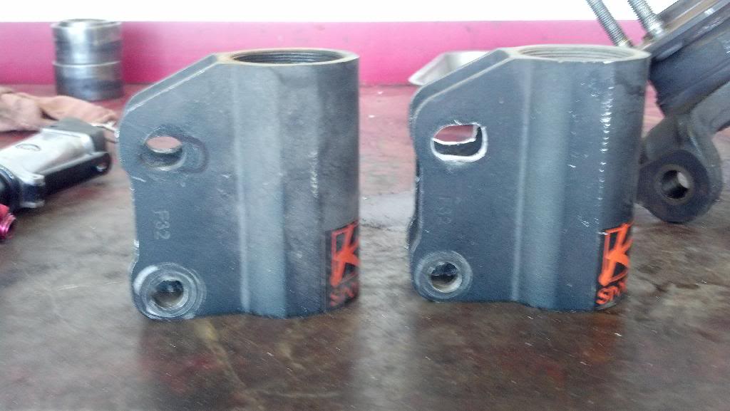

Damn what I'm I doing wrong with mine. Its odd I adjusted my Ksports for as much negative as possible and only got -.4. So I went and got the SPC bolts and yanked the shit out while the guy loosened the bolts and we got it to -2.2.
I found this strange. I would imagine with the adjustment on the coil overs alone I should be able to get some good negative camber. With the bolts I figured at least -3.
What I'm I doing wrong? Maybe I need to bring it to a suspension pro. The guys at Firestone are good. I usually help them while they work on my car.

Trick of the trade

Hahaha makes sense now. Thanks for the tip. This will be the next project in a few weeks. I'm sure the guys at Firestone are sick of me the fast few days specially since i'll be back again tomorrow after the race to get that steering wheel straight.
