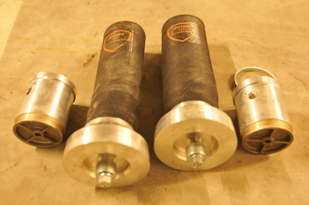

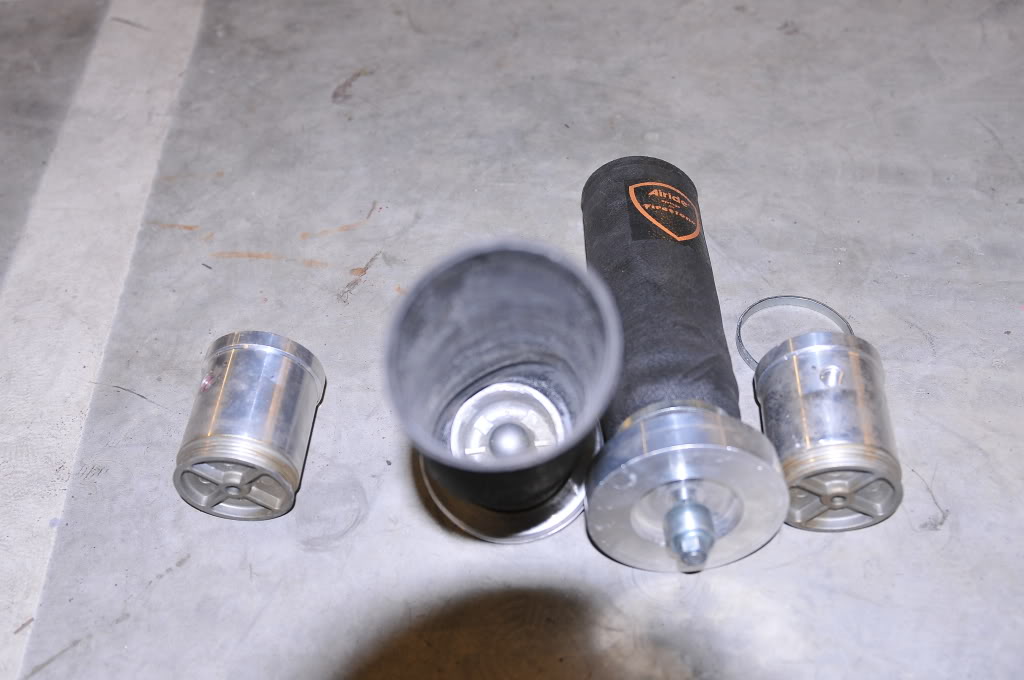

generally, sleeve bags are very easy to blow if you don't take care of them properly, by that means, when you jack up the car, make sure the bag is disconnected from the swing arm other wise the weight of the swing arm and wheel will pull the bags apart
here's what happened

when i refer to a bag i refer to a bellowed bag. I would NEVER use a sleeve bag for the purposes you are speaking. I install sleeved bags from time to time but for helper bags for big trucks. That retain a minimum pressure of 5-10 lbs and maximum or about 40. And only when it has a load. I'm not suprised that the sleeve bag you pictured came apart. I hate the sleeve bags because i fear the safety and longevity of something that when u take the air out just folds all up on itself.
So if that was your bag i suggest you change out to a bag like this one. And anyone thinking of getting bags i suggest a bag like this one in the back.
