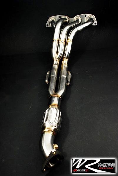

The GD3 only has the one cat, directly attaching to the header and before the B pipe. The Weapon R header replaces the OE header AND cat. In fact the second section, the 2-1 collector to flex pipe and 3 bolt flange is what replaces the cat. It's quite long

Oh dang, I kinda just assumed we had 2 OEM cats.

God, i dont miss owning one of those.. such a pain!
Do tell!
I have heard of fitment issues... can you elaborate?
I mean, I expect more noise and additional heat but, BECAUSE RACE CAR

It doesnt fit properly.. just like any other Weapon r product lol I had mine welded together at the slip "flange" part so it wouldnt leak.
You have to drop the whole subframe down to install the friggen thing..
it did sound pretty good tho.. just not worth the hassle for how little gains you get

Hmm, all good info!
I REALLY do not want to have to drop the sub frame
I KNOW that there have been fitment issues with Weapon R... I have an intake manifold of there's that's the early one that initially belonged to Felix and went through several other sets of hands before I got it
Funny story, I took that TO Weapon R as they are local to me... And they didn't want to give it back!!! Said it was a "test fit prototype" that should never have been sold I still had them clean, and weld in the necessary braces it. But now it's just a paperweight as I can't be competitive in the class it puts me in
And as far as gains, I will take ANYTHING that my class allows!!! I got Mini's, Yaris and Corrolla's spanking me in the WHP numbers... But thanks to FlashPro and I guess some of my own skill I have been keeping up

Well I can tell you for sure if you dont drop the sub frame a little you wont get that header in.. and it will rub on the heatsheilds and it will make noise.. you may even break that flex pipe thats in there.. I have LOL

So you installed it from the bottom? I did the DC Sports little shorty one from the top no problem... but I figured it was not going to work so easy with the much longer WR...
You broke the flex pipe Man.... I'm hoping that my stiff mounts will not let the engine transfer as much motion back... and noises LOL I already got quite a few of those I saw some one else on here said flat out to just remove the heat shield. Can't recall which one though. Where did it rub worst for you?
