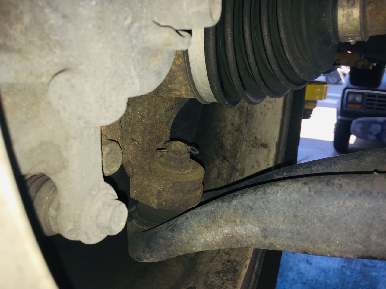

Took the fit to a local shop for a free suspension check out. It was one of those good shops, where the owner/mechanic walked around and under the car with me (their insurance company having conniptions, no doubt) and we chatted about things. Verdict was that I need new shocks and struts. Safe assumption considering they are the originals with 146k on them.
I was/am open to replacing other suspension components that are in need, but, everything else looked good to him. I snapped some photos with the iphone while under there to see what you all think. FWIW, I simply want the Fit to run as it should. Would I love to add a stiffer rear sway bar to plant myself in the corners? Sure. Do I have the cash for that right now? Nope. So, I was glad when the mechanic didn't try to upsell me on things.
He called his parts supplier while I was standing there and was quoted $600+ for shocks and struts and said the total of the job would come to $1,100 after their labor fees and shop fees for compressing the springs on the struts. Before I had a chance to react, he said "woah, that's expensive!". LOL. I asked if I could provide the parts and they provide the labor and he was fine with that. He quoted me $250 to install the shocks, struts, and change my tranny fluid.
Alternatively, I could rent a bay at a DIY garage (urdreamgarage.com) for $30/hour and do the install myself if buying complete struts. $250/$30 = 8 hours of lift time. Hmmm....
I now need to source parts. I'm currently looking at Amazon, Rock Auto, etc... and would love a bit of guidance and opinion on: loaded struts vs naked struts, manufacturers, retailers, etc...

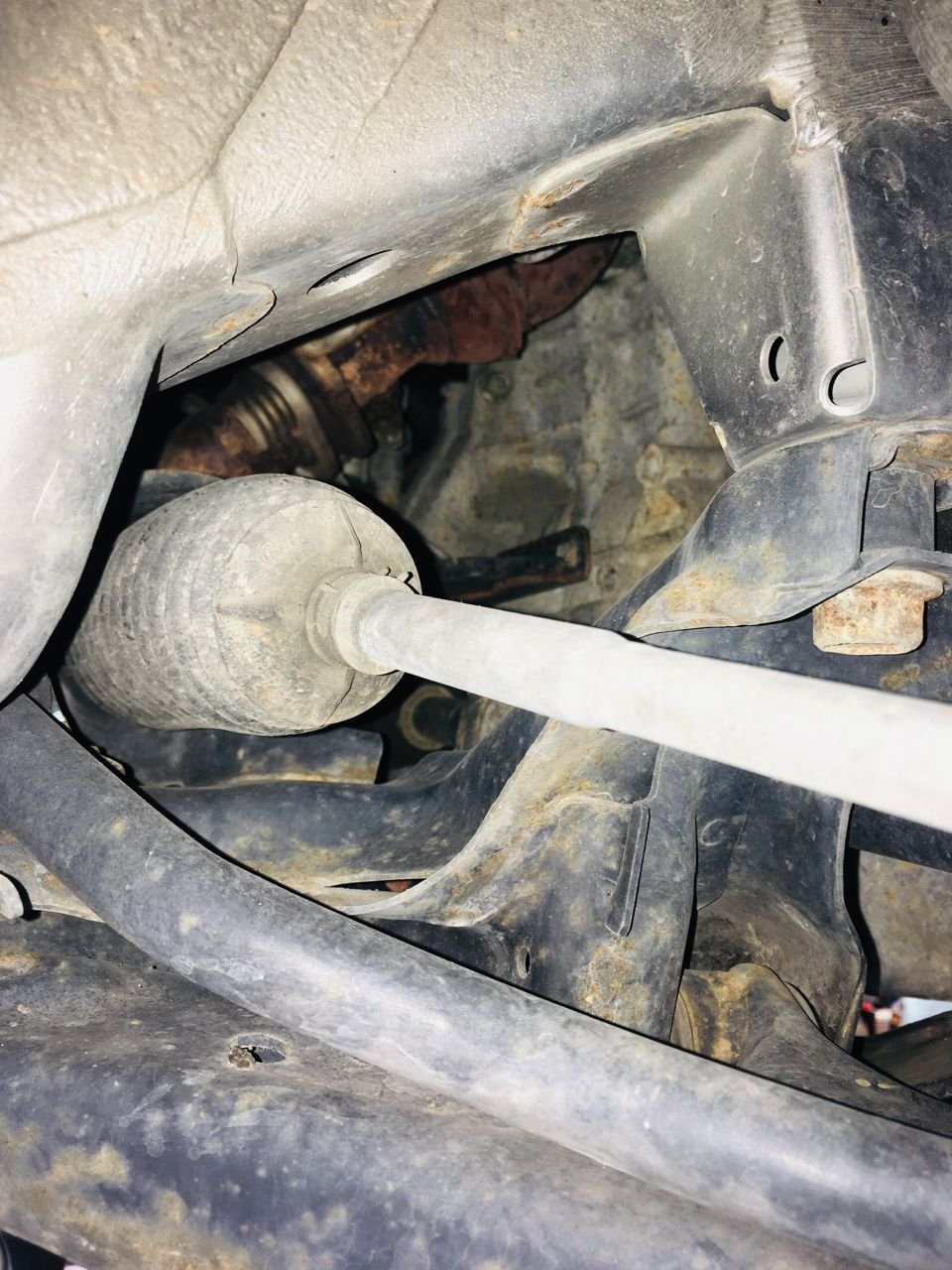

And the photos of the underside of the car, as promised.

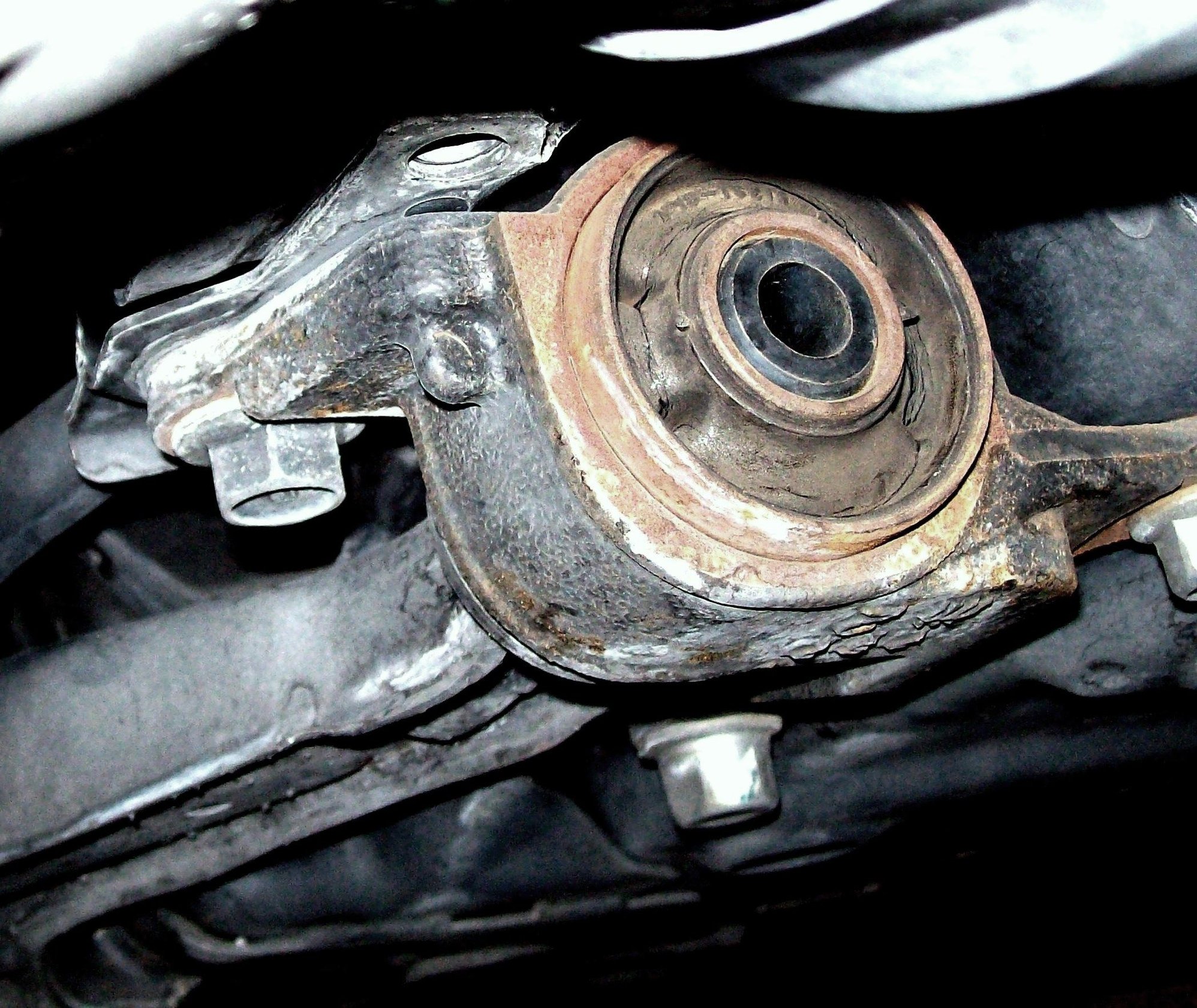

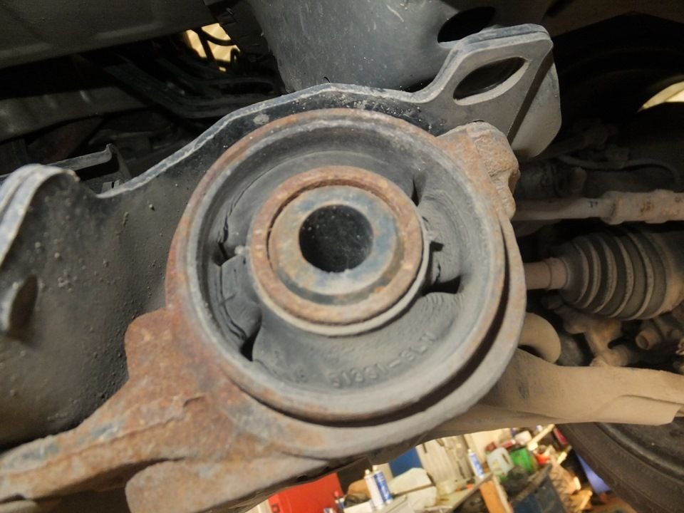

I post pictures of the lower control arm bushing for comparison. Yours are worn more
Control arm bushing on my car at 90K
Another car around 70,000 miles
Control arm [bushings] need an attention (need to correlate with alignment reading or tire wear); I would start with them first
Outer tie rod ends? Sway bar end links
In order to judge the struts need to see a photo of the upper strut mount under hood.

Hey thanks to you both.
Dr J...
Thanks for pointing out the bushing wear. See below.
I believe they are even cheaper on rock auto
Thanks for pointing out the RockAuto prices in a way even I couldn't miss. I'm a RockAuto fan, yet, for some reason missed that they are cheaper than Amazon (money is tight). Was just about to order on Amazon as well. So, thank you.
Finally, I've decided to do the work myself. I don't have a garage or tools (see my other post about moving, canyon roads, etc...). My options are, pay a shop here $250 to do the install (this was a quote I got for utilizing "quick struts") or rent a fully kitted out bay for $30/hour.
I've quit modifying my cars (sigh...), but, if I'm able to take care of things/update worn items while I'm working, I will. So, if I'll be renting that bay and have the car lifted and all the tools at my disposal, I should just get it all done. That said, I've done my fair share of work on my cars, but, I've never replaced bushings or any suspension parts outside of shocks & coil springs. I've been liking
and so far everything feels pretty easy.
Bushings / LCAs / Other parts to replace...
Bushings need to be pressed, right? While the shop does have a hydraulic press (the whole tool list), I'm not sure how long that would take me as I've never worked with a press. Rock Auto has the Moog front end kit for $210, but, is all that necessary?
Open to thoughts on what should be priority, what I should/could try to tackle myself, and what I should let the shop do.

Sway bar end links has to be checked as well (open the door , use it as a lever and rock the car up and down); clunking noise indicates bad link
