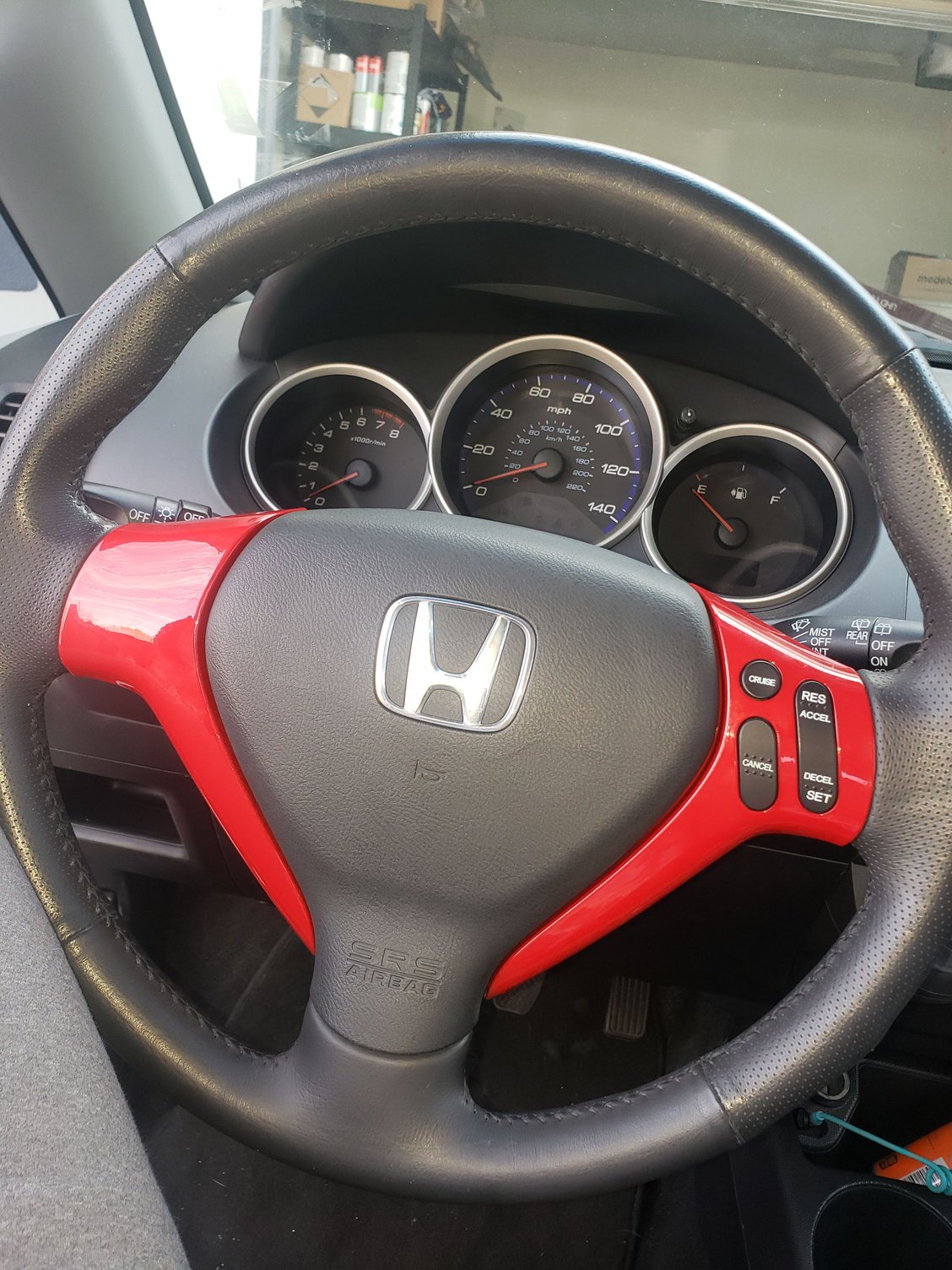

Quick color change to the trim on the steering wheel.
removed trim, scuff and spray. 3 coats of clear.
color match Milano red.
Next is the honda badge on steering wheel.

How do you remove the trim? Held on by clips or some other evil device?
Old Jan 27, 2020 | 09:17 PM
Fabian Blanco's Avatar
Joined: Oct 2019
Posts: 7
From: Mesa
I used this video to guide me in removing it. Plastic cap on bottom back of wheel. Unplug air bag. Torque screws on the side of wheel. Remove the airbag. Remove bolt holding steering wheel on. Remove steering wheel and 4 other screws. Caps come off but then remove back housing from trim. (Small screws) shouldn't take to long, but I stripped my torque screws so I had to drill them out.
