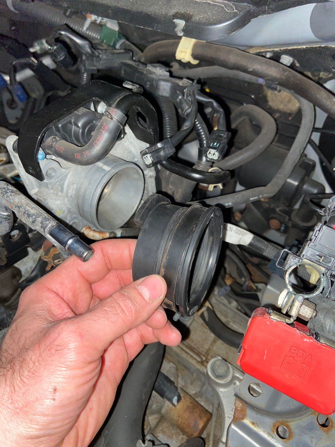

So I began the dismantling of the top parts of the motor. While taking of.f the air box this rubber seal fell off the intake... any idea how it goes back on correctly? Thx

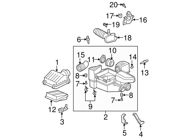

If I recall correctly, the orientation you're holding it in the second picture is the correct one. That extra bit of rubber on the one side ensures you can't put it together wrong. It's part #10 here:

This is exactly what I needed! Thank you. And I just wanted to point out to everybody thank you for all your help! I was able to adjust the valves, I found that the exhaust side were all way too tight, some of the intake needed adjustment but it was really the exhaust valves. It runs the same so I can’t really tell until I fill up the gas tank and check on gas mileage. I just replaced one of the coils so I’m leaving the new one in but I do believe that the valve adjustment was causing the check engine lights to come on, or I should say the lack of the valves being adjusted caused the Check engine lights to come on. This forum is awesome! I’m happy to help anyone who has questions on this project. Definitely a DIY, I bought the feeler gauges on Amazon, I definitely recommend getting the ones that have a bend in it so that you can sneak the gauge easily. Again thanks for the help and I’m all set!

The elongated holes an the rubber part are matching the teeth on the plastic intake, so it only goes one way

perfect, got it, thank you!!
