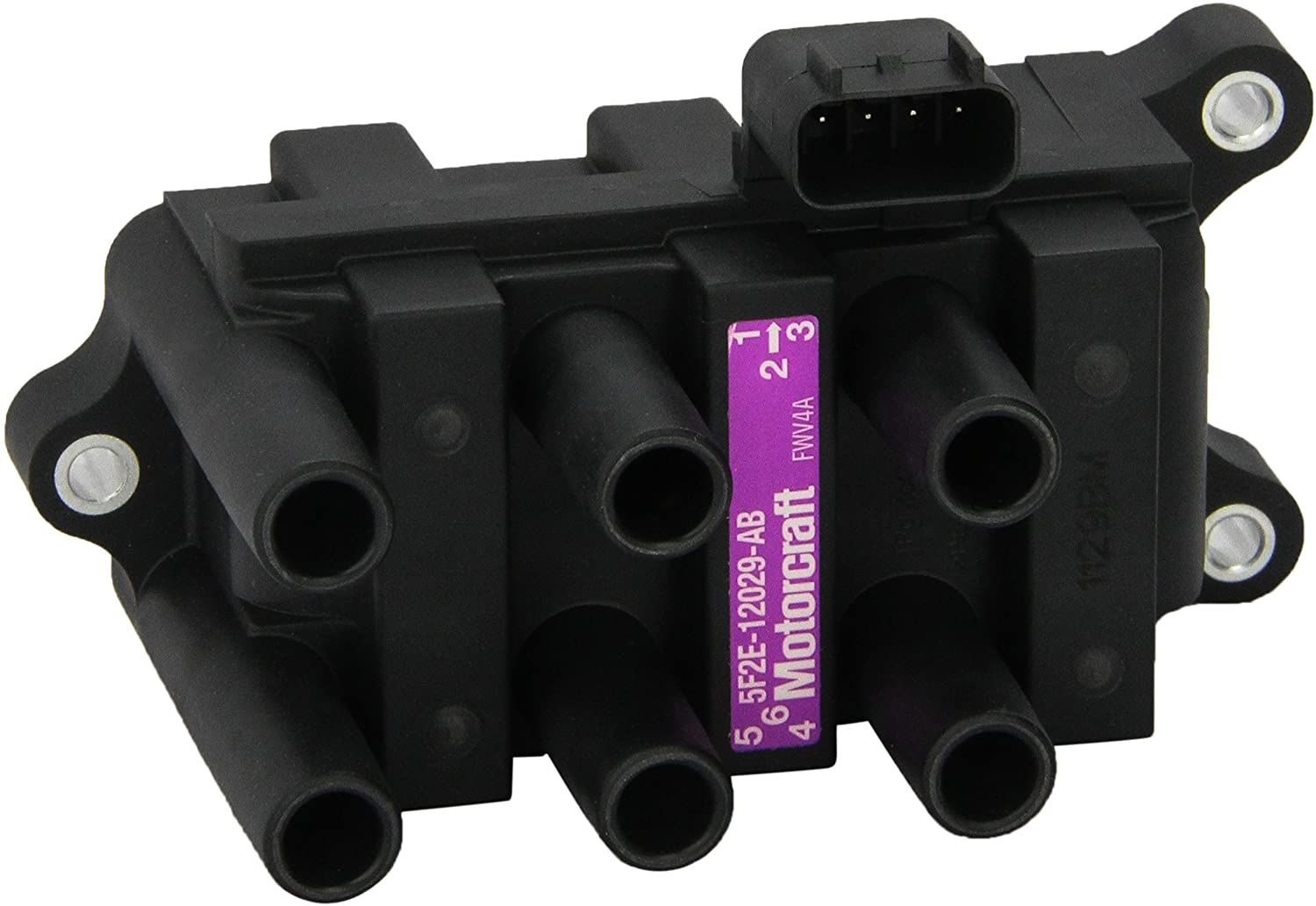

The term coil pack comes from the past when many cars had a single part that provided spark to multiple cylinders. What we have is actually just called an ignition coil and there are 4 of them.
Here's a coil pack for reference -
