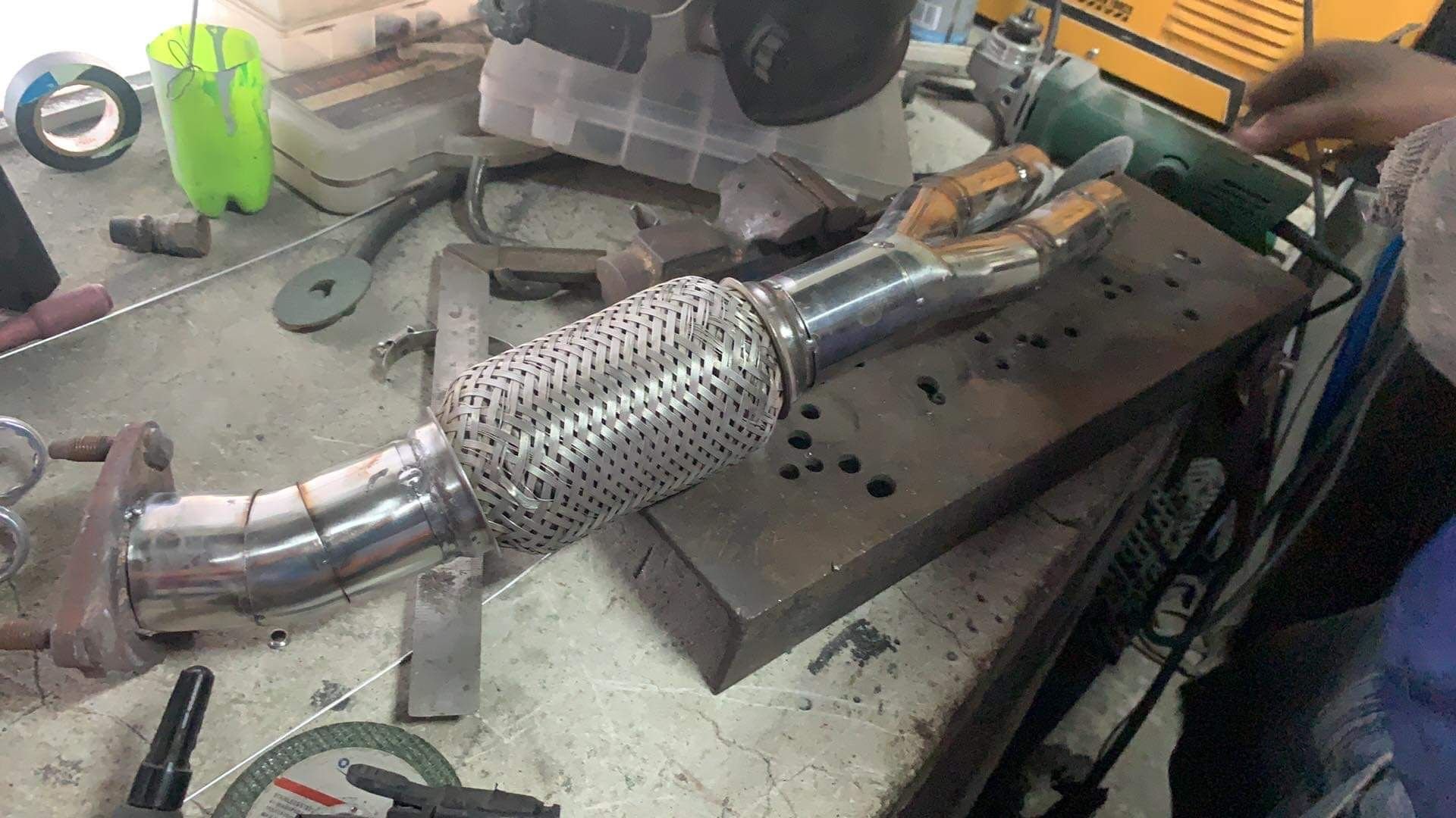

I've already had a custom made header and i've made it smaller than the weapon R race header. 1.5" runners and 2" collector. The fujitsubo power getter sounds way better now after the headers and cat delete. I'll have it tuned in the weekend.

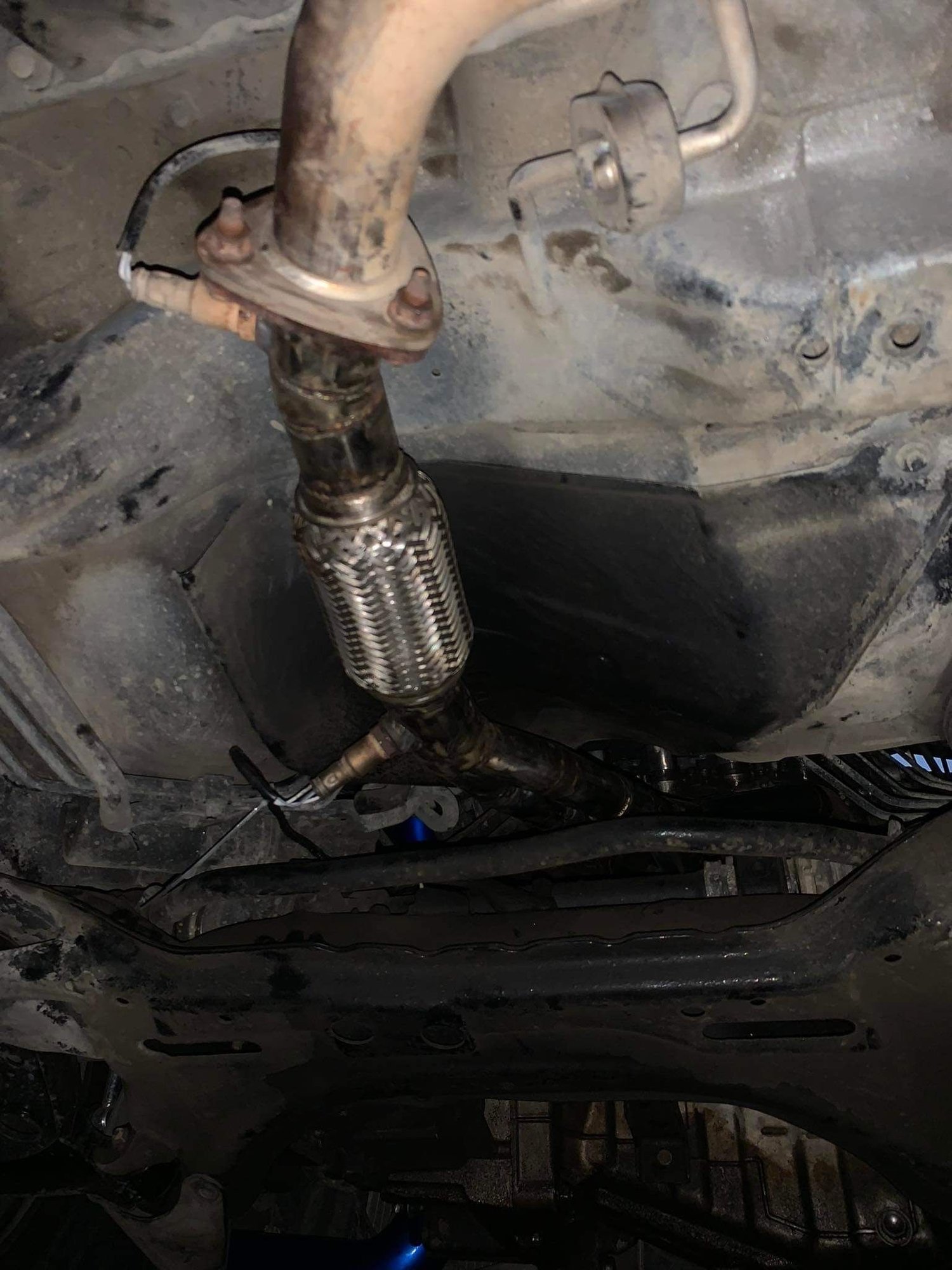

Recycled the O2 bungs from the stock headers/downpipe.

Here are the only pics that I have at the moment.
