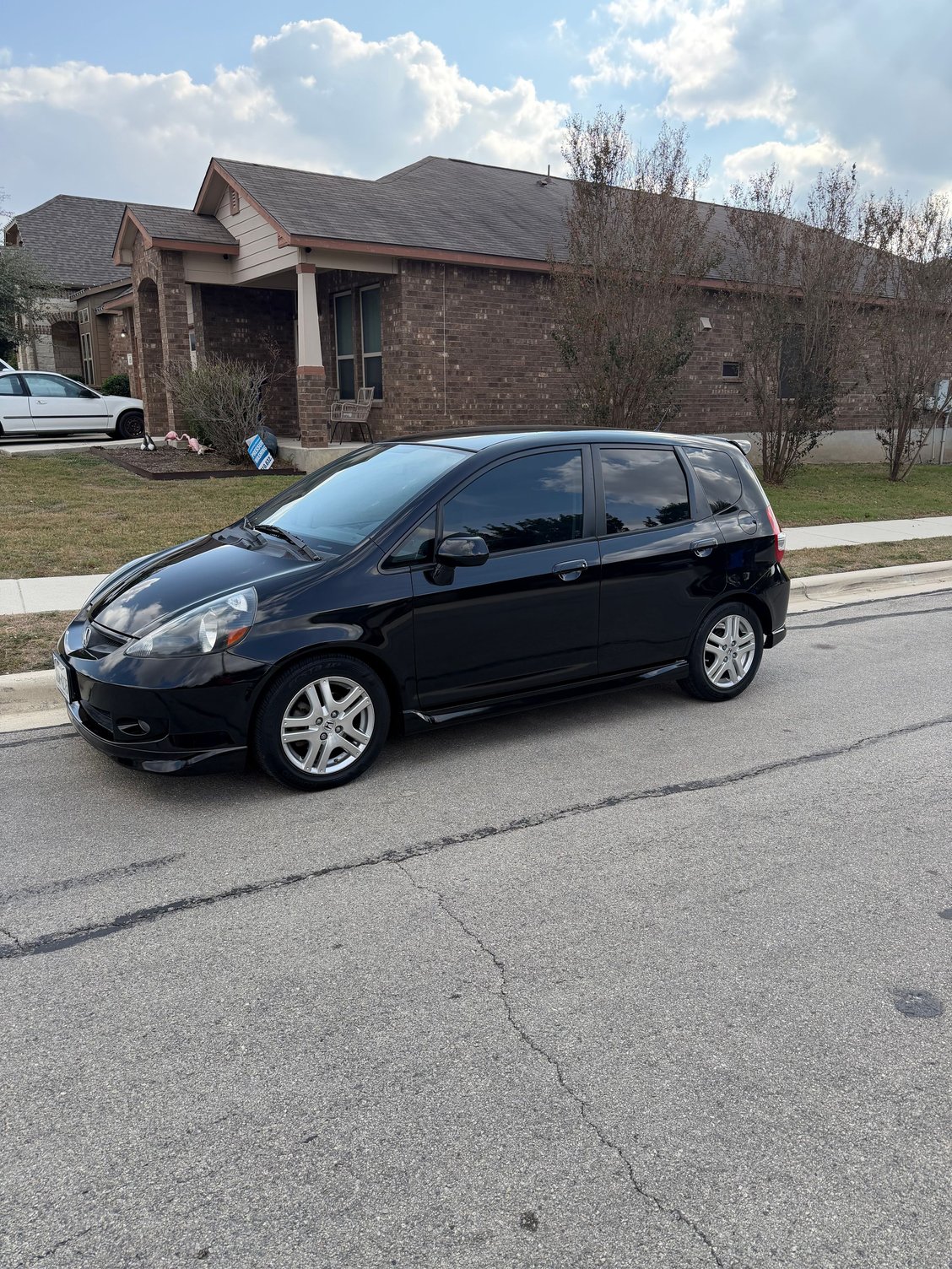

So, here we go!!! 2008 Honda Fit Sport. She’s mint, 35K miles…stock, everything minus carpet is pristine. Southern car, no rust whatsoever anywhere. Paint is amazing for the age too.
Here’s where we’re at so far:
1.)LED replacement lights everywhere
2.) Wilwood 4-Piston brakes this weekend
3.) Stoptech stainless brake lines and drilled/slotted rotors this weekend.
4.) Injen CAI by Thursday, install this weekend.
5.) 15X7 - 4X100 +40 Raceline Matrix next week.
6.) 5% entire rear glass, 30% front done.
7. ) Tein Coilovers by the end of week, prolly won’t get to it this weekend.
8.) New grille, JDM Red H’s front, rear, steering wheel.
9.) BOSS double din with Apple Car Play by end of week.
10.) Reverse light backup camera by end of week.
11.) Cusco Strut, Front & Rear sway bar re-enforcement next week.
Future:
Cusco Front Lower Brace
Nitto Neo Gen 205/50/R15
Injector Flush
Engine Flush
Brake Flush
Transmission Flush
Transmission Filter
NGK Plugs
Coil Pack replacement
Throttle Body replacement
Spoon Mirrors
Spoon Midpipe
Spoon Axle-Back
Did I miss anything? Any input appreciated.
I’m excited!!!

Looks great. Please post more pics!
