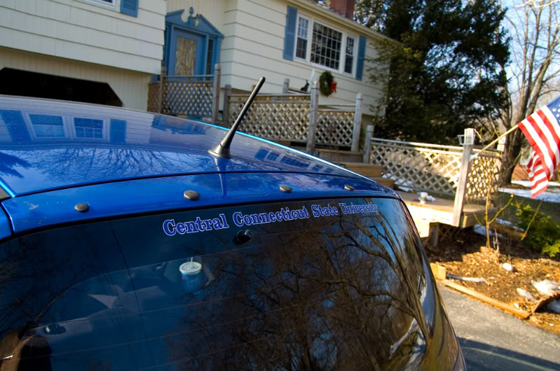

Best picture I have without taking a new one:

Hmm, the last pic is strange, i dont get it! wtf, how do you guys mount the screw underneath wen you cant access them!? lol. I think ill just do what I said drill from the top and drill a bigger hole from underneath to access it..
The three in the middle there is like a retaining clip stock that the bolts lock into to. The two on the outside there is a bolt welded on top of the hole so you just have to pop the cover piece off and tighten stick the bolt through and tighten it.
