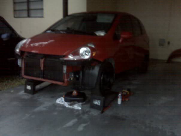

2 weeks without my fit am waiting for the master mind of my dad to come install my clutch its going to be a mission i will update anything on this.

i actually tried doing it myself cause my master mind dad told me some steps but when i went in to do it i was like F@*K this shit its like putting me in a heart surgery room you dont know what to do first so 2 weeks without a fit again. i just wanna ride my fit

Order one today, you should have it before the weekend, and be armed with the answer to just about any question or how-to on your car that exists. www.helminc.com Changing a clutch with no experience and no help is possible - I did it on my Prelude, which with it's ATTS (and much heavier transmission) is a lot trickier car to do the job on.
Oh, and you're gonna have a real tough time pulling the tranny with the car on ramps. Get it up on jackstands, as high as possible to give yourself enough clearance to get the tranny out from underneath. Just make sure it's level when you put tranny fluid back in.
