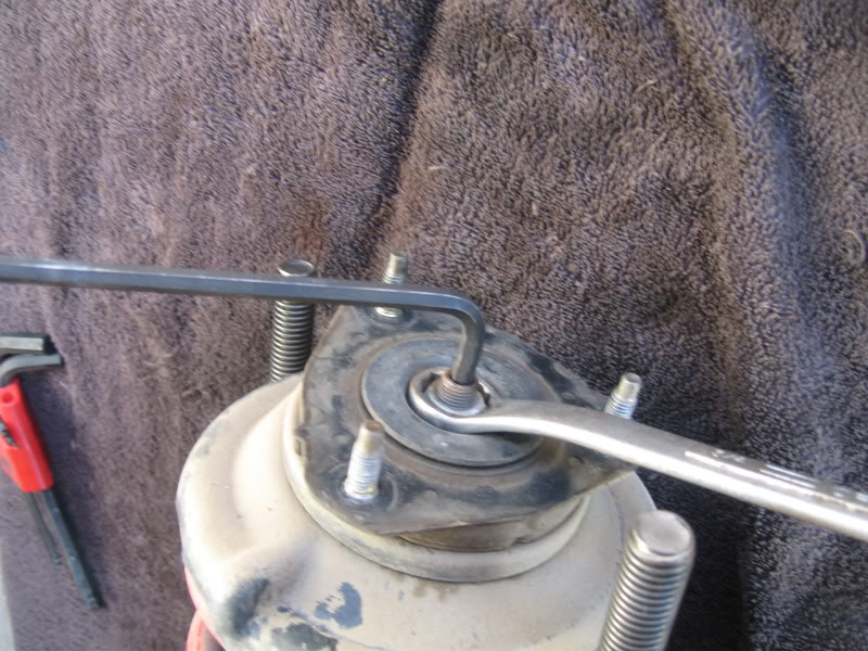

ok when i was trying to drop my car yesterday the right strut nut isn't corroborating, ok when we tryed to take off the nut, the bushing (i think thats what its called) was spinning with the nut so it wasnt going any where we sprayed it with some stuff then we tryed it again no dice!!! then we put a allen wrench on top of the post i guess thats what you call it and still the same thing was happening and then we tryed some other stuff and still no dice so can anybody help me out before i blow up my car!!!!!!!!!!

Maybe some dirt between the strut nut and inside screw. Hold the Allen wrench the other way, opposite of strut nut turn. Can you do the left one?

i think you have to leave the allan key in there i think. thats how note did it yesturday when we were lowering my fit. found this pic on google.. its a focus installation but same idea.
yeah thats how we did it yesterday but its not working

I had the same problem with the whole thing turning despite having the allen key in it. It was so stuck that the allen key actually warped from the force of trying to loosen the nut. Eventually I had to use an impact gun which thankfully took it off - but it revealed the true problem, which was that the nut had crossthreaded itself and got stuck - it wouldn't go back on due to the stripped and messed up threads. Had to go get a thread repairing kit from Sears and eventually I got it working again, but hell, I definitely don't want to go through an experience like that again - I thought I wouldn't be able to drive my car w/o buying a new strut.
Use an impact gun and keep a thread repairing kit on hand. That's about all you can do at this point I'd say. Hours of trying to get the nut off by hand resulted in multiple bent allen keys.

Allen key in one hand, wrench in the other, and push them toward each other.

Change out my front strut twice. Allen key to hold the shaft and a wrench to turn the nut. Maybe you stripped the allen on the shaft which is causing it to spin. In that case, use an impact gun on the nut.

get an impact gun, you can even rent one for the day, for like 20 beans
i bent my allen too, then used the impact and bingo.
