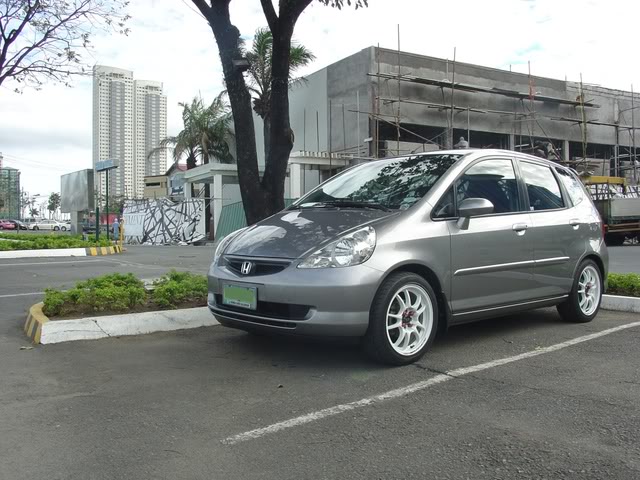

By the way to give you an idea...this is my GD1 on Rota Circuit 10s. The wheels are 16x7, +45 offset. The car is still at stock height.
