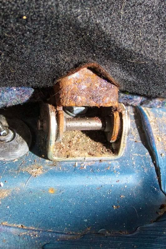

Well its been a few months now. My car was in the shop 3 times for water leaking into the car and a 4th time for them to replace my carpets. I thought I might be in the clear bc its been awhile but yesterday I got in my car and immediately noticed the nasty musty moldy smell my car got previous times I discovered a leak. Started looking and found that behind the seats- right at the seam where the seats fold down was soaking wet on one side. It seems to be coming in from the door panel- possibly in through the roof seam and leakign down..who knows.
So car is being dropped off on Thursday for leak #4!
Good news is I have my deposition in 3 weeks for my lemon lawsuit with Honda. So I guess this only makes my case stronger.
I just want to be able to get rid of the car and not have to pay to get rid of it. Its been nothing but a pain.
The other issues with these leaks along with the nasty mold is its causing the interior of my car to rust.
Here's the side of the car that seems to be getting the brunt of the water leak

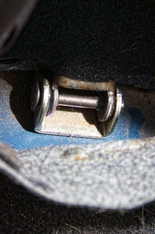

The side thats not getting much of the leak for comparison
