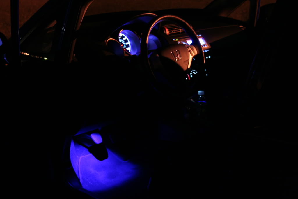

First meeting ran short...
These are actually blue, but the WB was set to auto. I can get more shots of these if you'd like. I purhcased thru AJ-R, but I'm not a fan of their customer service so I would advise going thru japanparts.com, pricing from both is similar.

Oh wow that looks great! So is it an easy install? or is it like a DIY project where you got solder it and put it right in the fusebox?
I'll check out japan parts now thanks man!

Simple as can be, if I recall correctly (threw out the mad jdm instructions last week). You unplug the power mirror switch, then the harness for this plugs into that, and the harness back into the switch, then there is a power that goes into the fusebox. No soldering required, just plug it in and cut holes where you want to mount the led's.
