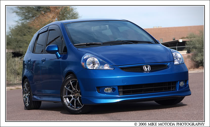

you can't really tell in the pic posted above because of the lighting (the sun shines directly into the gap between the bumper and hood), but the hood doesn't sit flush with the front bumper on the 07-08 fits.
the hood will line up with the fenders. you'll still be able to see the rubber stripping between the bumper and hood when the hood's securely closed. from your description, your hood is normal, but please post a few pictures and that will help

here's a pic of someone's fit Name:  20081213_fit_00.jpg
from here https://www.fitfreak.net/forums/fit-...t-t1r-etc.html

That's what my bumper looks like and I haven't had anything done to the from of the car. I always noticed that there was kind of a large gap between the hood and bumper, but that's just how it was manufactured I guess.
