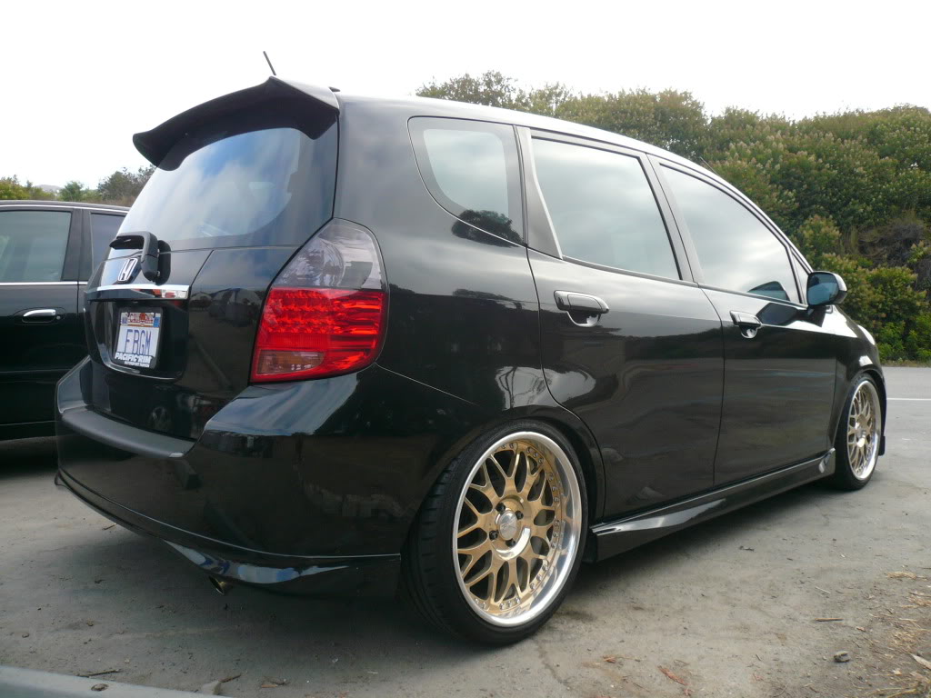

i had to go with 195/40-17, cut and roll my fenders, and camber the rear to get them to stop rubbing.
