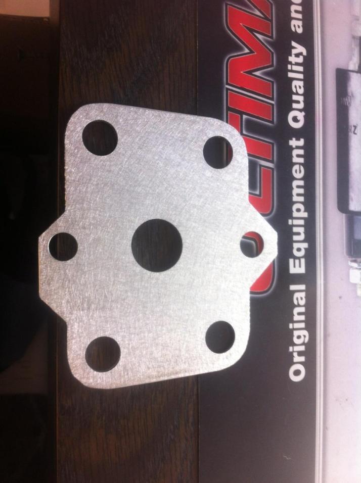

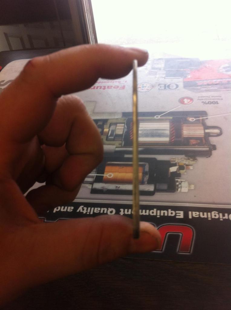

I have 225/45R 15's on 15x8 +25 at near stock ride height in the rear with HEAVILY rolled rear fenders . It still rubs.
Only solution for me it so add camber, so I had a custom set of shims machined to go onto the stub axle:
With these I should have around -3.0 degree's of camber and should be able to clear.
Since your at an even lower offset, and I am guessing much lower than stock you may have to make some significant modifications... What size tire are you trying to fit? Can you go "smaller?" Start by adding camber, and if that does not work try trimming the plastic bumper and then cutting and relocating the bumper tab is where I would go next.
