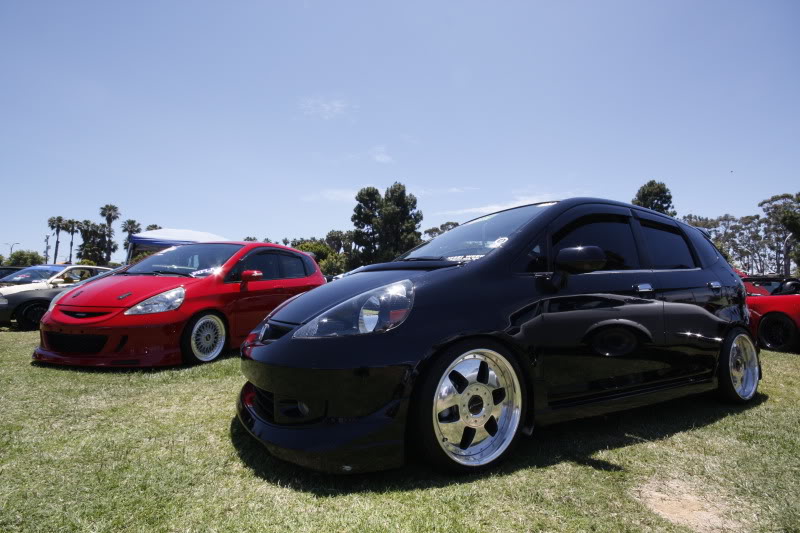

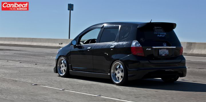

Old Aug 24, 2011 | 03:53 PM
Fit4Trav's Avatar
Posts: 3,860
From: Chino, Ca
17x7.5 17x8, Rear fenders rolled, lowered on HKS coilovers, 195/45/17 Yokohama S Drives

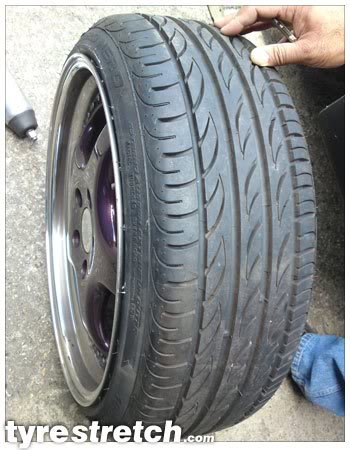

[quote=mahout;1028431]Which brings another observation; do you know how silly a 195 section tire, thats 7.67", will look on a 8.25" wide rim? quote]
I think it will look like the pictures the OP showed illustrating the look he was trying to achieve.
Here's a 195/40 on a 17x8.5:
Just trying to help him reach his goals.....

[quote=MarkyMark;1028493]
Precisely. See a gap between rim flange and tire bead? Helping someone reach undesireable, even unsafe, goals is not admirible.
