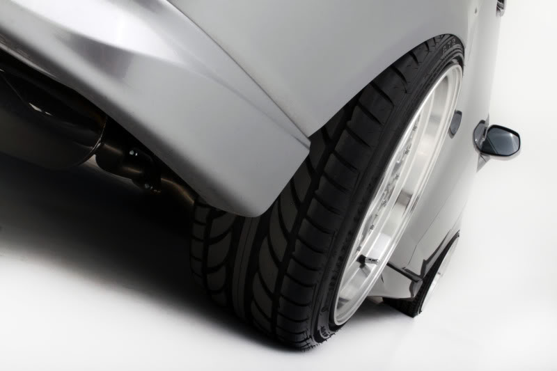

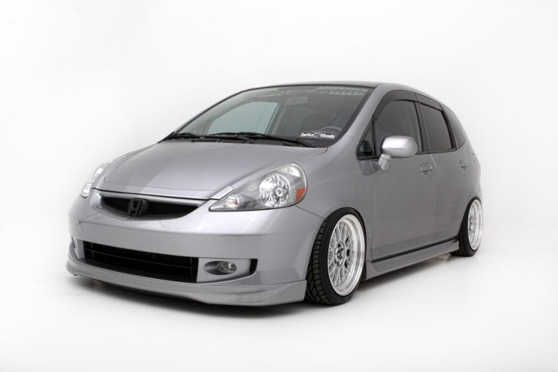

To get the look you're after, you might want to consider 16x8 +20, as opposed to 16x7.5
That's the size I'm running with 195/45R16.
