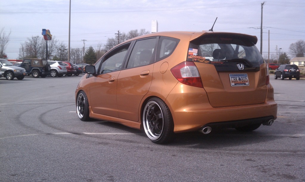

Originally Posted by lowkeymods
I'd worry more about the 8" part than the offset. 7" + anthing below 35 is gonna look, well....
Not so my friend:
17x7.5 et 32 all around:
Front's had a *tiny* bit of poke.
17x7.5 et 35f, 17x8.5 et48r w/8mm spacer:
I think 17x8.5 et48 all around with a 10mm spacer in the rear, on 205/40-17 Falken Ziex ZE512 is pretty much perfect for the GE8. So that's what my setup will be by September.
