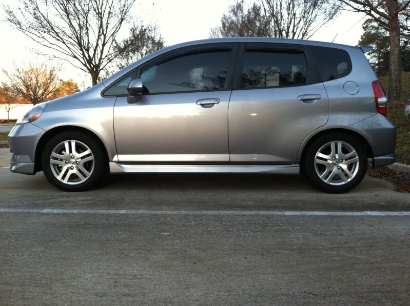

When I bought my 2008 Fit Sport almost 2 weeks ago, I posted a photo of it in the Introduction/Newbie thread. Someone replied with a comment about the rear springs looked like they might be sagging (and recommended some Swift springs). I thought it might have been the angle of the photo, but I started paying attention to other photos of Fit's on here. Some look higher than mine in the back, and some don't. Being a new Fit owner, I'm still unfamiliar with what looks right and what doesn't. So I thought I would pose the question in this section.
Here's a side shot of my car:

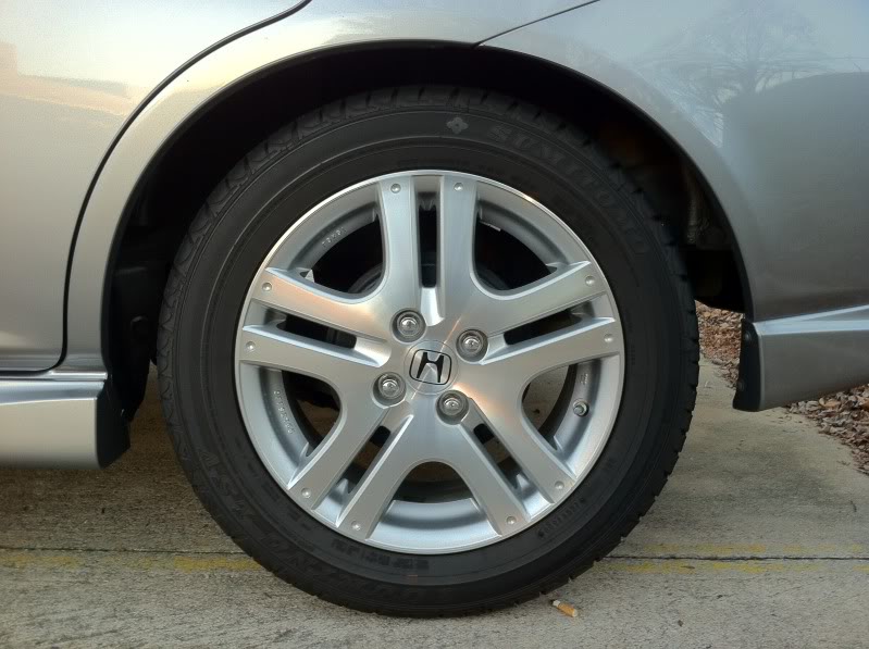

Here's a close-up shot of one of the rear wheels:

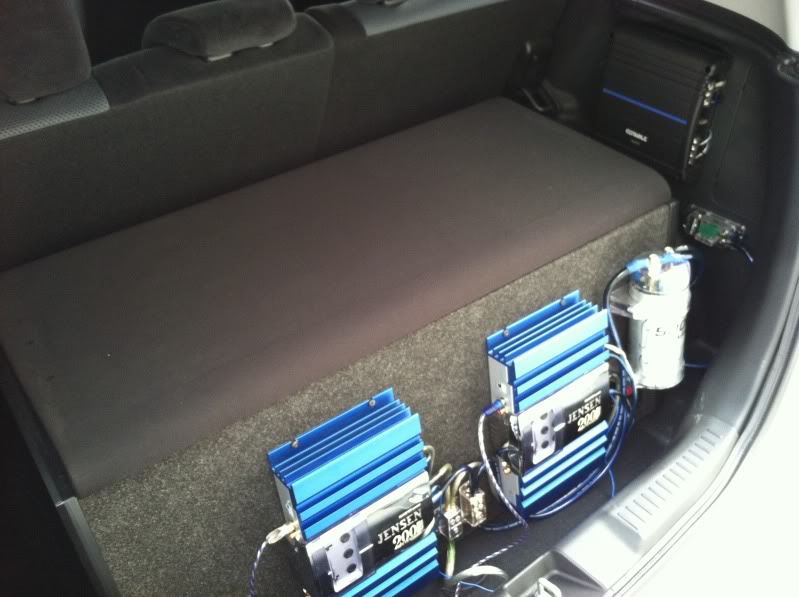

In response to the sagging spring comment in the other section, I commented that this car came with a big speaker box with two 12's, three amps and a capacitor in the cargo area, and perhaps that had something to do with it looking low in the back:
I plan on taking out the big honkin' box and one of those Jensen amps (and possibly the capacitor, too) and installing a (much) smaller JL Audio single 10" box, so that will help with the weight back there. I'll also have some cargo area, which will be nice.
But back to the original topic...does it appear that my rear springs are sagging, or is it just the weight of the audio stuff in the cargo area?
Thanks!

Definitely the extra 100lbs of audio in the rear. Bet that thing sounds like a monster with all that boom behind the hatch.
Old Nov 21, 2011 | 06:02 AM
doctordoom's Avatar
Supervillain
Posts: 4,261
Yup it's the audio
Old Nov 22, 2011 | 02:52 AM
mhmmmatthew's Avatar
Posts: 161
From: Lawndale, CA
Yup definitely the weight. When I was on stock springs and had passengers in the back or something in the trunk that was heavy, the read was noticeably lower. Stock springs are bad...

So, I removed that big speaker box, replaced it with a smaller 10" subwoofer and enclosure and ditched one of the amps.
I think there's a difference, but it's very, very slight.

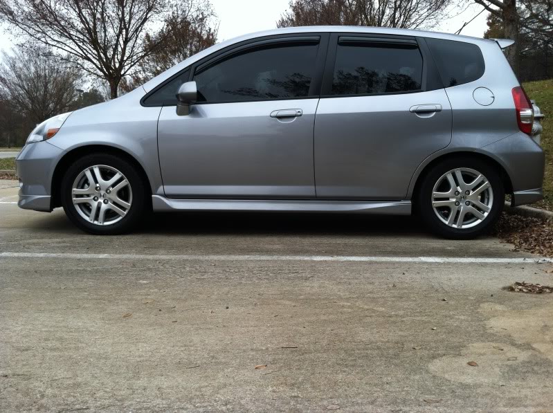

Before:
After:

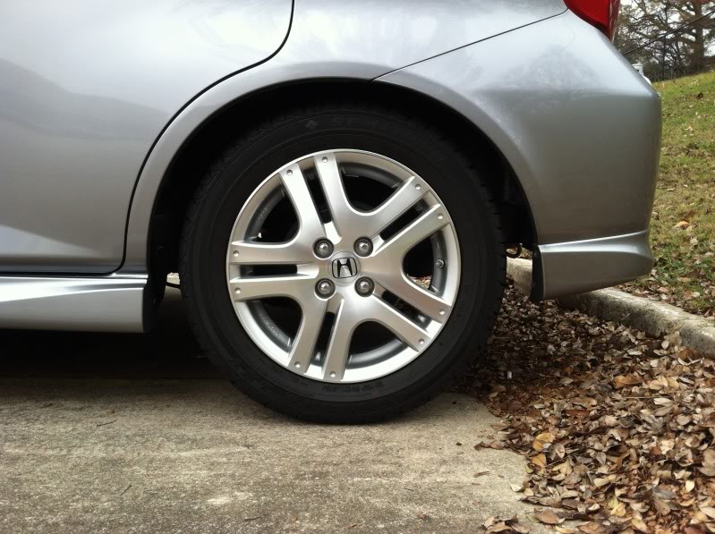

Before:
After:
It's kind of tough to tell. The lighting is different in both shots. But the speaker box that I took out did weigh a lot. I'm sure it made some sort of difference, but it's not as drastic as I thought it might be.
