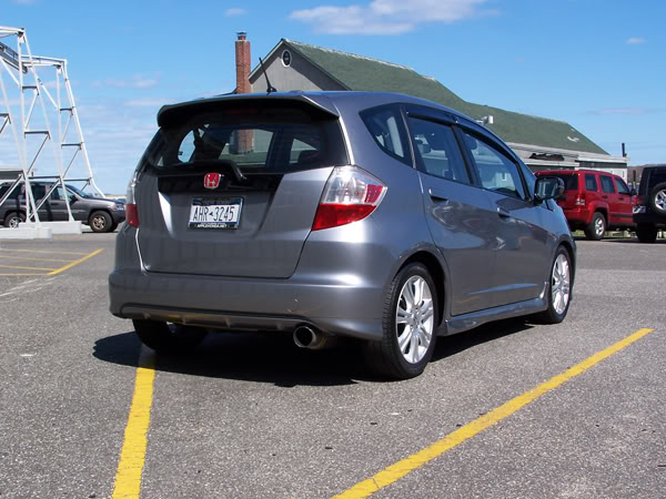

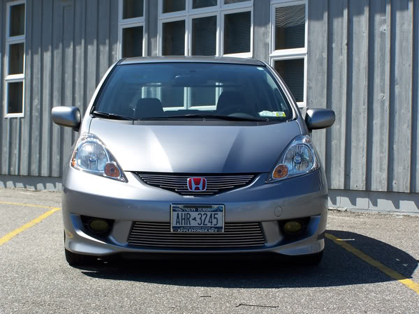

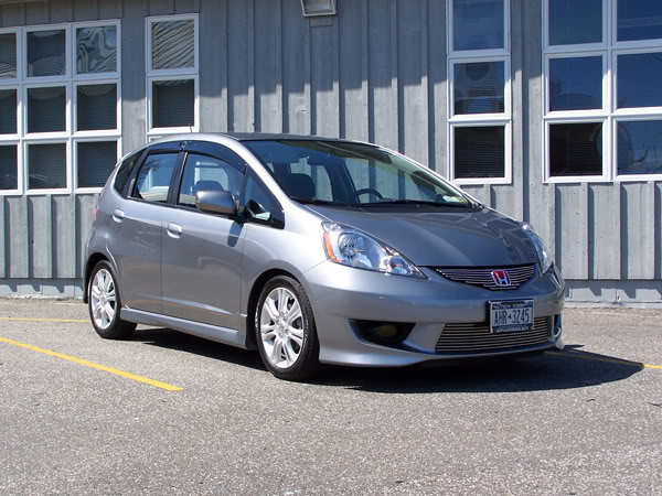

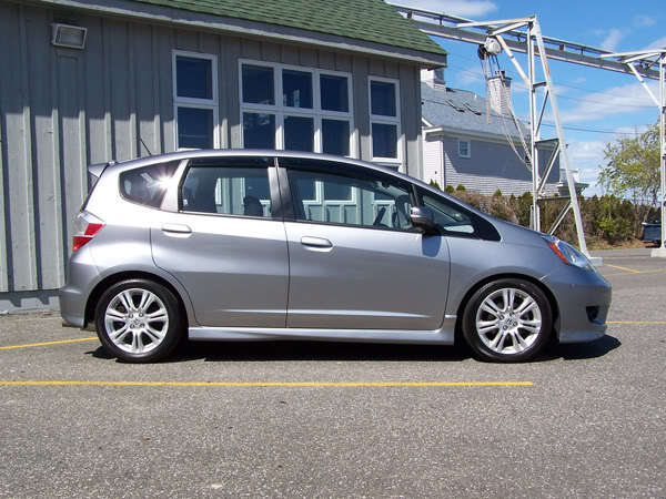

I posted these pics in the https://www.fitfreak.net/forums/2nd-generation-ge-08-present/42027-ge8-lowered-thread-post-your-pics-21.html thread.

The springs arrived in fine condition but they were labeled backwards. It took me a little time to realize this and almost reinstalled the original spring before trying the spring labeled "R" on the front . After that it was smooth sailing. You need to cut down the bump stops which I did with a box cutter (there is a very good DIY on this install). I like the look but do wish the rear would drop a little more. It has a more front down aggressive look to it the way it stands and could afford to drop at least another 1/2" in the rear to be perfect. Maybe it's just me. As for the ride, it is a little rougher especially on roads that are under contruction (NY is always rebuilding) but little noticable on smooth pavement. I am very happy with the improved handling. The springs are a bit stiffer and have less body roll. I'm waiting for a rear sway bar and I'm assuming this will only add to my enjoyment. New rims and tires would probably double it.
To answer your question... I see no reason to fear these springs for the money. The best thing that you can do is install Coil overs but you are here like I looking for a cheaper alternative. My one concern is how long will the stock shocks hold up. For the price, little install time and effort = no brainer.

^^^Awesome! thanks!

Yes thank you for posting that made making my decision easier.
