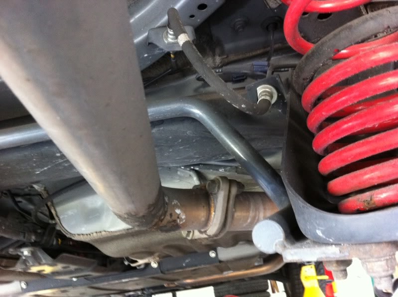

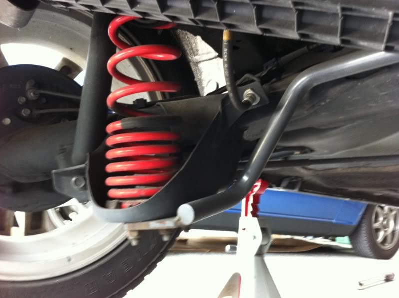

Jodele - I purchased my Fit used and I am unsure if I have an aftermarket swaybar or not - can you tell in these pics?

That's a progress rear swaybar

^^X2
yup...it looks just like mine.

looks like mine but i upgraded my hardware
