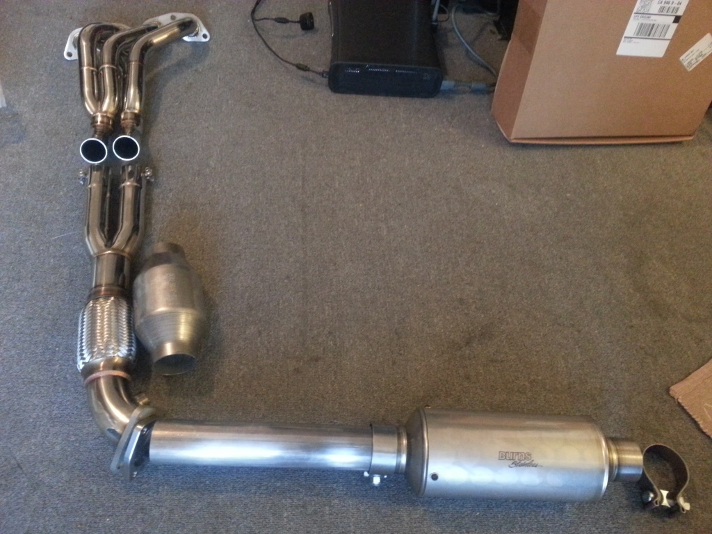

As far as exhaust, we can change ANYTHING after the exhaust ports in the head, AS LONG AS we retain a "high flow cat" within 6" down stream of the OE cats end point... This has caused me NO END of headache to figure out . I'm going to end up usig the Weapon R Race header (cat delete) with a VERY customized Megan 2.25" B pipe and a clamp on Burns Stainless 17" 2.5 pound muffler... Should be FUN Might even register on the sound meter at events now

This is most of the exhaust bits:

that exhaust is gonna be ridiculous.

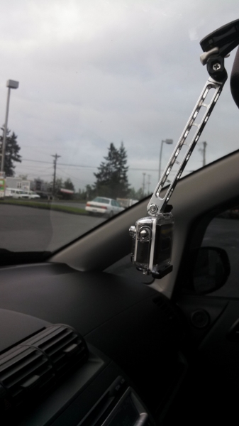

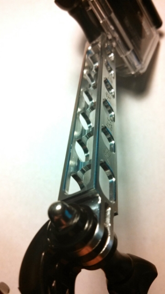

thanks man i just got my hero3 last week. ive been promising my buddy to make him some arms for awhile now. im machining the v2 versions tonight. the first ones could have fit alot better so we made some tweaks and should be pretty good now. ill make you a pair if you would like. the goal is a full aluminum arm set with 6, 12, 16 inch extension arms, 90 degree arms and some random mounts. think of it as the extreme gopro mounting kit lol. cool thing is my 6" arm weighs as much as the 3 arms that come with it and those are only about 4" lol
just so everyone knows what we are talking about

version 2 photo on my facebook page

Arms look great. Gotta let us know where to send that money now

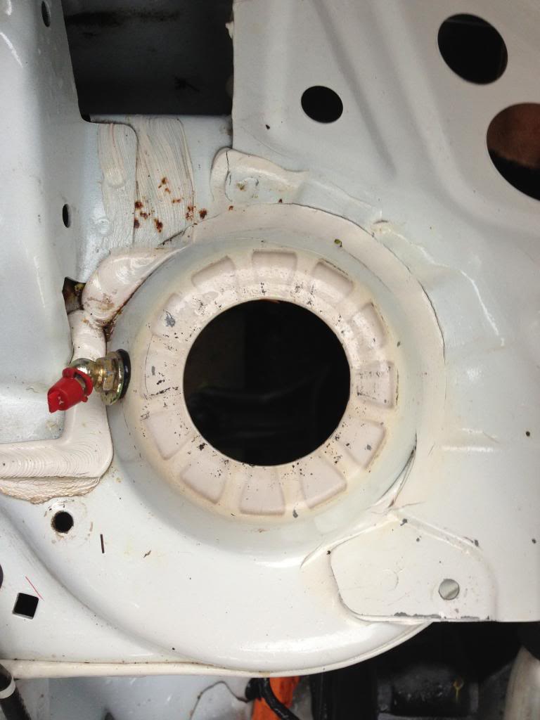

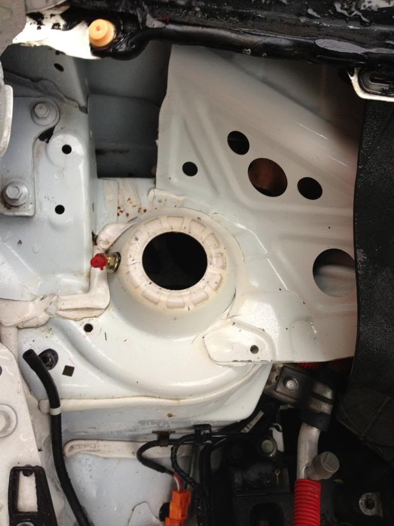

We should be able to use OEM upper spring seat as camber plate platform. You know add ears and such to simply accommodate mounting points to car where the strut bars mount. Or just go balls-to-the-wall and make an entire one piece strut bar/camber plate combo.

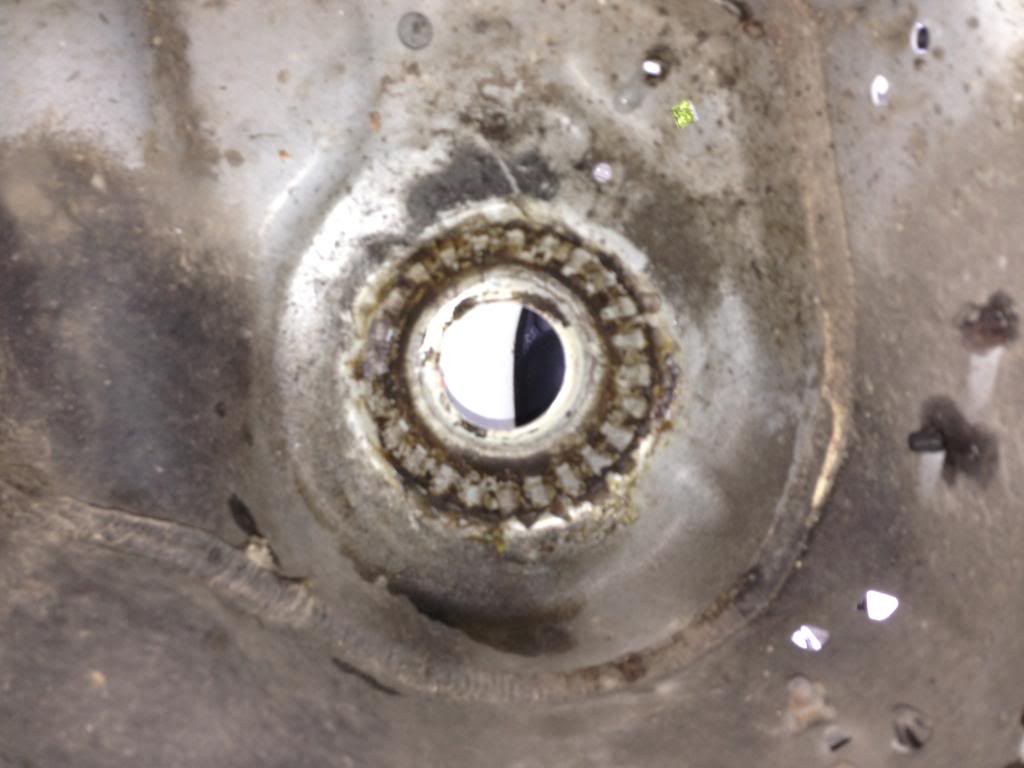

here is a clean view of the upper mount area under the hood.
From below
I do not like the focused stress of coilover upper mounts with reduced diameters. Behold...
the stress on the seam from 10 O'clock to 3 O'clock. Definitely something to consider and be aware of.

whats with the grease fitting(if thats what it is)??

Our upper mounts suck. Popped them in a while back when the suspension was stock. Eliminated low speed turning noise. I installed fittings on all ball joints too. Not the lower one.... endlinks and tierod ends. In my mind if it moves; it needs grease...period. What it is made of, does, and is exposed too determines the grease. I remember a time when fittings came on everything.
I'm rattling through shelves of parts and tools now. Have to straighten everything up so I can start fresh in my shop again, but I'll have some pics of the spring seats I speak of as well.
